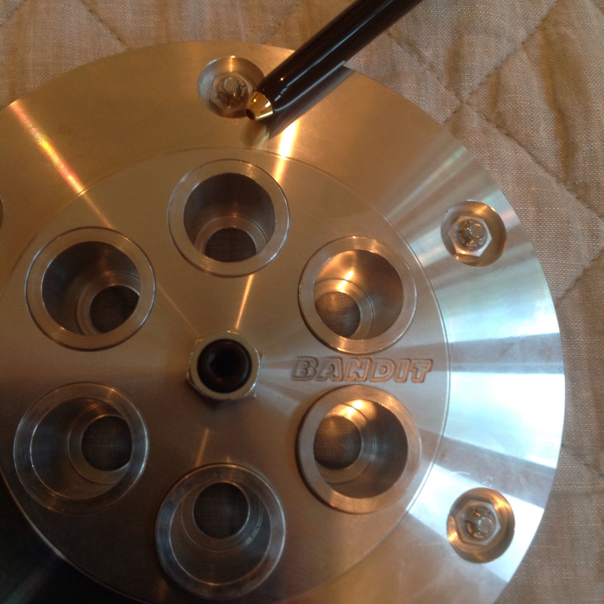

Yea I'd like to see where the "BANDIT" writing lines up when the dots are aligned properly, maybe I got lucky

Unwrapped my Bandit clutch this morning, identical to monster's - one "o" on the hub and one "o" on the pressure plate.

Did you get a chance to look at where the bandit writing lined up when those 2 marks were in time?
No, but I can on Wednesday morning! Getting excited to install it, have an Evo basket heading my way!

OK monster, if the Bandit Logo is level(3 o'clock position), the "o" index will be at the 12 o'clock position, centered underneath that fastener that my pen is next to:
