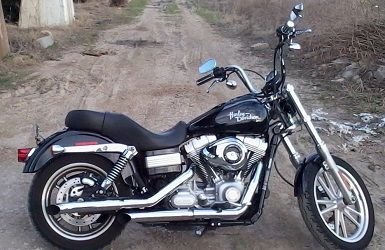

So...finally got a bit of hometime (OTR truck driver) and got the bike out of storage. After standing it back up and finding a broken clutch lever and scratched tank and front fender I took it for inspection and new tags. Passed inspection, replaced levers myself, and used 1/4 tank of fuel in less than 30 miles. Called dealer and found I can replace temp sensor and both o2 sensors for less than they charge to diagnose the issue, so I ordered the temp sensor thinking that was most likely to cause the problem. Any body else have a mileage issue after extended storage? Just trying to see if I'm on the right track.

Bike is 2009 FXD - stock except for cycle shack slip ons
has 26000 miles on it
Just ran a full tank of gas through it w/cleaner, only 110 miles - used to be 200+ before fuel light would come on.
Temp sensor came in today, so I will try that and see what happens. At less than $40.00 its worth a shot.

My understanding is that engine temp, throttle position, and vehicle speed are what the computer uses to control the fuel injection. It then uses the o2 sensors to fine tune the mixture. Engine temp sensor did the trick. Just put 25 miles on it and the fuel level barely moved. (and I looked in the tank. I learned about these gauges years ago). Don't know why it went bad while sitting still though...
