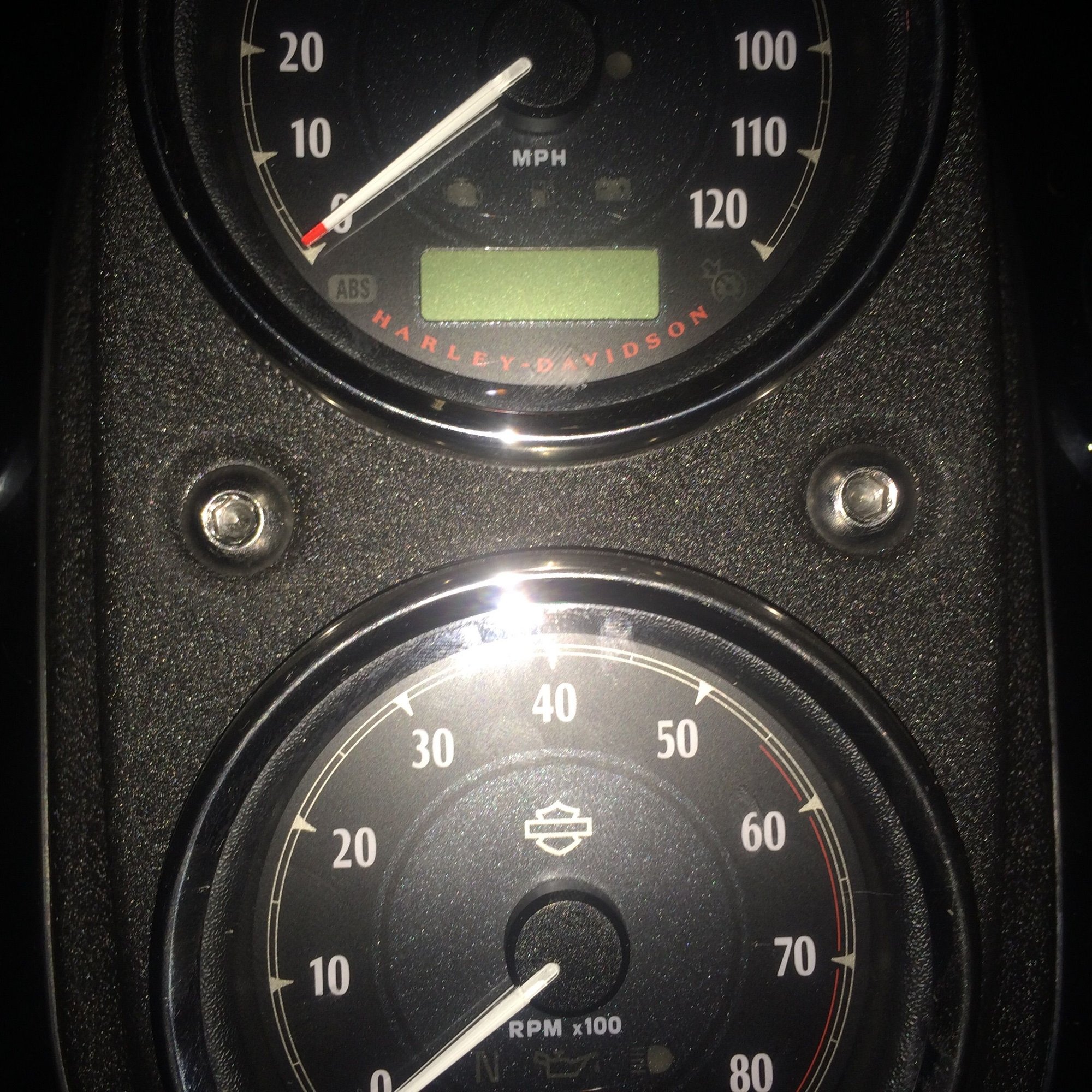

The dash in my '15 fxdl has been off since new. I keep trying to line it up but either screw arent centered in the recesses or if i get one screw centered the other is off and the dash is way off. Its not a big deal but bugs the hell outbof me when riding. Anybody else had a problem with this or a fix? The pic is the best i can i get it.

I can't really tell what you mean from that picture.

Those screws go through the dash and into speed nuts that are mounted on arms that can flex. Take the dash off and bend (tweak) those arms till the holes are centered over the speed nuts.
