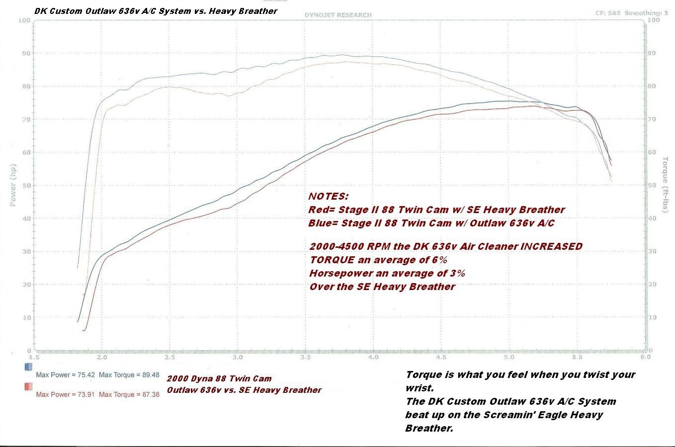

Dk customs has some great performing and great priced air cleaners. I have the 636 and love it.

What kind of performance increases did you notice? I would like to squeeze as much out of the bike before I start looking to upgrade internal engine parts.
