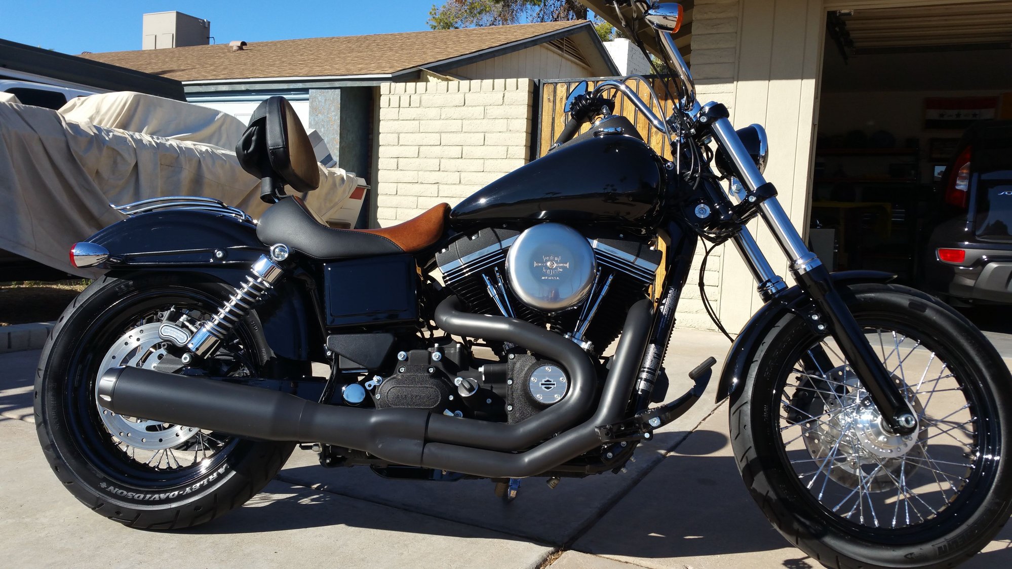

Hi everyone
I'm hoping someone here can help shed some light on a problem I'm having.
I have a 2015 FXDB w/FP3, Bassani Road Rage 2, and VO2 air cleaner.
After installing the RR2, and calling V&H (selecting Pro Pipe per instructions) my gas mileage went from about 200 miles per tank to about 100! It had a very rough idle and just never really seemed to smooth out. I tried Autotune, but it never seemed to fix anything other than the decel popping (rode it to work and back...108 miles, including freeway and city).
V&H techs says the O2 bungs don't go all the way in the pipe to get a proper reading due to the adapters used by Bassani and to disconnect them (unplug the sensoes, after selecting The Pro -Pipe, competition series).
This causes the check engine light to come on and not go away (even after clearing it from the app and having a V&H tech upload a new "map" to supposedly fix it. It didnt. They then said to just drive it like that or get an XIED. ??? Another $100? No clue,as to what an XIED is but I'm not liking the last 3 letters....
Some shops around here (Phoenix) say they have never heard of such a fix (to disconnect O2 sensors)and that the FP3 should fix it, I've spoken to 3 HD dealerships and 3 indi shops.
I called Bassani and they laughed. The tech I spoke with V&H is the competition and disconnecting the O2 sensors is hogwash. They said they DO NOT recommend the FP3 with their pipes....to either just get a base dynotune, or use a Power Commander (although they REALLY recommend Thundermax).
What the hell? Anyone else have similar issues? Any advice. My bike is my life (and my daily commuter). I don't really care about the gas mileage as I realize that economy suffers for performance...however, I think it should run a bit more smooth than it does.
Thanks for your advice.
Mace
2015 FXDB with FP3, Bassani Road Rage 2, V&H VO2 intake, Saddlemen Renegade seat.
