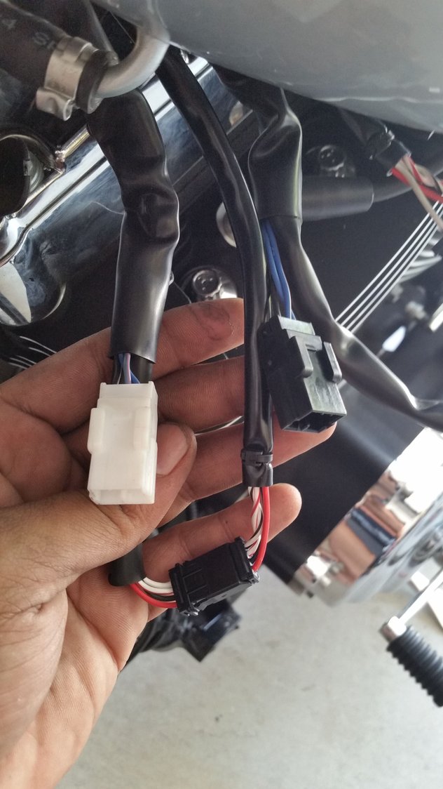

Hi all, I need help regarding the wiring of the front turn signals.
Is there any way to disconnect these wires to relocate to the fork? I have tried searching, youtube, etc... and can't find an answer.
Also bonus! what is this plug for on the wiring harness?

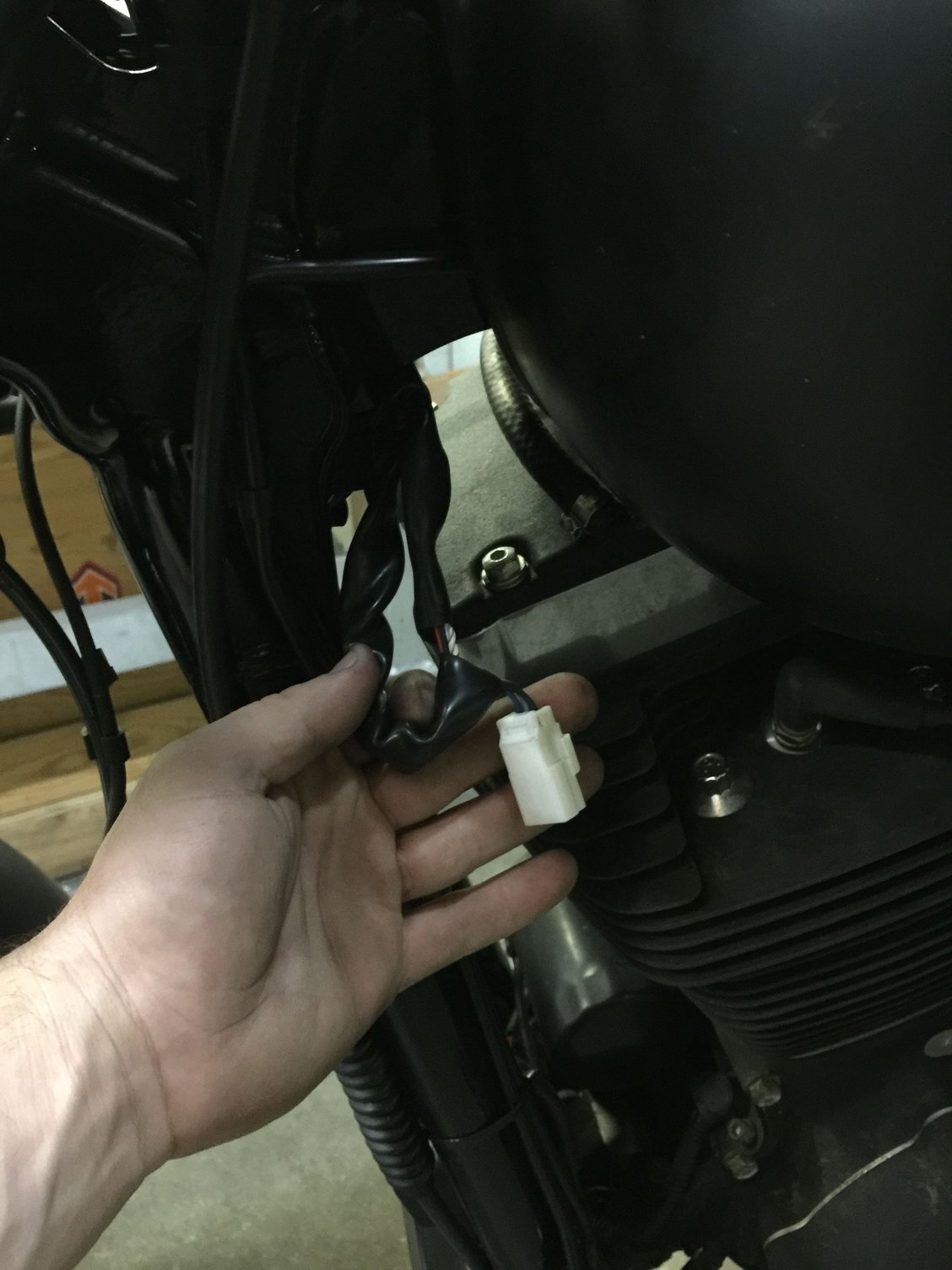

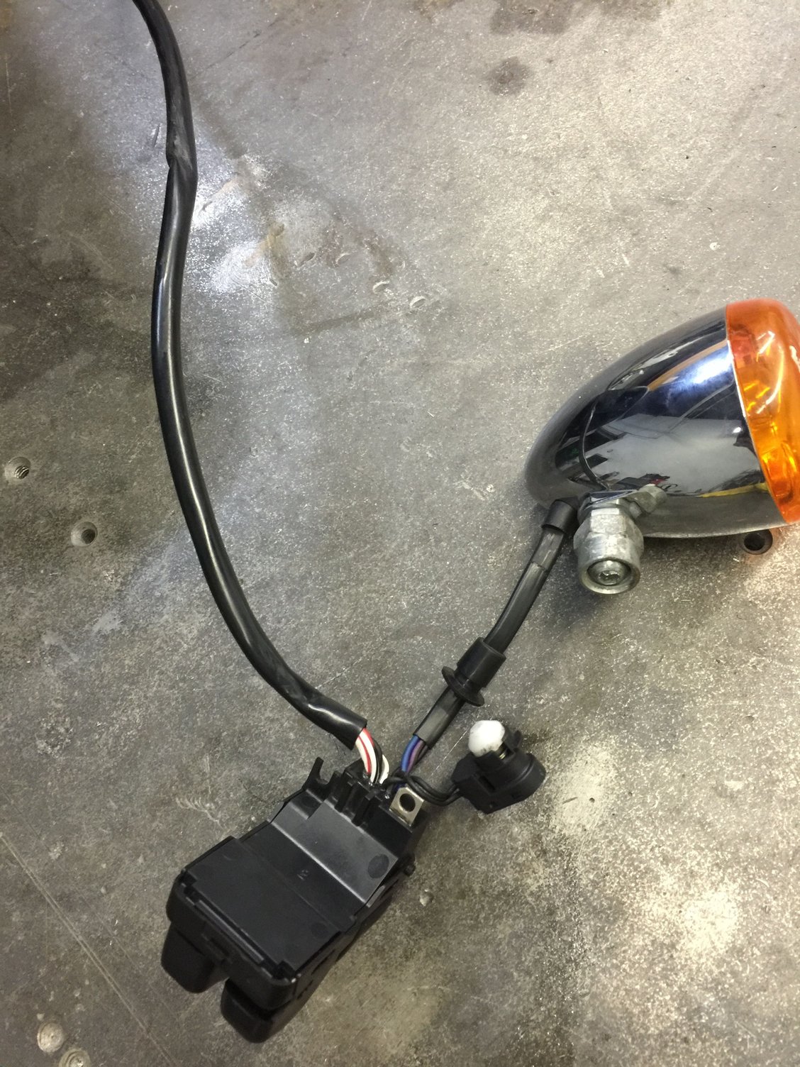

no, you have to cut them and re-solder them then plug them into the blak and white plugs that are inside the frame. Cut those wires at the switch housing. Stagger your cuts, then seperate each wire, there are three. Heat shrink them and stuff them back into the switch housing. The idea is to isolate each wire to prevent shorting. Once that is done, get yourself the pins and connectors that fit the plugs that are inside the frame. you can get them from harley for a whopping 4 dollars. connect the wires to the pins, connect the pins to the connectors, run the wires into the frame and connect to the plugs, they look like this. easy peasy

I should say, cut the wires at the switch housing that go to the turn signal. The longer wires that run through the bars must stay connected, dont cut those, only the wires to the actual turn signal.
