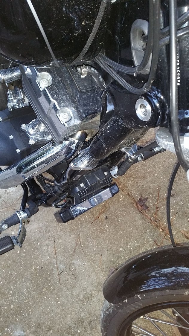

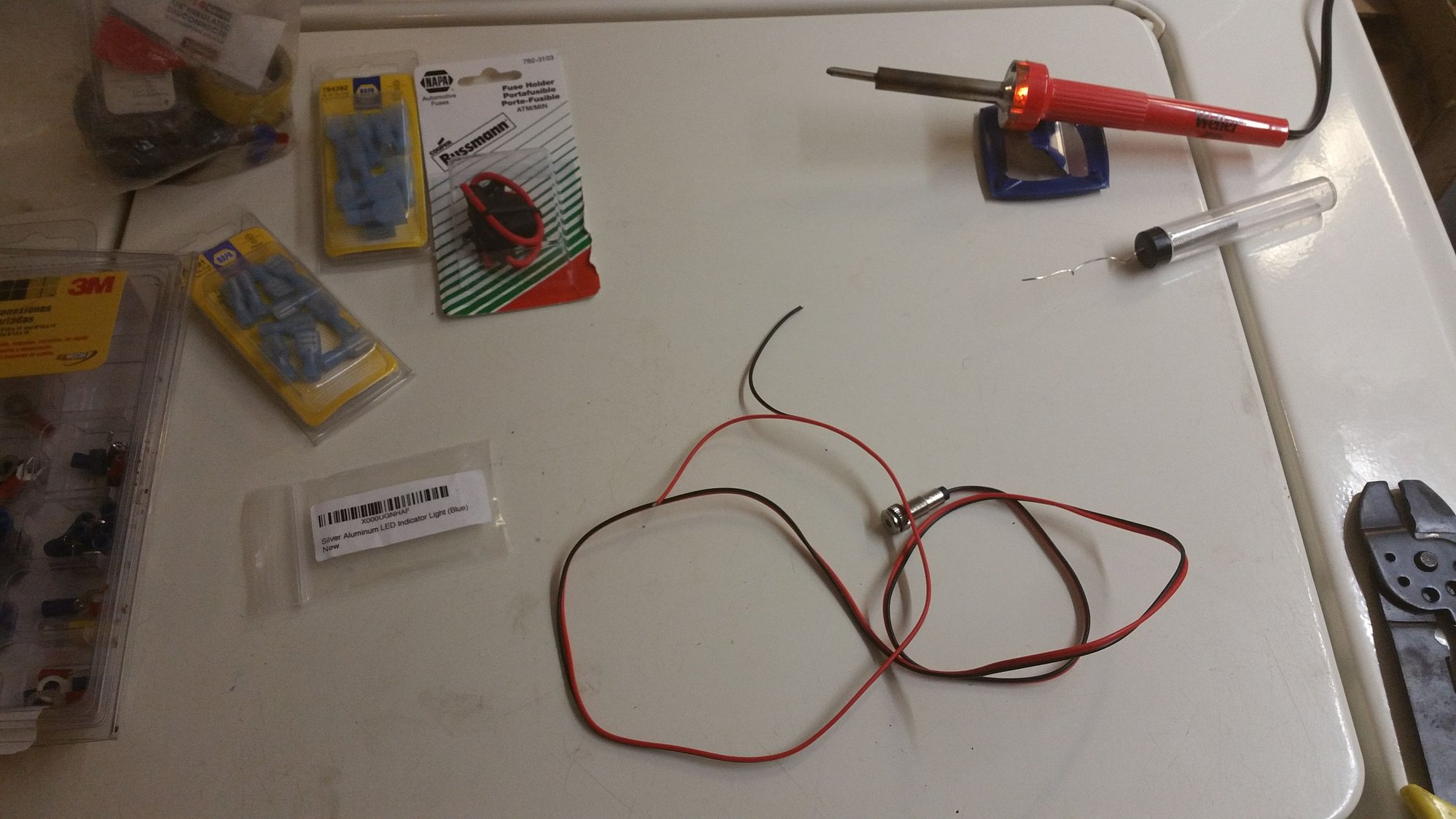

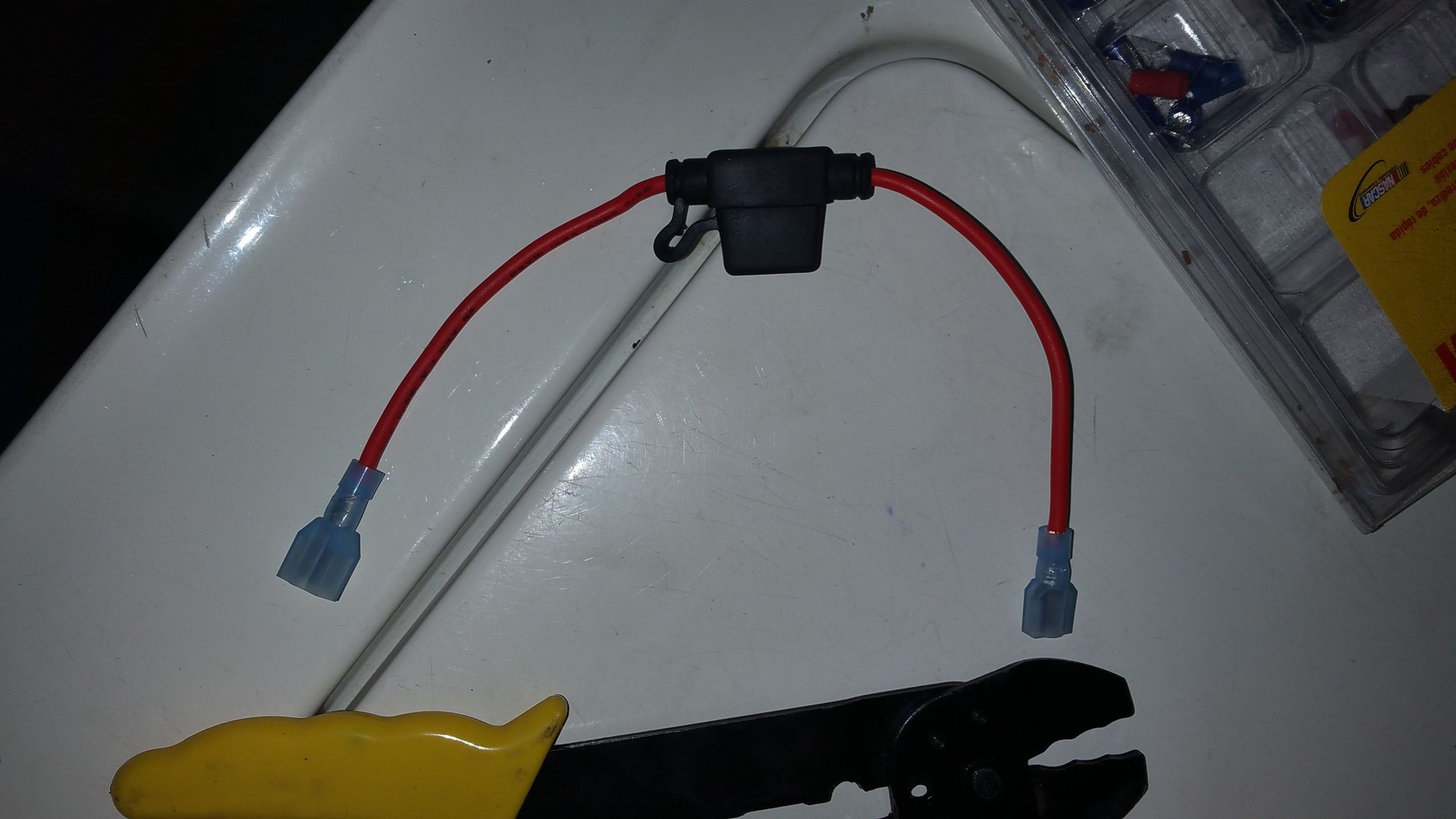

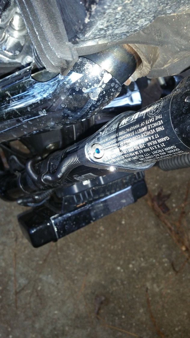

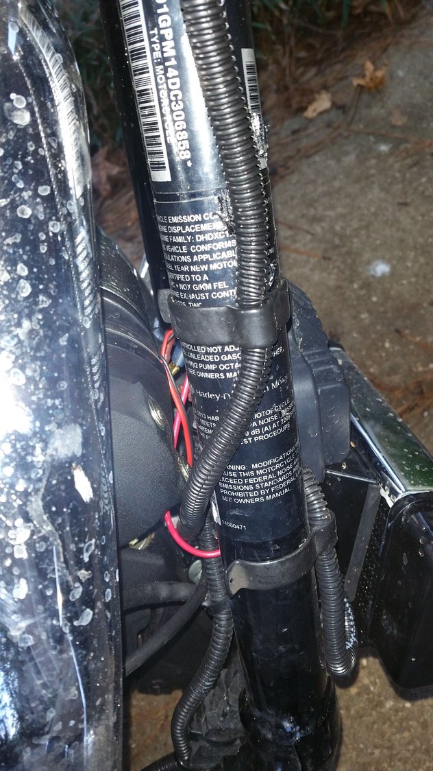

Bought a inline fuse to safeguard the ECU and an led to monitor the fan activity on the cooler
set up fuse (used 10A) to patch into the line. Mounted... nothing to see here

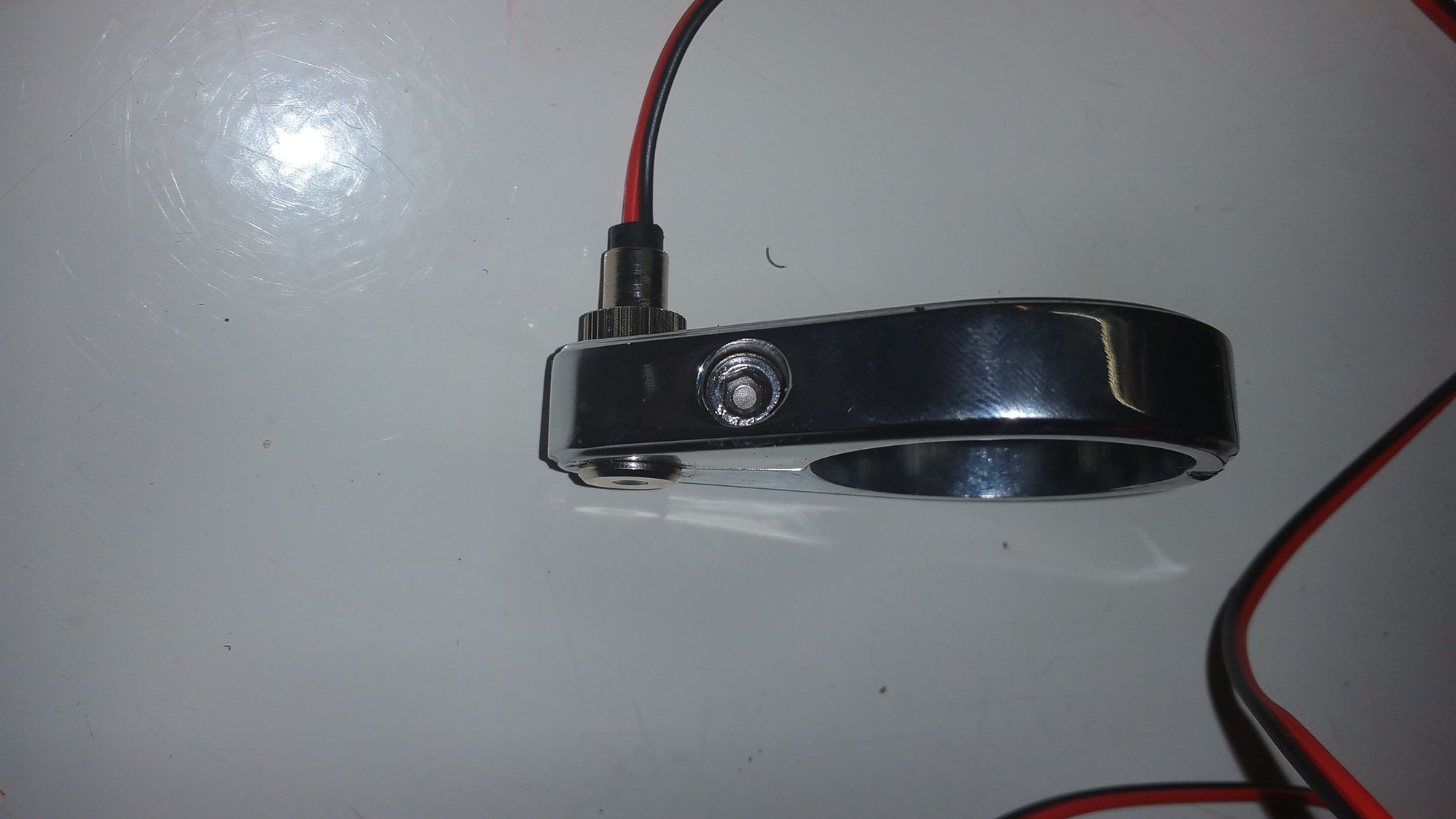

the dorman led is meant or panel mounting so it has a adjustable, knurled/threaded support. great
fitted the led into one of the clutch cable clamps i bought earlier to test fit it on the bike
fit better than expected. i ordered another clamp
waited on clamp

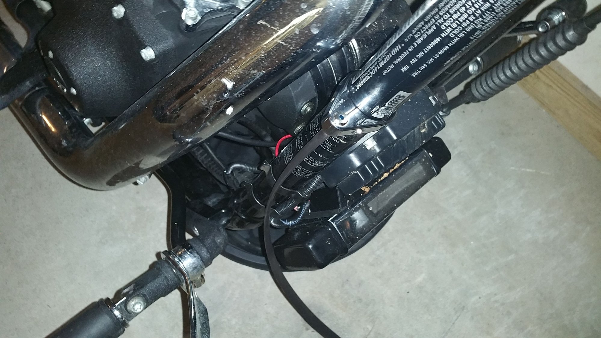

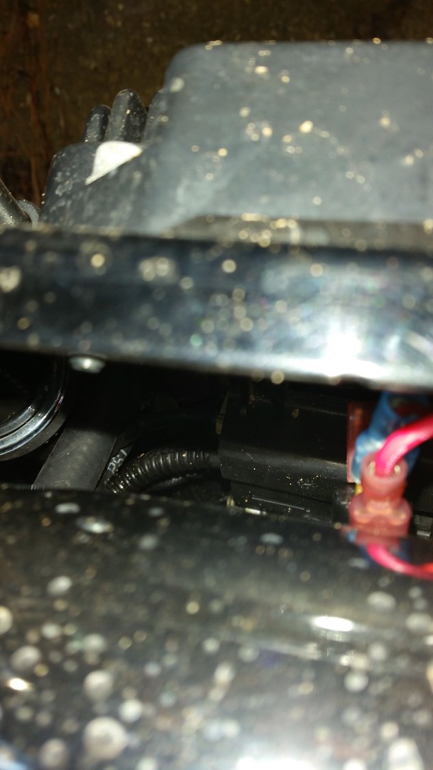

clamp popped up. i mounted the led and patched it into the fan power line via a piggyback slider connector. i grounded the led on the back of the regulator
test rrode the bike and the led lives .............done!

Originally Posted by robbyville
Awesome! So did the oil get warm enough to start the fan?
still have no idea, lol. the led came on thought so i know the fan should have come on. i still can't hear it. is yours loud?

Originally Posted by TinCupChalice
Excellent work, that's great thinking using the clutch cable clamp!
thank you actually. i kinda just sat there looking at the bike and in my tool box for some way to mount the led without drilling or putting it in a distracting position. clamp just jumped out at me.
