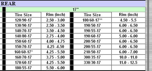

Yeah, not all 180s are created equal.
From http://hdwheels.com/Product.htm. Lots of good info...but not all accurate

That be them. Not 100% sure you can still get the GT502. Even if you can it wears FAST!

I had an Avon which may have had something to do with the quick wear. I think the 4.5 is a little narrow for a 180 (7.08 inches wide) and will stick with the 160 (6.29 inches wide) on a stock rim.

The tires listed (GT502, Night Dragon, and Scorcher 31) are designed to be run on a 4.5 rim. But it's your prerogative.
Just a side note. The 180 on my Street Bob is wear exactly like the stock 160 did.
