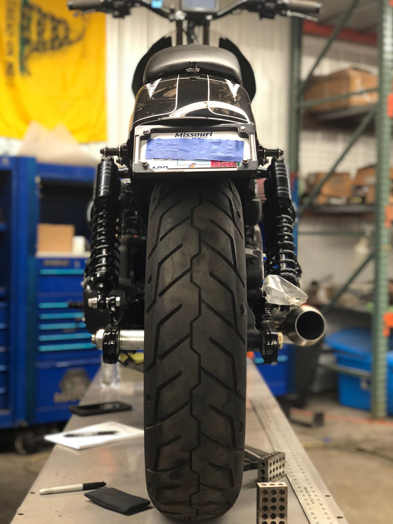

This my solution. Great Bike Gear relocation bracket and Custom Dynamics all in one plate frame. The QD hardware is the Bare Knuckle Choppers kit for their Adventure Bag System. Stock HD gear would look about the same.

I am looking to do the same setup as you. Any suggestions/info on how you wired it?

Like I said above it's a GBG relocation kit and CD plate frame. Make sure you get it with the diode to run it as a 3 wire setup. You need this to make it work as run/turn/brake. You'll need to notch your license plate in a couple of spots where the wires come out of the LP frame. I depinned my original signals and license plate light wires from the connector housing. Then you'll need to put new connectors on the wires from the LP frame. You'll also need to solder one leg of the diode to the running light wire and the other leg to the turn signal wire, the leg on the opposite side of the diode is then soldered to the power wire of the LP bracket. You'll need to do the same thing for both left and right signal. Once you have made those connections, you'll need to put new connectors on the three wires (run/turn/ground) and reinstall in the connector housings. After that all you need to do is re run the wires back up underneath the seat and plug them back in to the stock harness.
