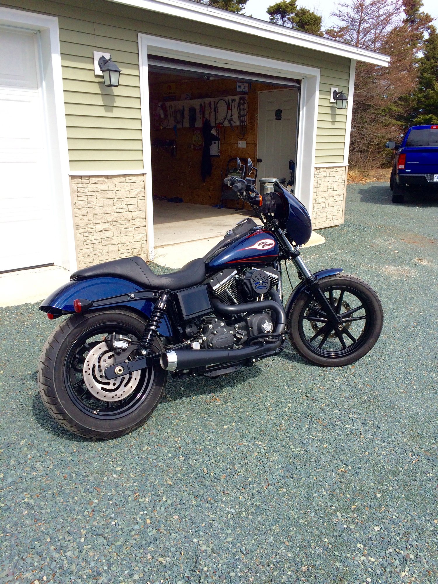

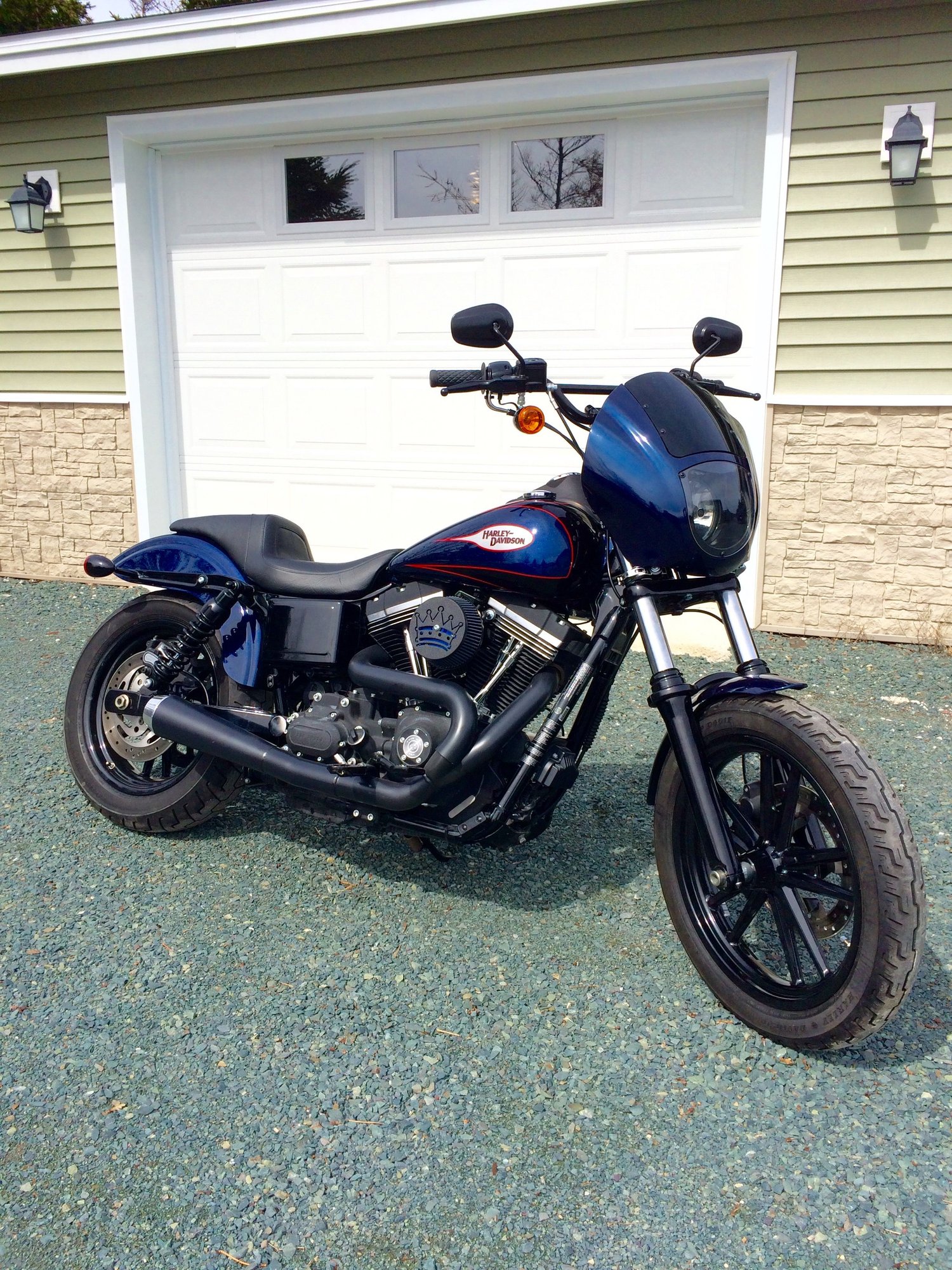

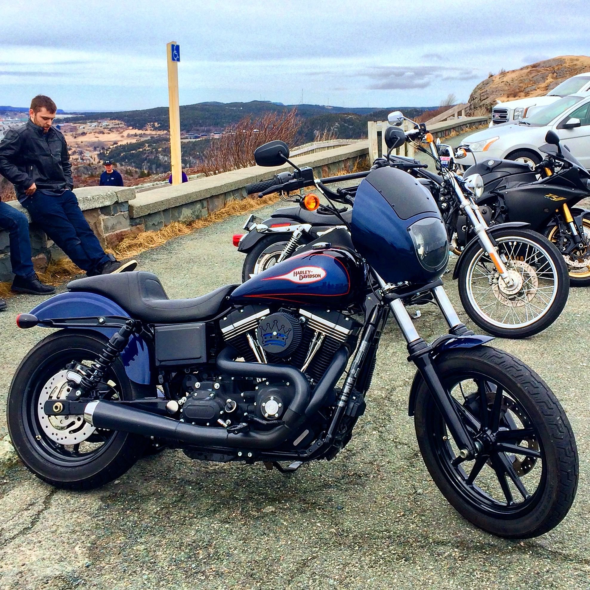

Finally got out for a ride yesterday and all I can say is holy sh*t!!! What a difference from last year. The suspension is 1000x better I can't believe it. It all finally paid off, all I need now is a tune. Here is the full list of things I've done this winter.
- Bassani RR2
- Vance & Hines VO2 intake with external venting and bungking cover
- HD quarter fairing (painted to match) with bungking brackets
- Repaired crack in front fender (also repainted)
- Black Superbrace
- Switchblade wheels powdercoated black
- Powdercoated turn sigs horn handlebar clamp and other various parts
- 8.5" pullback risers
- Biltwell moto bars
- G2 ergonomics 1/4 turn throttle tube with Biltwell thruster grips
- Biltwell mushman footpegs
- Black HD mirrors
- LED headlight bulb
- Mustang fastback seat
- 13" Progressive 444's
- 1/2" PVC spacer added to stock front suspension
- RSD adjustable preload fork caps (black ops)
- License plate relocation and stupid ugly tail light delete
