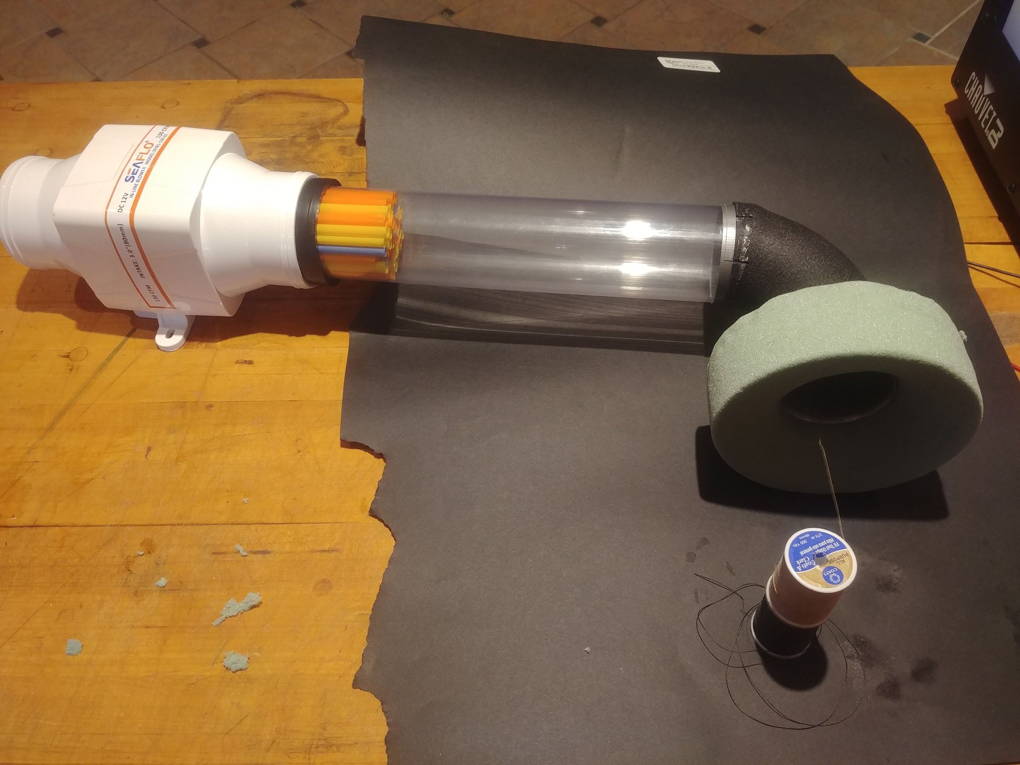

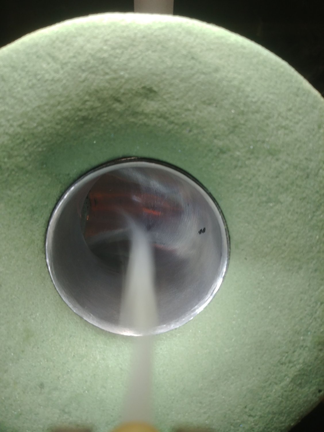

Started getting most of the parts together for my little flow bench. Still waiting on the honeycomb and anemometer.
The basic setup. Bilge blower and a variable power supply so I should theoretically be able to provide 0-130 CFM. 12" length of clear acrylic tube to see how air is exiting the elbow. I stuffed some tightly packed straws into the outlet end because the air was pretty turbulent (thanks Mythbusters, it worked pretty good!)

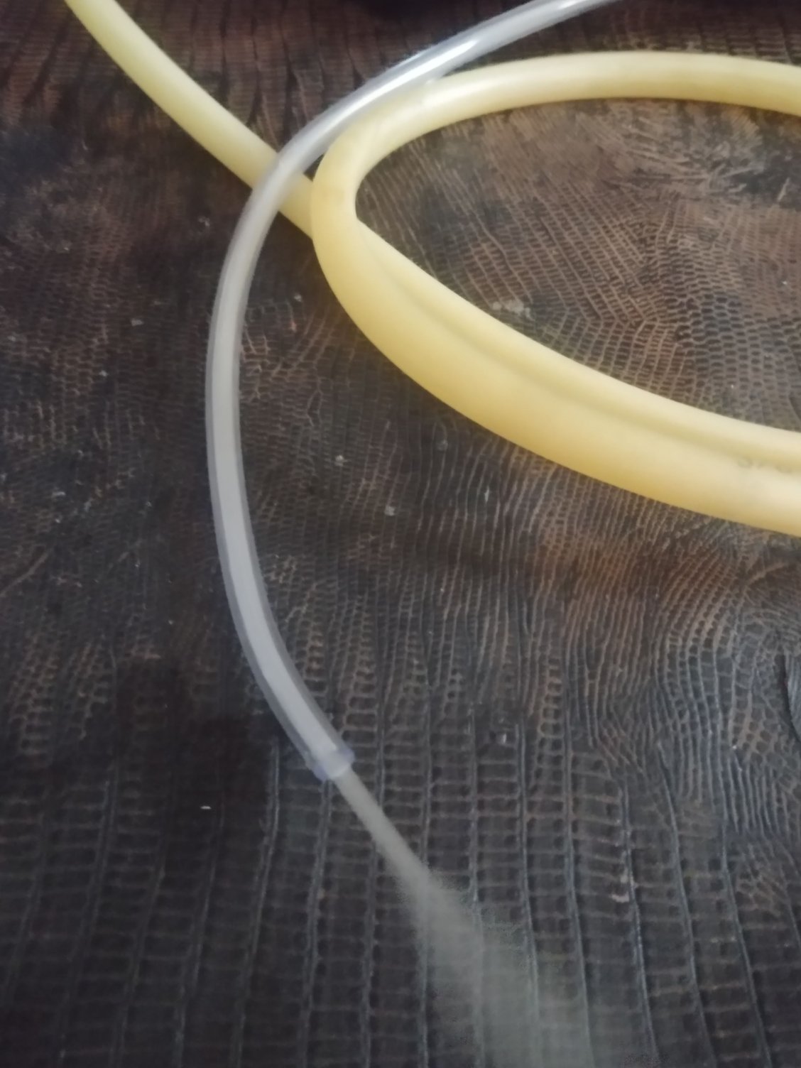

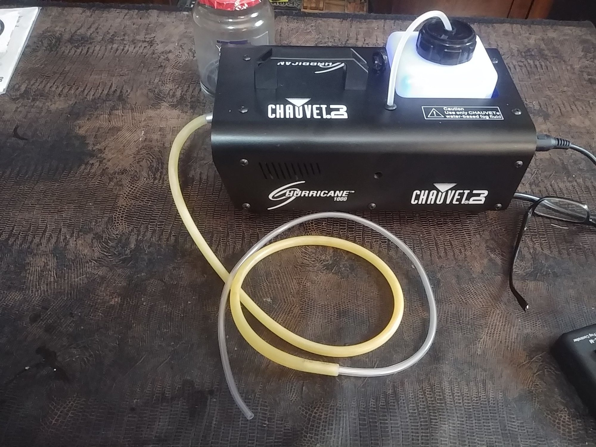

Chauvet Hurricane 1000 fog machine for fog on demand. Added a little hose to outlet so I can direct it. Waiting on another controller for it so I can alter the pump speed. Not sure exactly what it will do, but I like to play. It's a sickness.

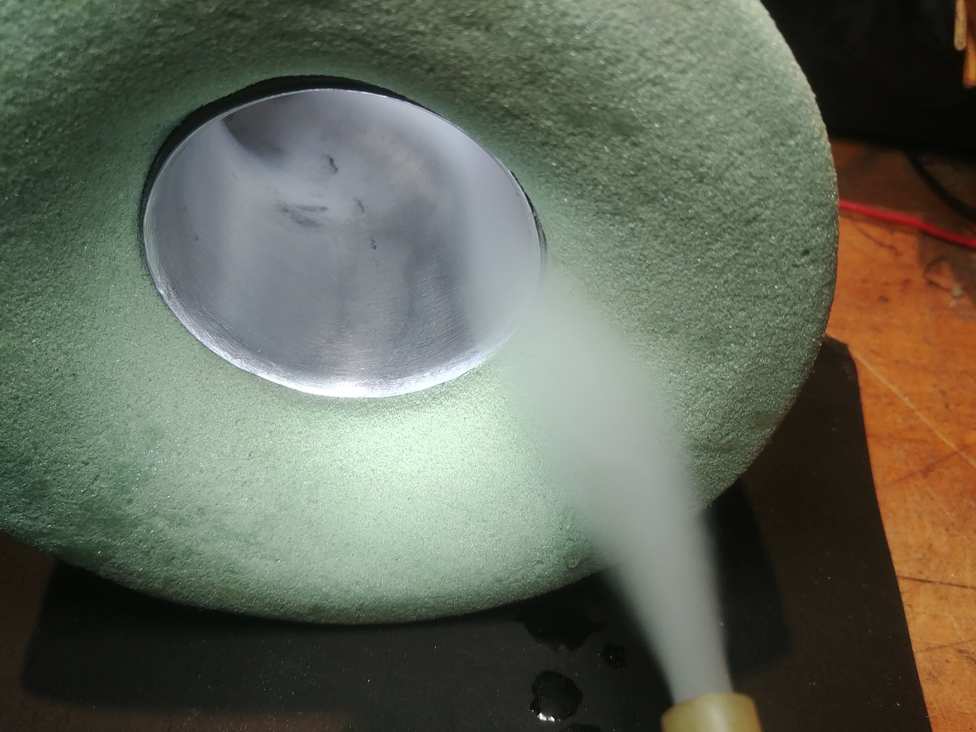

I made a crude bellmouth from foam to help with inlet turbulence.

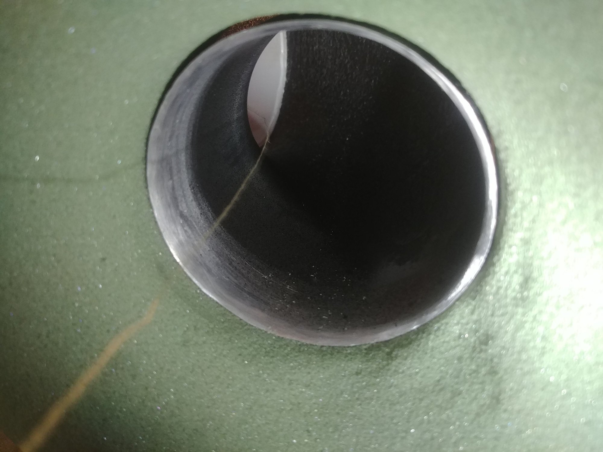

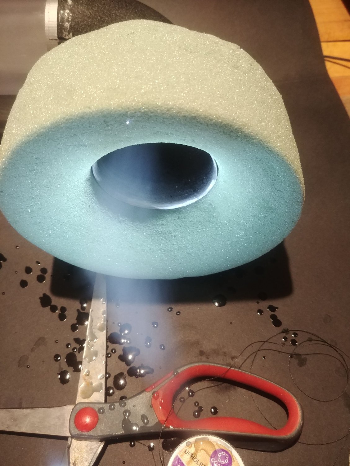

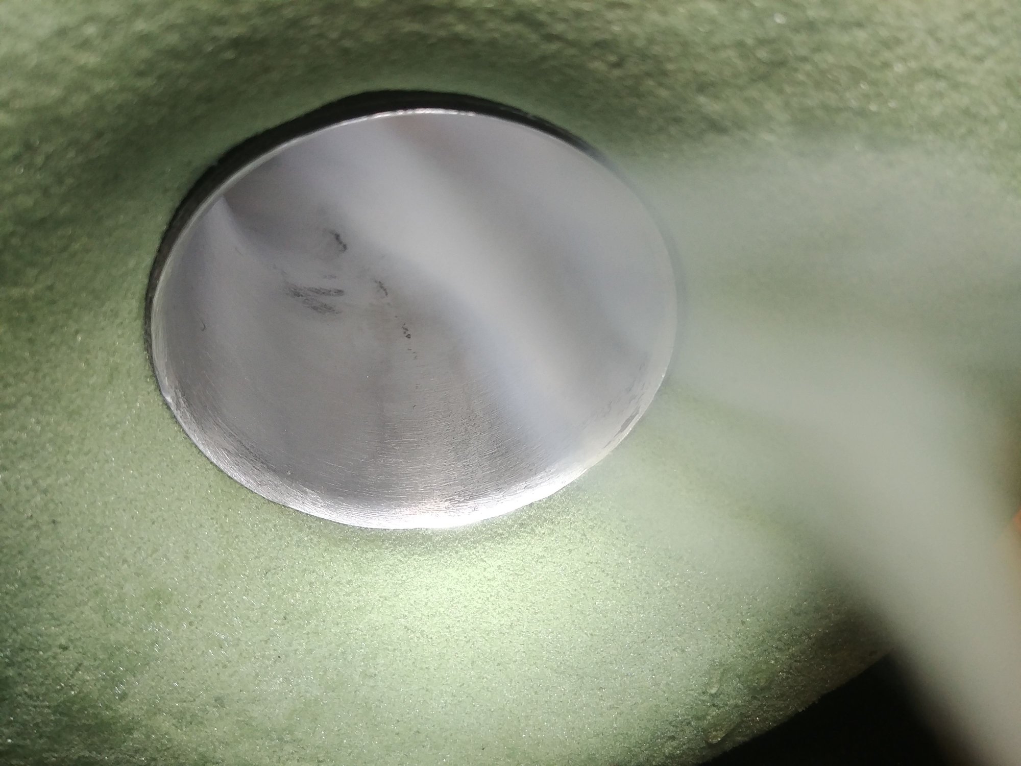

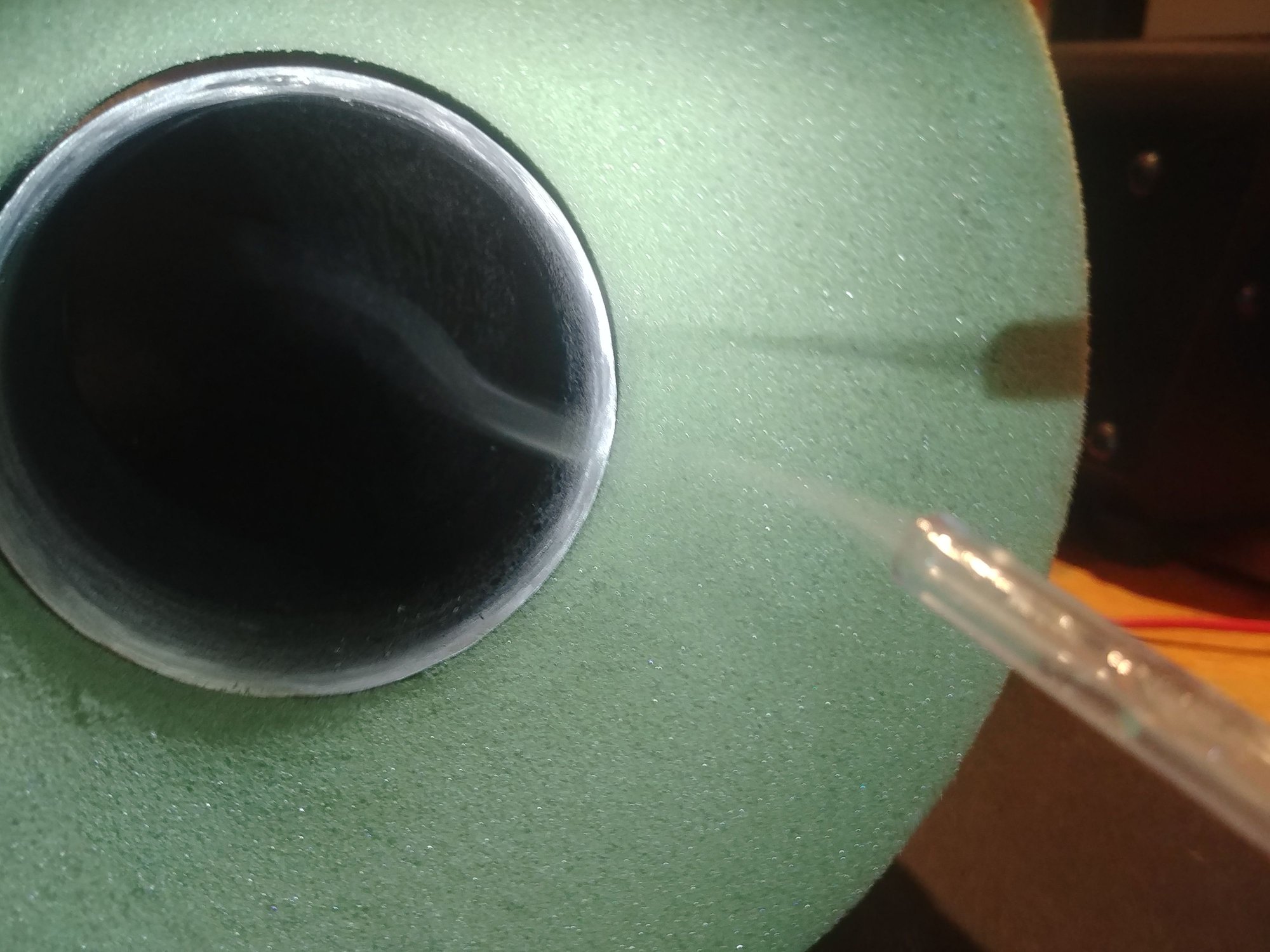

I'm surprised by the early results. The greatest flow density/velocity seems to be at the inside of the bend. Regardless of where I introduce fog or thread, it exits the short side.
Right now the tube has a wrinkle finish on the outside half (roof) of the interior and a gloss finish on the floor. I'm going to polish it next and see how that affects flow.
This is really hard to get good pictures of...

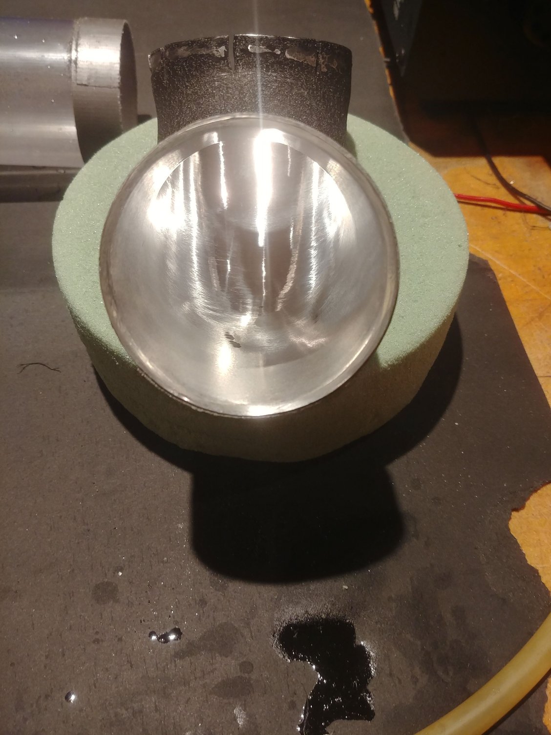

From: NW Ohio
Lol, yeah. I was popular at my last job because they could put me on almost anything that needed done...and I worked for peanuts.

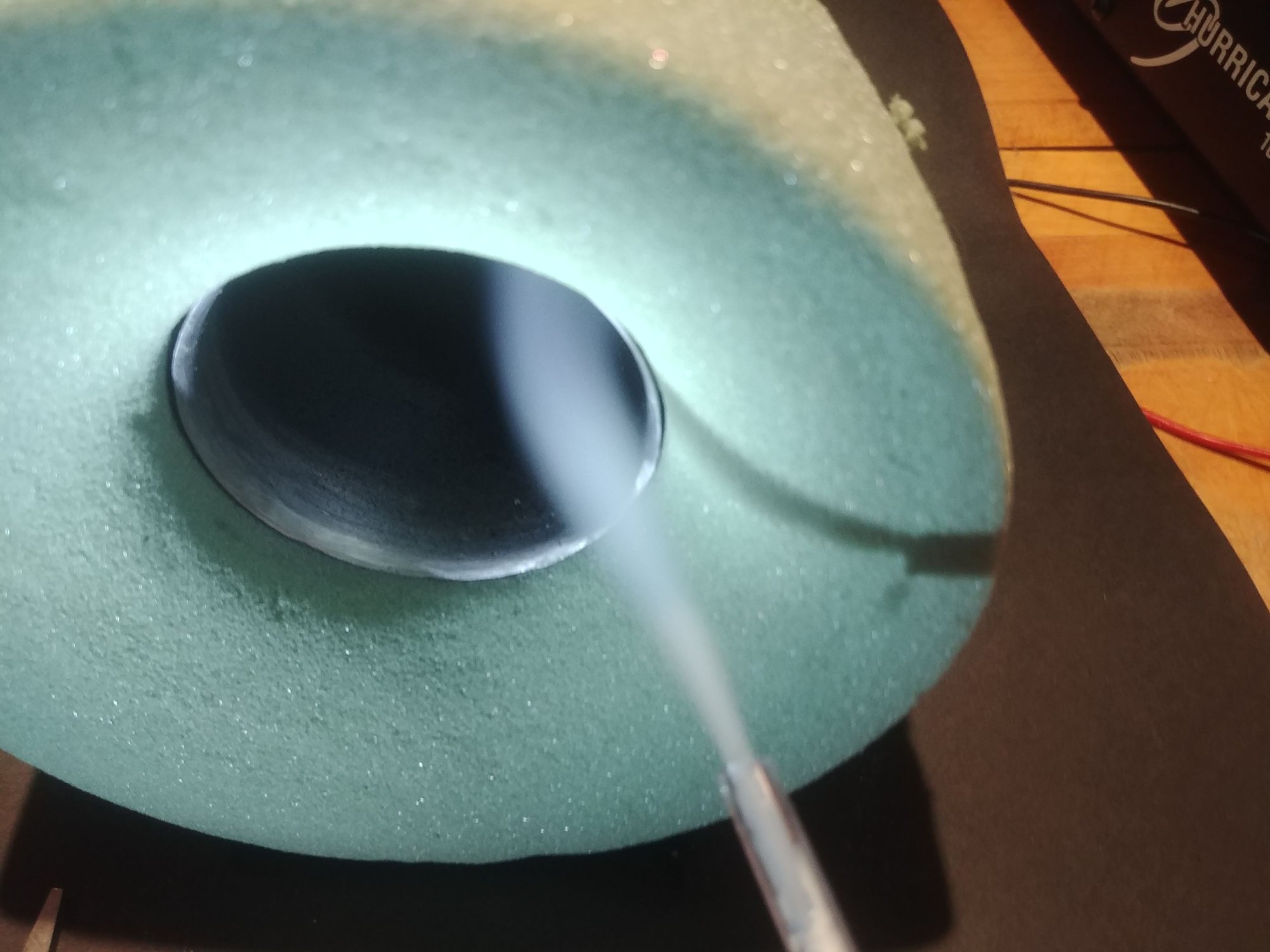

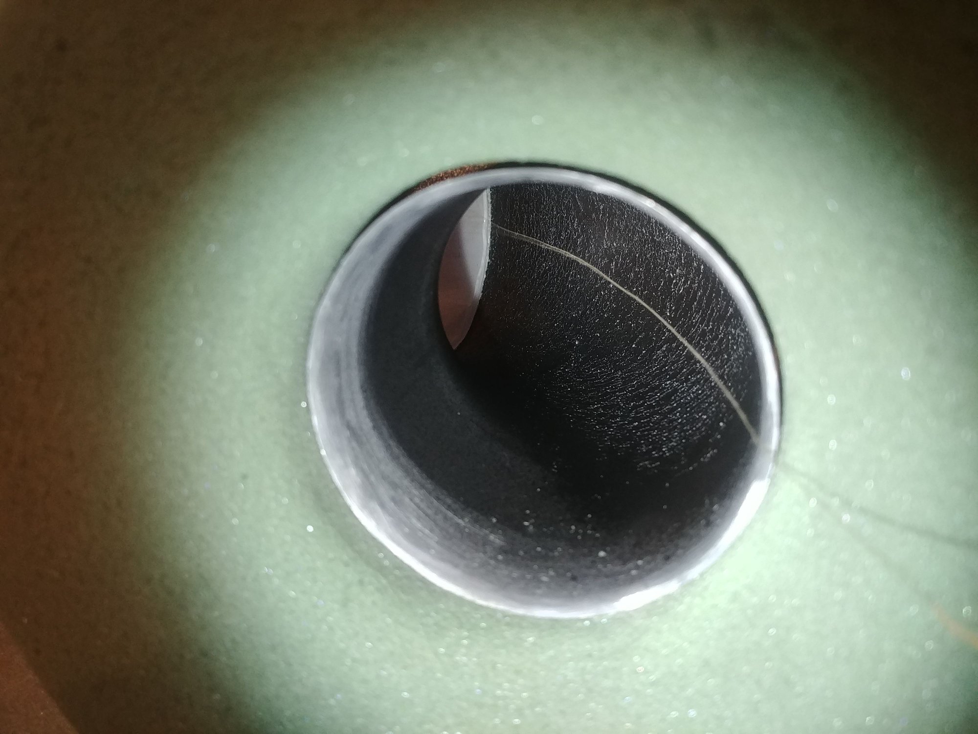

Sanded and polished the interior. The roof is polished and the floor is sanded to about 600 grit.
Flow is a lot less turbulent but still biased toward the floor. I think I'm gonna run out tomorrow and get some clay to simulate the carb throat and play with the shape of the bend a bit.
I couldn't get a decent shot of the thread or fog, but here...

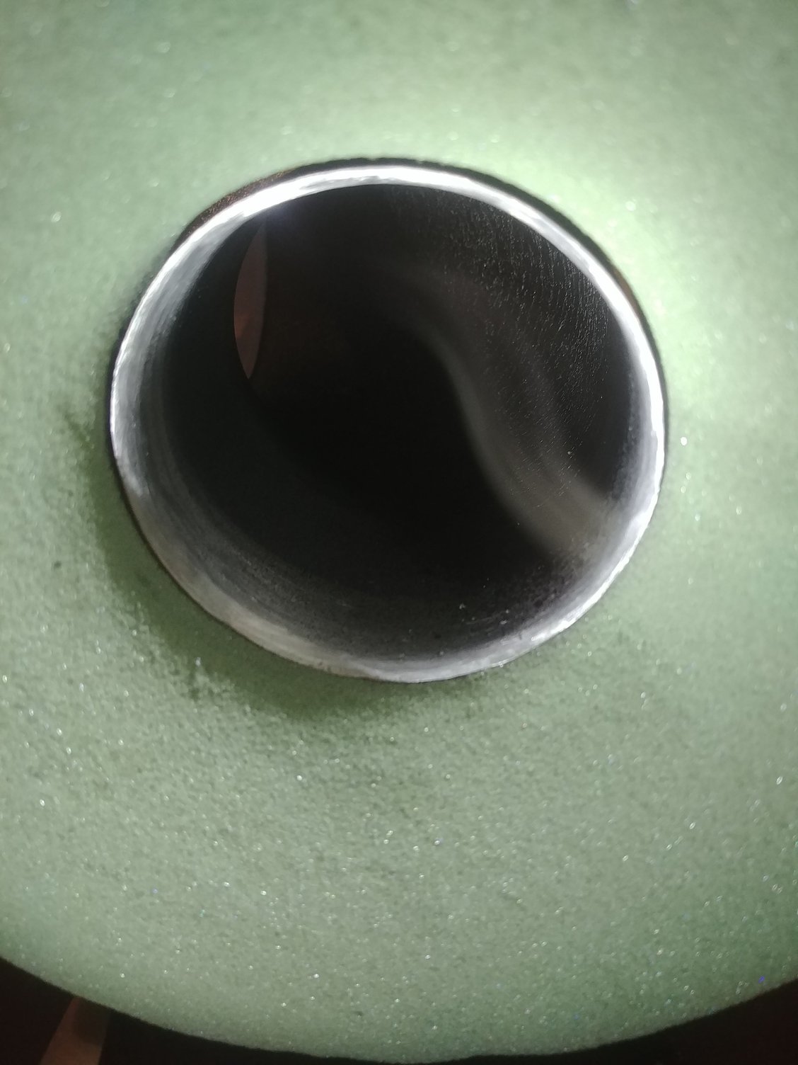

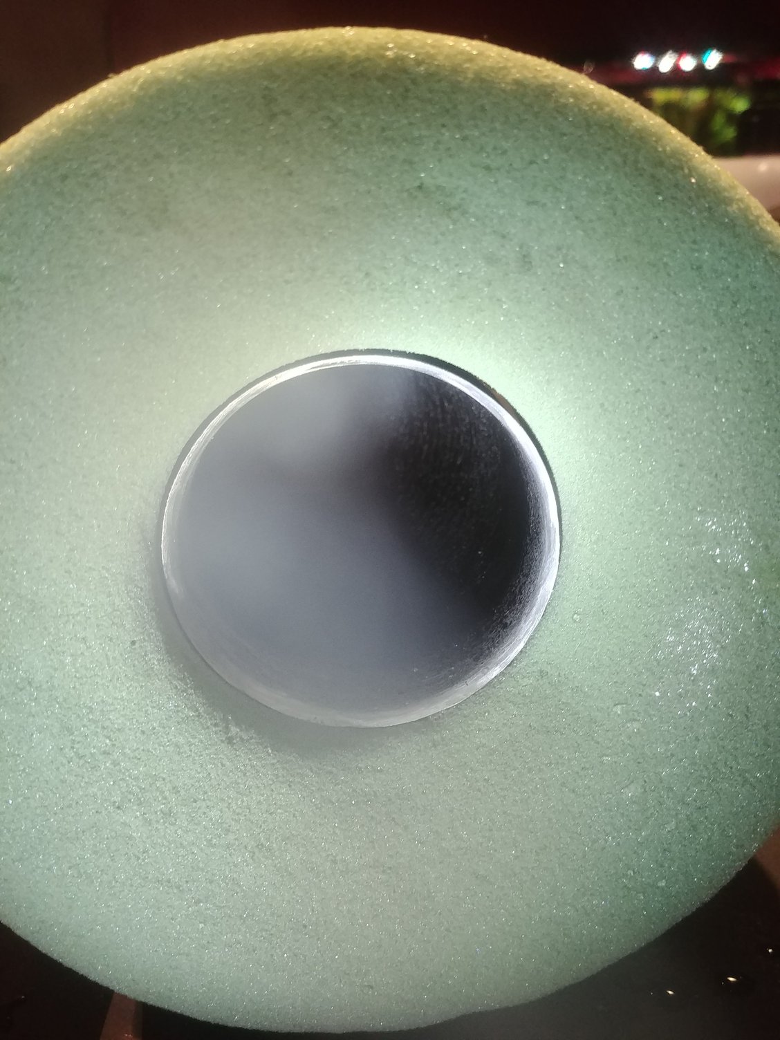

Here are a couple shots post-polish. Not very illustrative, but it's something.
Not sure what kind of flow rate I've got here, but it's maybe 70% of max for this blower. I sized the blower to be around the same theoretical flow as my engine at red line so I figure this is near representative of cruise RPM...maybe?
I'll verify the actual flow rates on the engine and bench once the anemometer gets here.

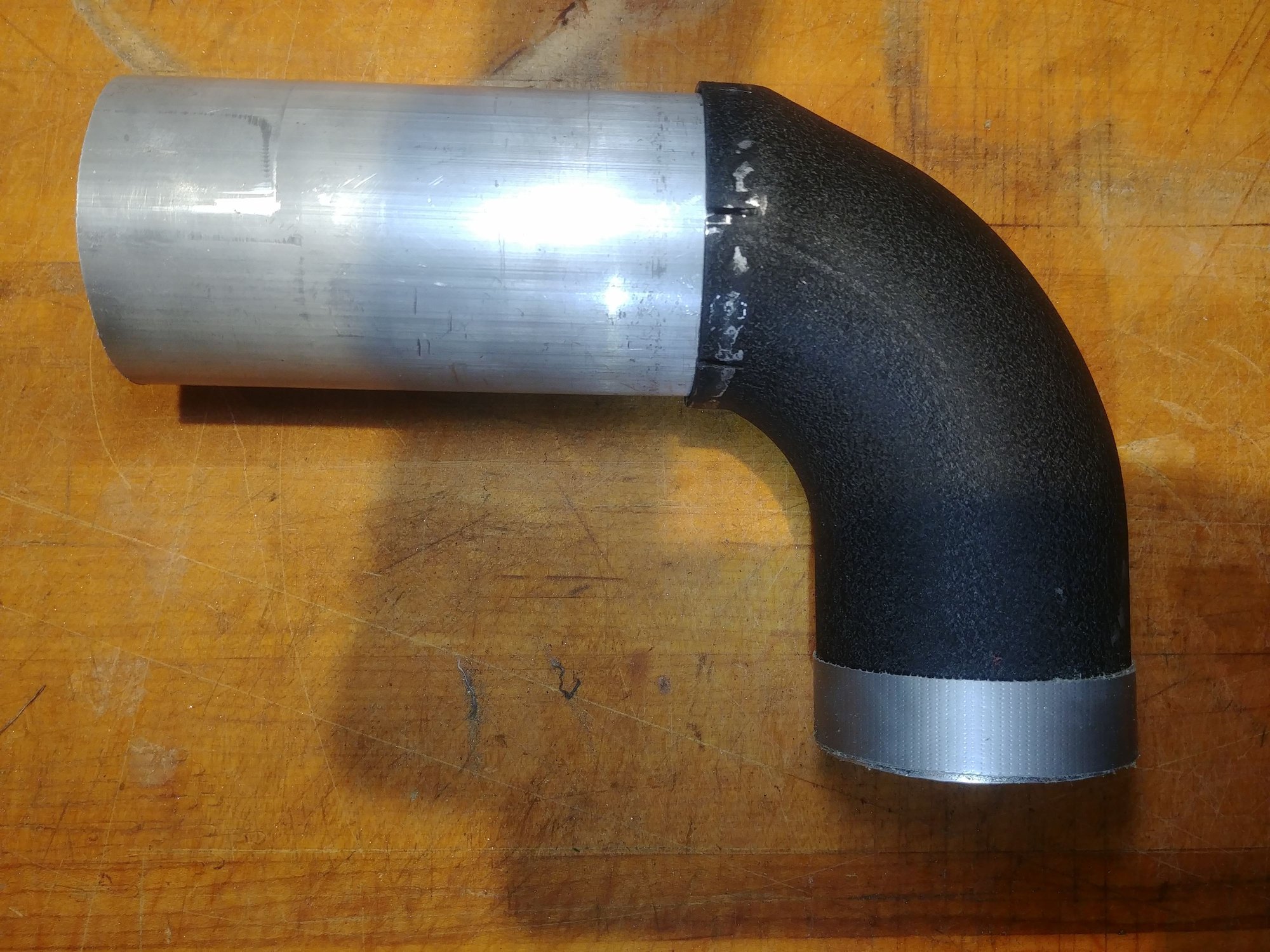

Very instructive ! Is the bend a perfect 90° ?
Old Oct 26, 2018 | 01:54 AM
  #1160
cggorman's Avatar
cggorman
Posts: 11,448
Likes: 2,299
From: NW Ohio
Yes, but it's shortened on the outlet side. It's sort of two bends. The picture doesn't show it real well.
