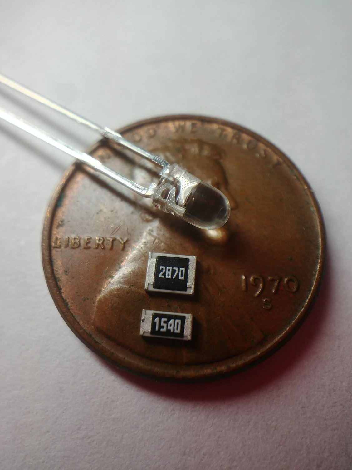

Fabrication (printer) is close to ready so I ordered the LEDs and resistors from Digi-Key. $125 just for those items... Was able to get 3 of the 4 resistors in the physical size I wanted. The 4th is a bit bigger. Will have to revise the PCB layout to accommodate.
Got charged $11 in tariff fees for the China-sourced (Kingbright) LEDs. That was a surprise. The resistors were from Japan (Panasonic) and did NOT have a tariff added. The LEDs were very specifically chosen for their size and performance and no other manufacturer I found offered a comparable alternative. I tested about a dozen different ones.

Got the LEDs and resistors. These should be interesting to solder by hand.
Need to solder about 260 LEDs and 80 resistors.

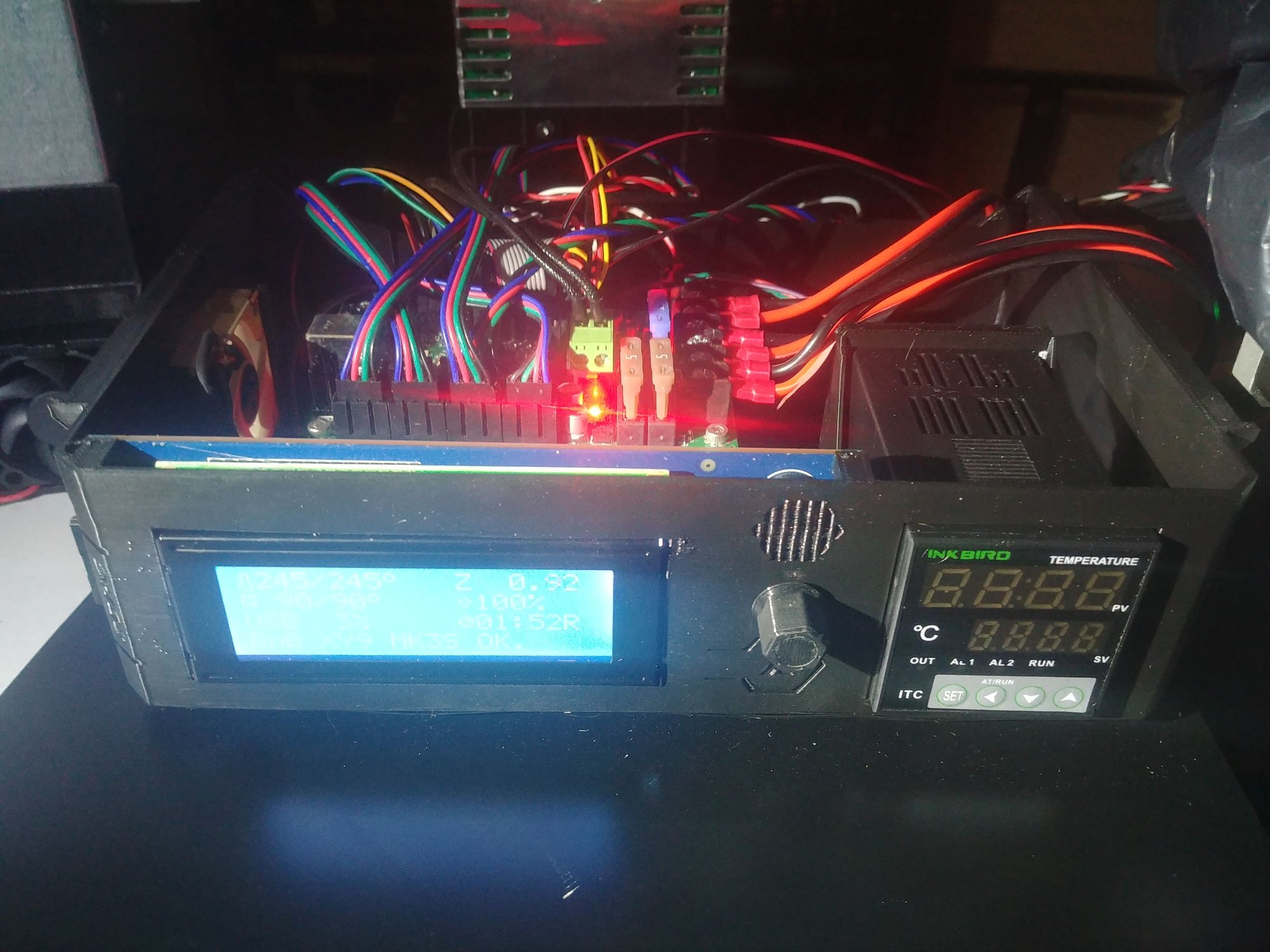

Got the heater and controller enclosure done.
Enclosure holds the main printer mainboard, Raspberry Pi 3B (for network comms and some aux systems control), PID heater controller, printer display, cooling fan, and some MOSFET switching modules.

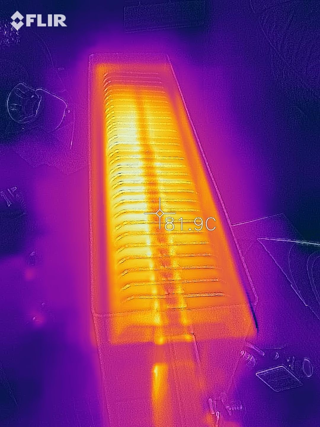

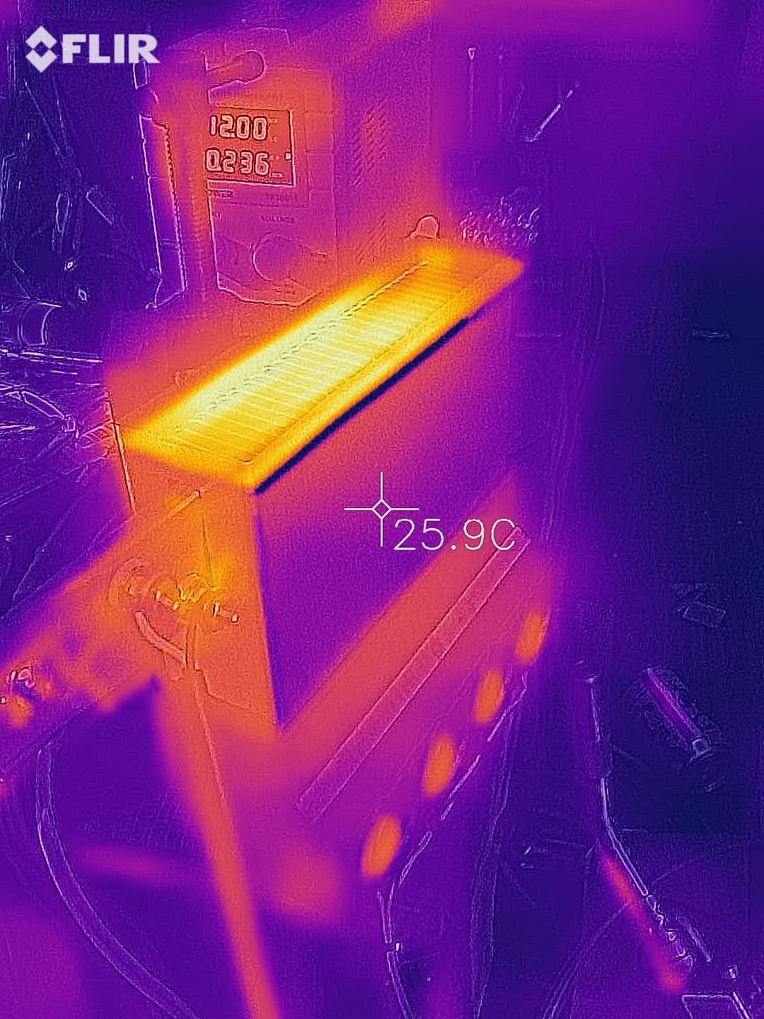

Heater is a 120V, 350W Vulcan finned strip heater in a custom steel housing. Airflow is handled by four 40mm fans capable of a total of about 20 CFM. Black parts are custom printed. Bottom is smoothly radiused inside for the air and has toolless fan mounting. The wedge at the top is just to cover the AC connections. Unregulated at 25C ambient, it maintains about 150C output air temp and the housings remain at ambient.
Working on the last (hopefully) revision for the water cooling system now.
