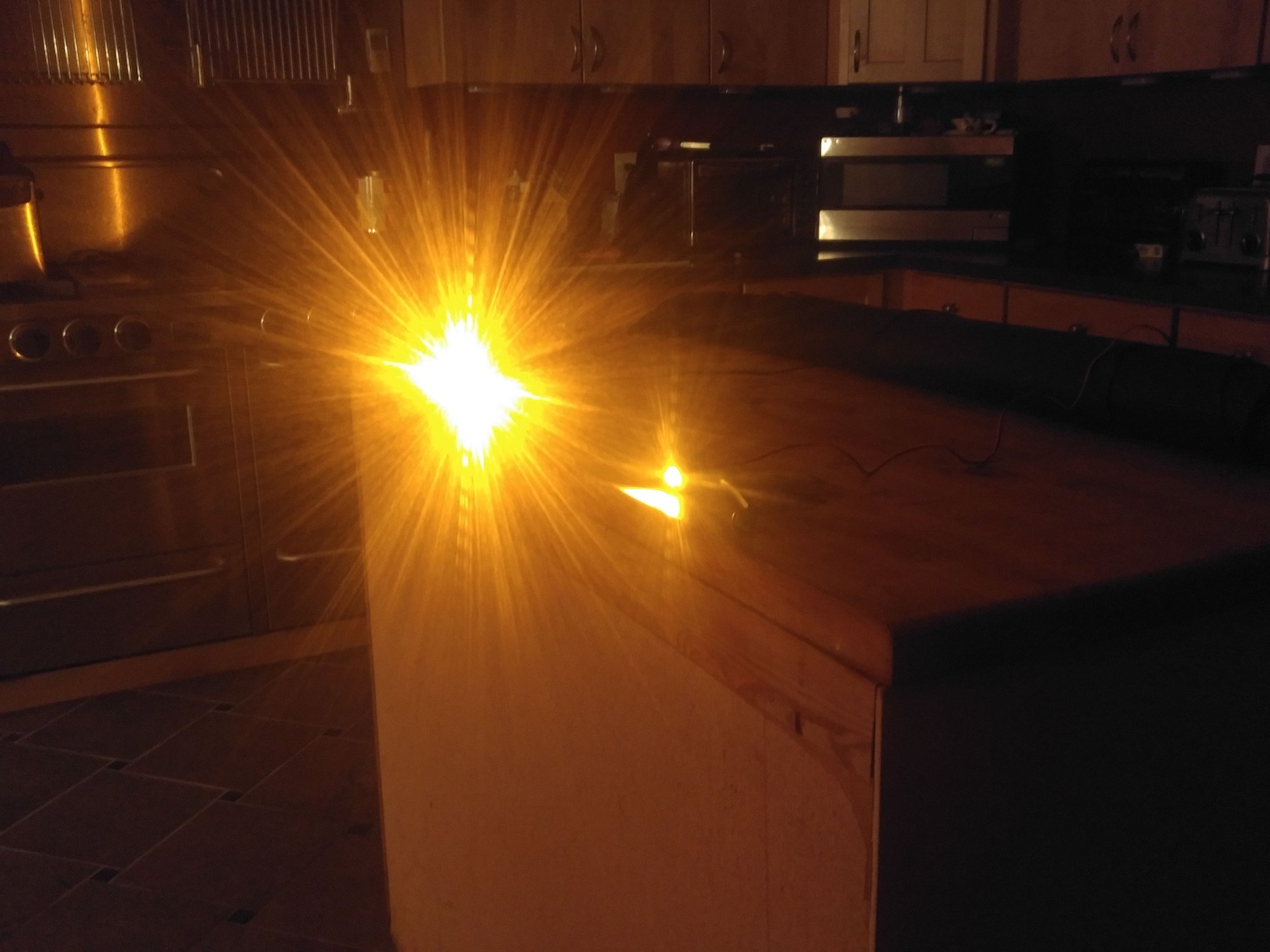

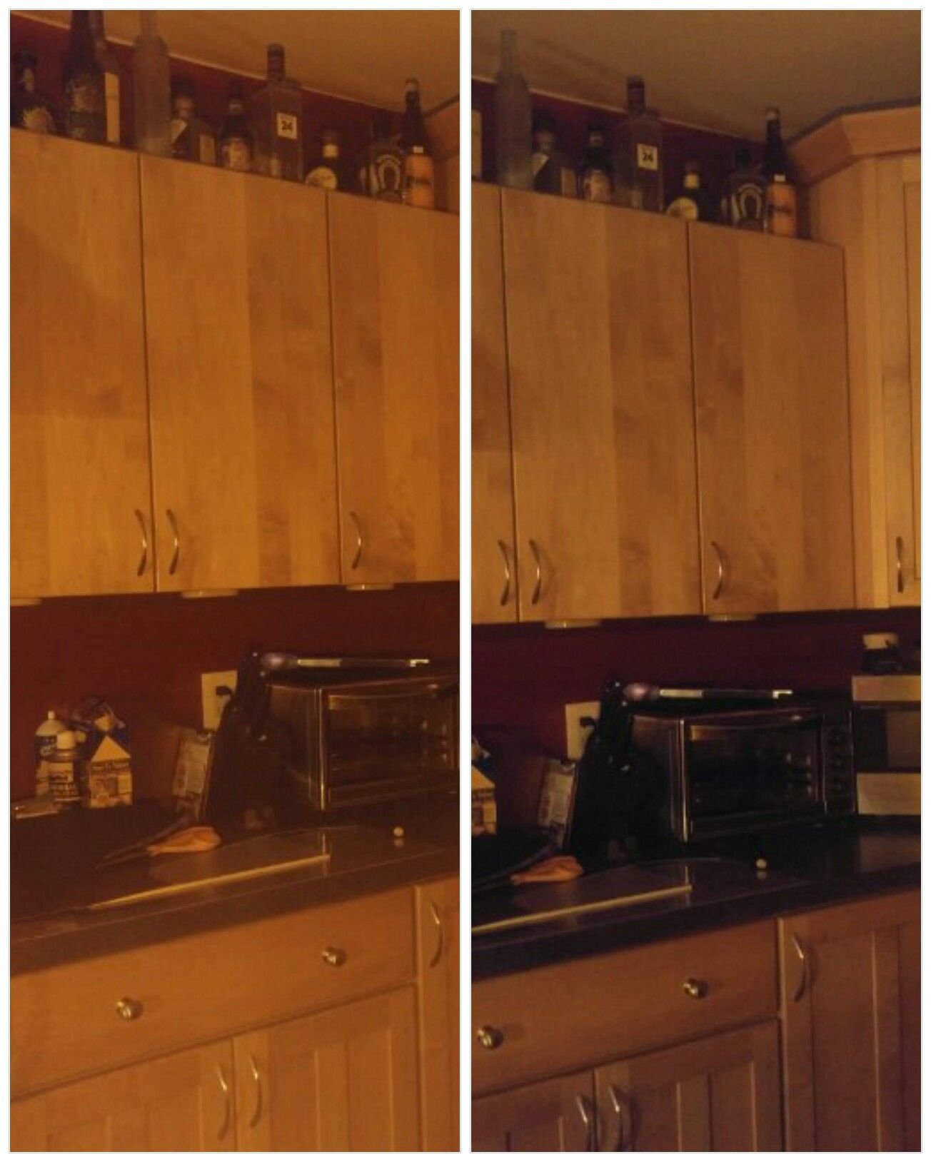

Night shots, as promised...
3W on left, 1W on right. In person, the 3W is perceptibly brighter, but not by a factor of three...or even two. Maybe 15%.
HOWEVER... at 45 degrees off axis (probably the minimum angle a vehicle in an intersecting turn lane would be at), the difference starts to become obvious. The 3W is probably 2x as bright.
...and even more pronounced by around 70 degrees off axis.
This from above, about 85 degrees off axis. You can see the beam angles. They are conical so the off axis dimming applies to rotation of the controls or bars fore/aft or to high riding vehicles.
Tried to show how they illuminate a space but it didn't turn out great. The 3W is on the left and is quite a bit brighter in the room in real life.

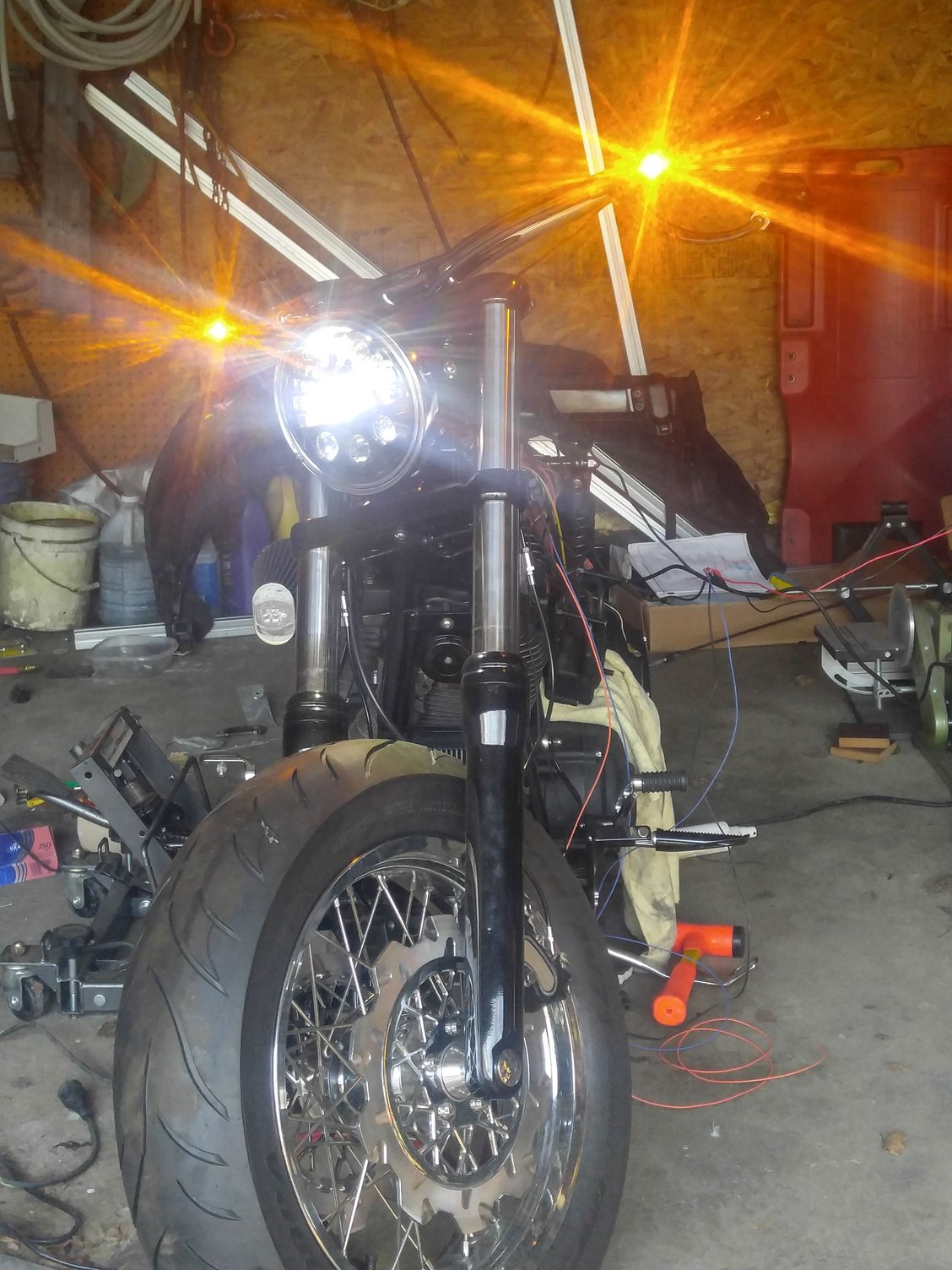

Got the levers mostly installed. Still need to route the wires. Daytime visibility pics with headlight....
ETA: All three lamps together draw about 1.4 amps at 14 volts (low beam)(20W). On high they draw 2.5A (35W)
Sorry about the cluttered shop. I'm not good at cleaning while I work.

Man, I love those LEDs in the levers. Cleaner looking and probably way more visible than the little fork mounts I have below my headlight. I dread running a wire back through my bars at this point though.
Old Mar 5, 2018 | 10:18 PM
  #869
cggorman's Avatar
cggorman
Posts: 11,448
Likes: 2,299
From: NW Ohio
I'm not sure how the designer intended the wires to be routed, but I assume they are to supposed to pass into the stock switch housings somewhere...or be run externally. NFW am I running external and my solid alminum trim pieces completely cover the bar dimples. I knew months ago that I was moving away from the bar-end signals, in favor of control mounts so I was expecting to have to drill holes...so I've left the bars unfinished. Drilling more holes at this point is no big deal. LoL!
