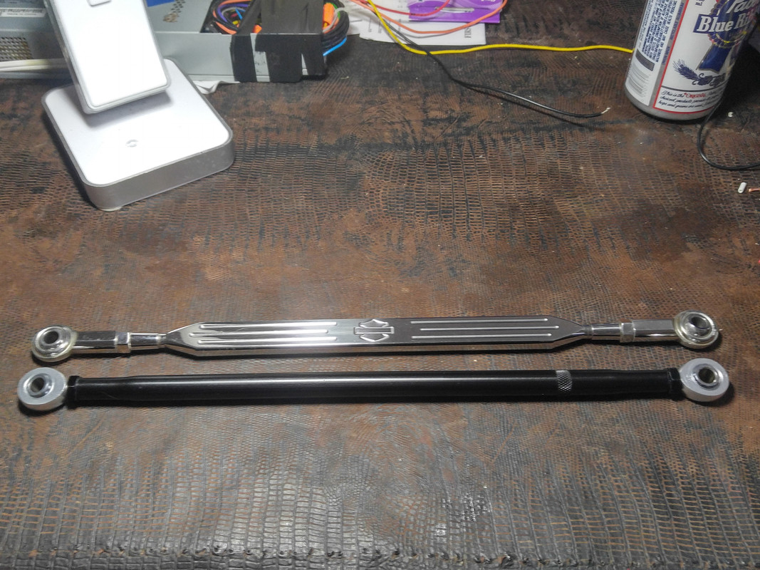

Mocked up a shift linkage in CAD and ordered all the components. $50 shipped. All aluminum and fairly light. .18 lbs, supposedly.

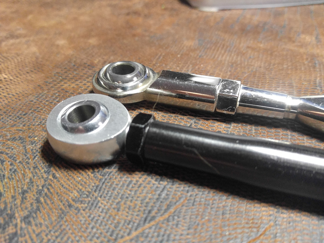

Got the shift linkage parts in and assembled. 96 grams (3.4 oz) vs 282 grams (10 oz). Almost 1/2 pound savings. I thought the old linkage was aluminum, but it's slightly magnetic. Must be stainless.
The heims are nice and tight. Great for most applications, but I'll have to get 5/16 shoulder bolts to keep the shifter rotating freely. The nuts were supposed to be 3/8 hex but they're actually 1/2. Not a show stopper, but I try to may hunt down some of the 3/8.
The assembly adjusts from 13" to 14.5" center to center.
I may paint or polish the heims. Haven't decided yet.
