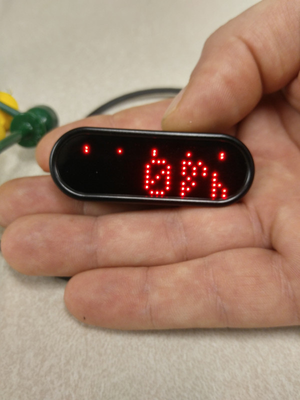

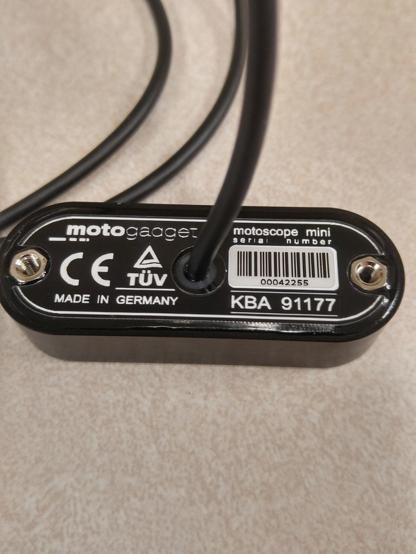

Motoscope Mini came in. This thing is dope. Loving it!
Speedo, Tach, odo (fully programmable), trip odo, trip timer, & shift light. LEDs are even dimmable and has a photo sensor for day/night settings. All in a package about the size of a AA battery.
A quick vid of benchtop bootup. No sensors, so no data, but I did play with some of the settings.
And a couple quick pics.

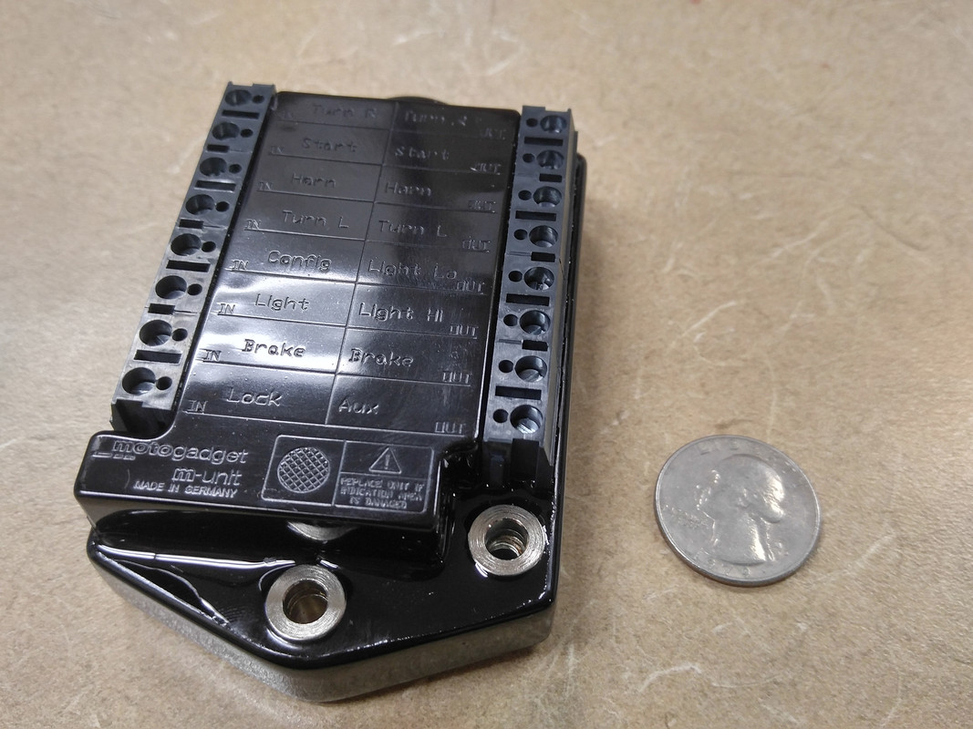

Also got the keyless ignition and m-unit.
The M-Unit replaces all the bike fuses, starter relay, & TSSM, plus adds programmable (flash rate/pattern, brightness, etc.) LED drivers (no more load balancers or resistors), adds a 1 or 2 stage security system (also programmable for sensitivity, etc), and probably a few other things..
The M-Lock is a super simple RFID tag and reader. Programmable to recognize up to three keys/tags. There is an optional "key" that's smaller than an aspirin that could be sewn into a cuff or glove.
Not pretty, but pretty cool...
