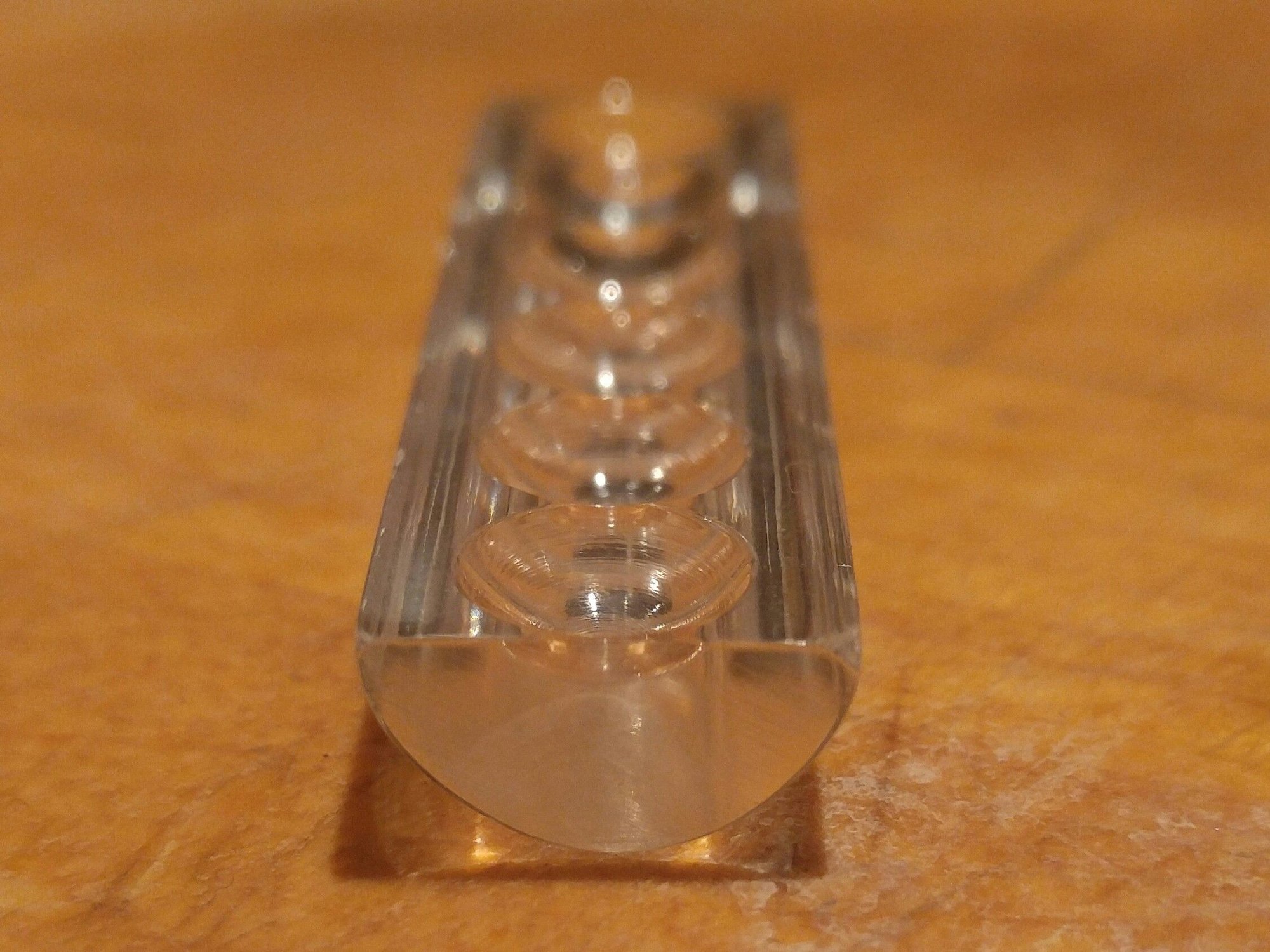

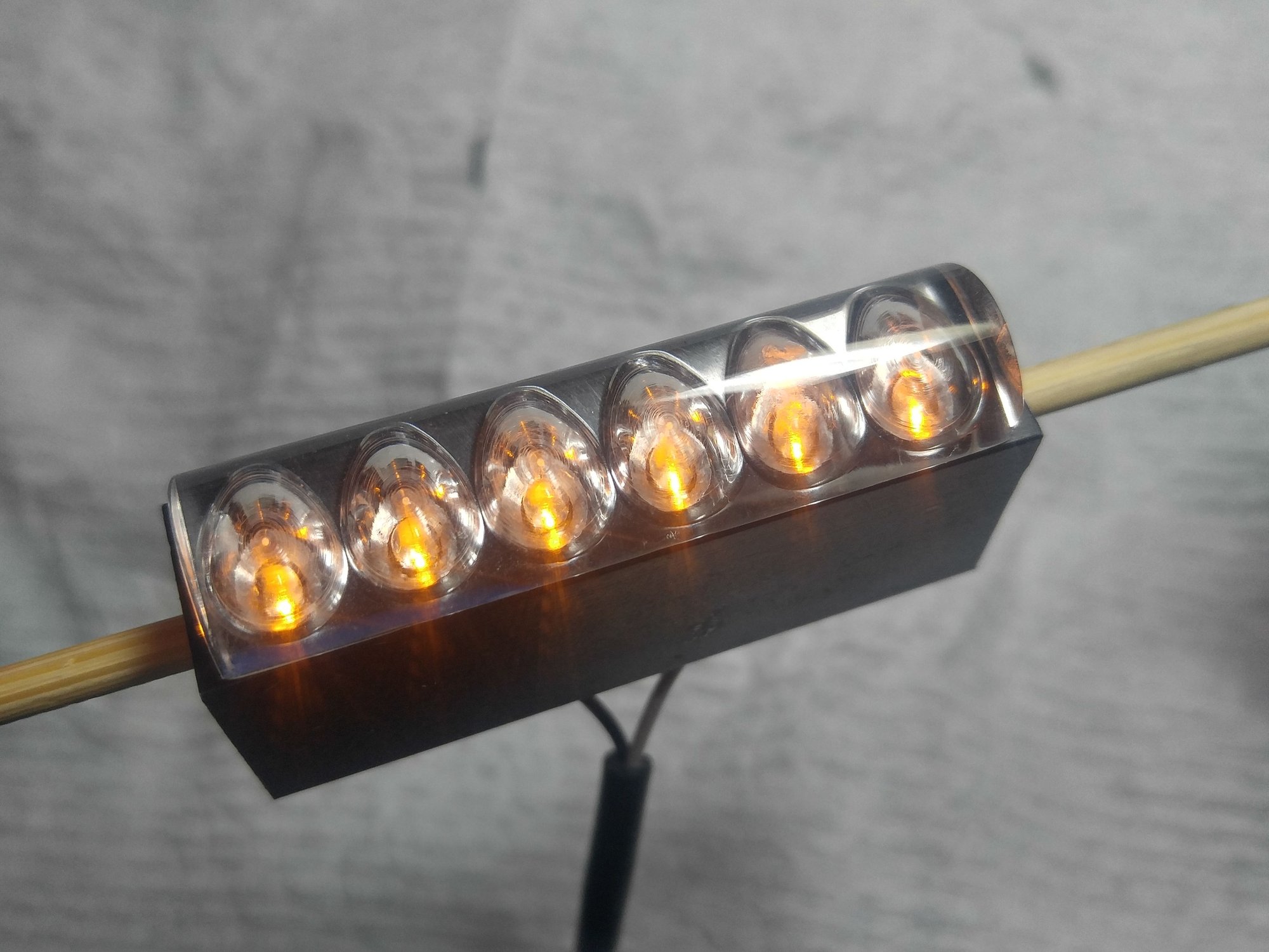

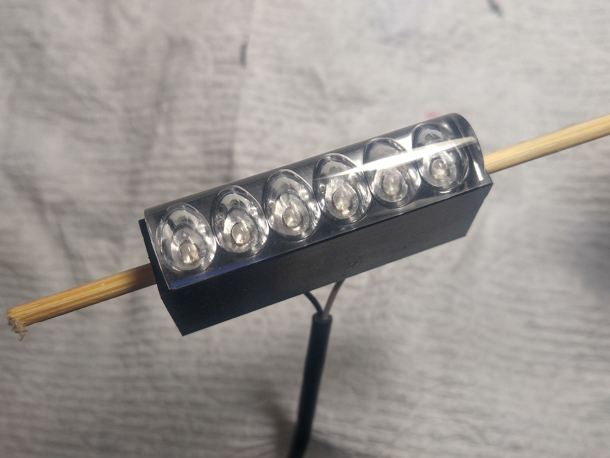

I think I've got the lens nailed down. Quite a bit more work but it looks a lot better, both on and off. Cut a small radius and flattened the inside, then hand sanded the tool and extrusion marks inside and out to 2000, then polished.
Now I want to nail down the chamfers. I think I want them touching or overlapping slightly. Then move on to the closure/bracket part.

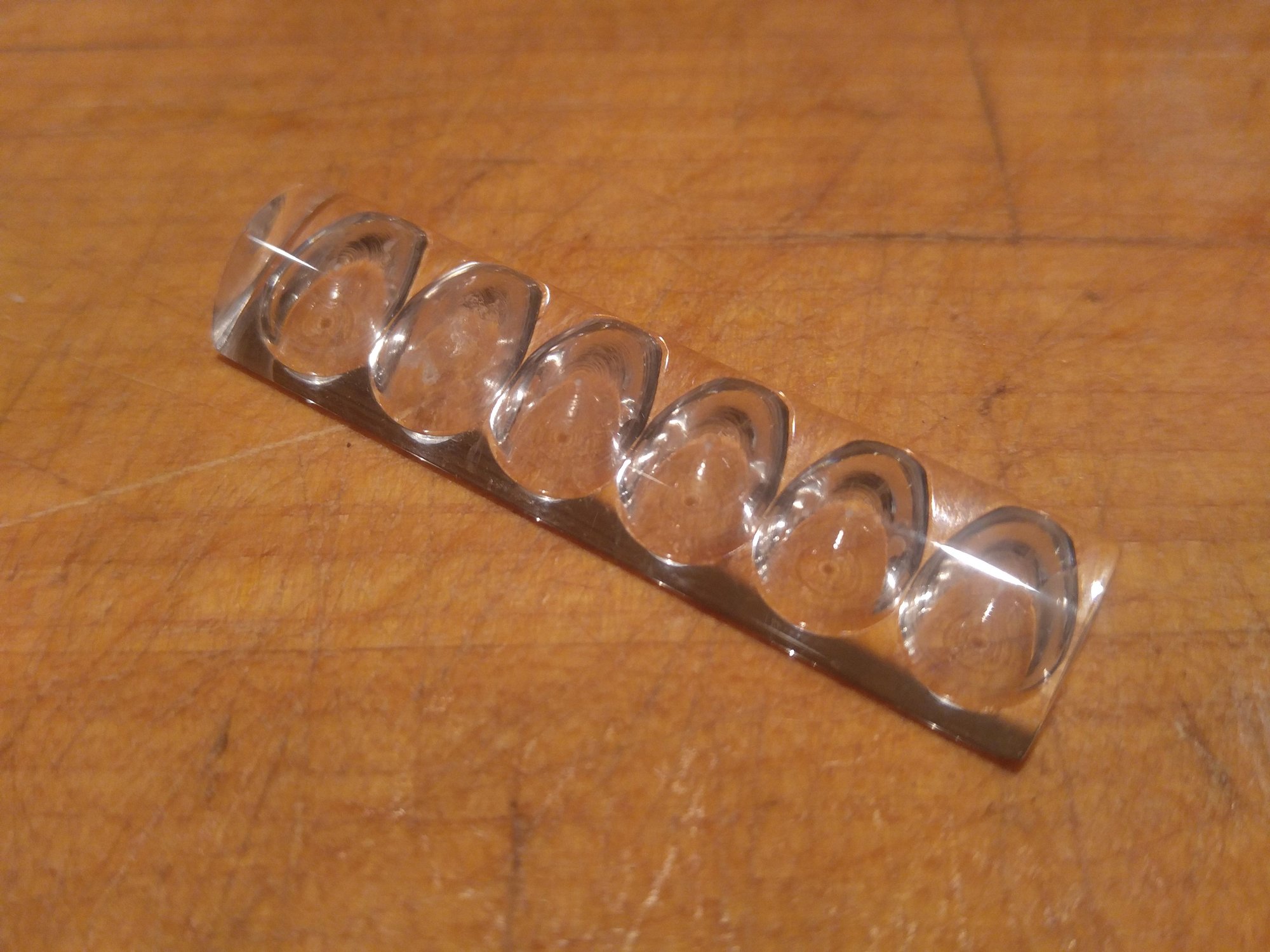

Decided to try another lens style. It doesn't really affect the appearance when off but the beam pattern gets SIGNIFICANTLY wider without losing any height. It's A LOT more work tho... I burned one of the divots trying to polish it...with a Q-tip in a Dremel @ 5k RPM. Need to think on it.
Thoughts, anybody?

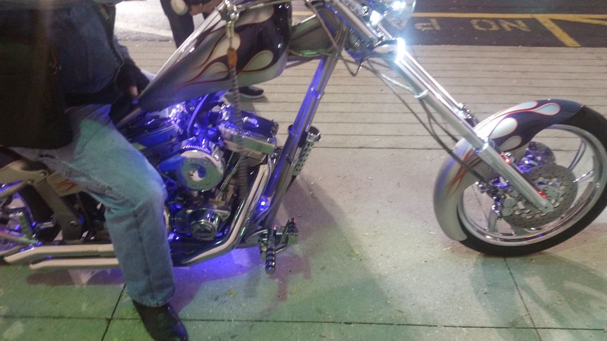

bumped into a guy with a mean custom that had a lcd gauge like yours, a serious full brembro brake setup, combo oil cooler/pressure guage, s&s bored to 118 dumping 150tq... evil bike:
