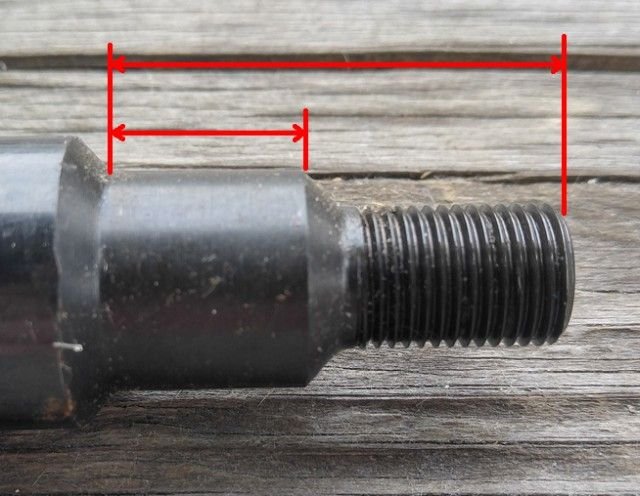

10.612"
0.963"
1.528"
0.642"
These two are bit rough because of the radius. Maybe +-0.010 to the start of the inside radius.
Here ya go! (Above)
I was surprised that the cap with the o-ring is the same diameter as the large end of the axle (1.120"). I was expecting it to be held in place by the o-ring only. (No, I haven't read the instructions yet. )

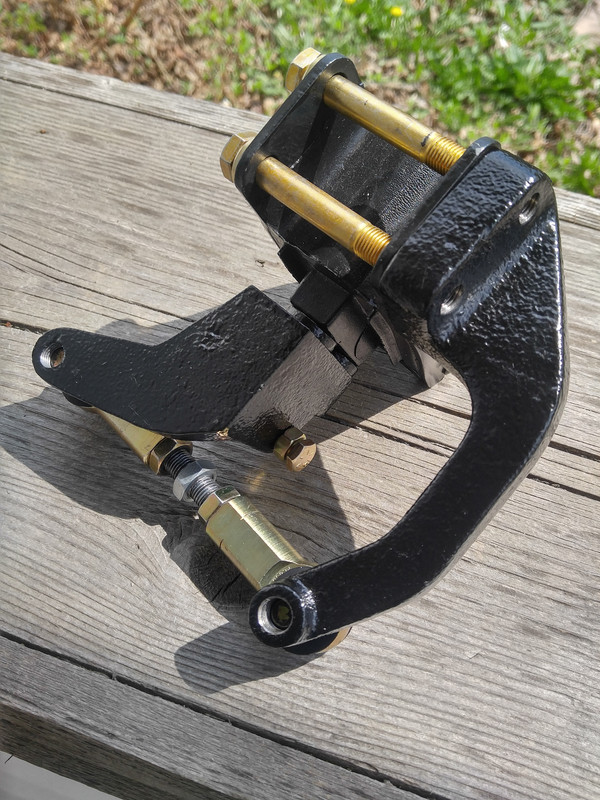

Got the Sputhe rear today. $239.00 cash COD included the $25 shipping (to me) and money order fee. (The post office makes out a money order and mails it to the sender.)
It's heavy. The black parts appear to be cast iron/steel.

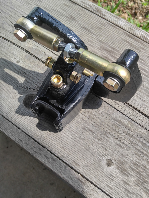

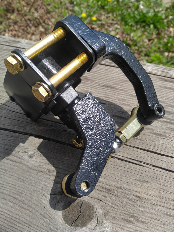

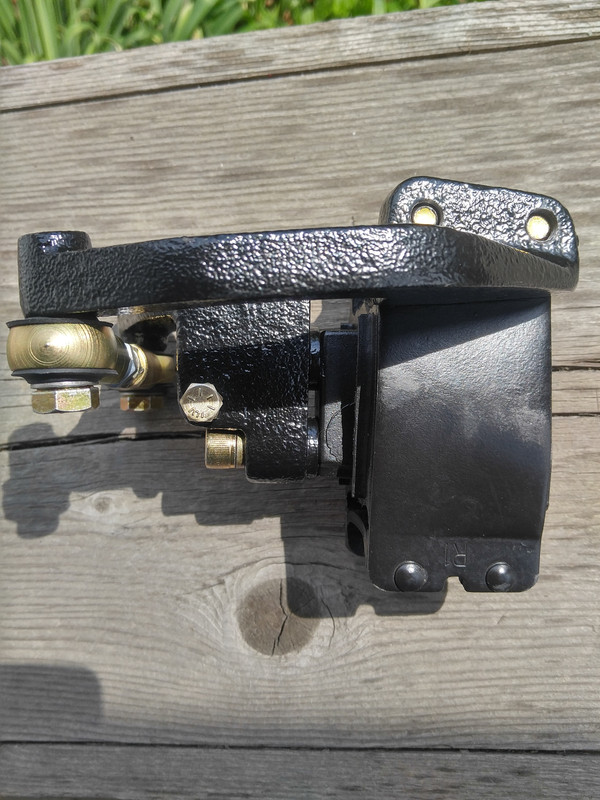

Sputhe rear stabilizer loosely assembled to new rear isolator.
Now....to replace the hardware with ARP or not...that is the question.
