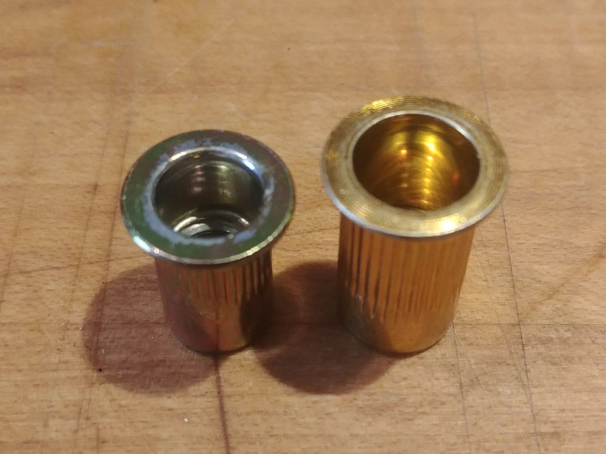

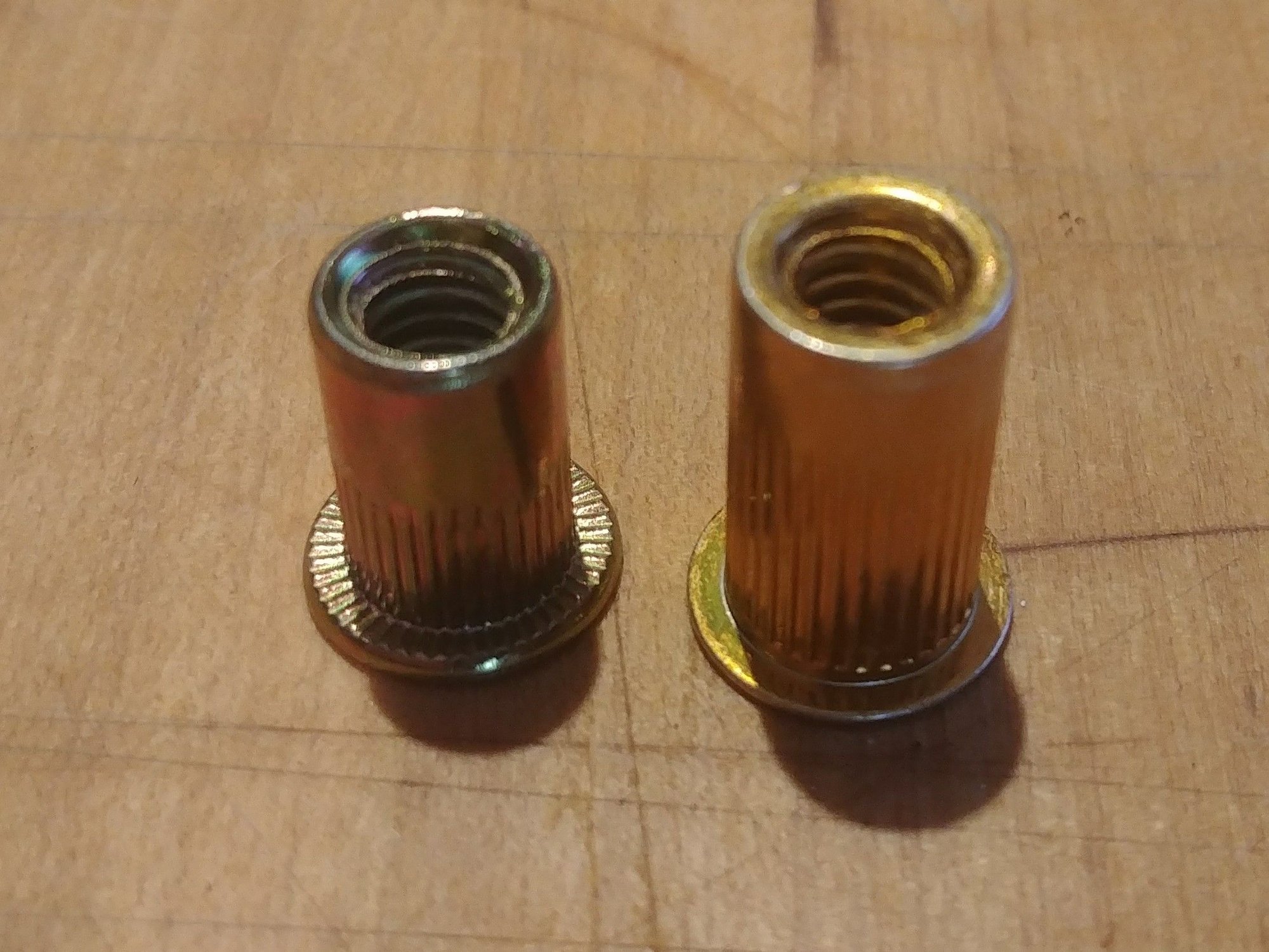

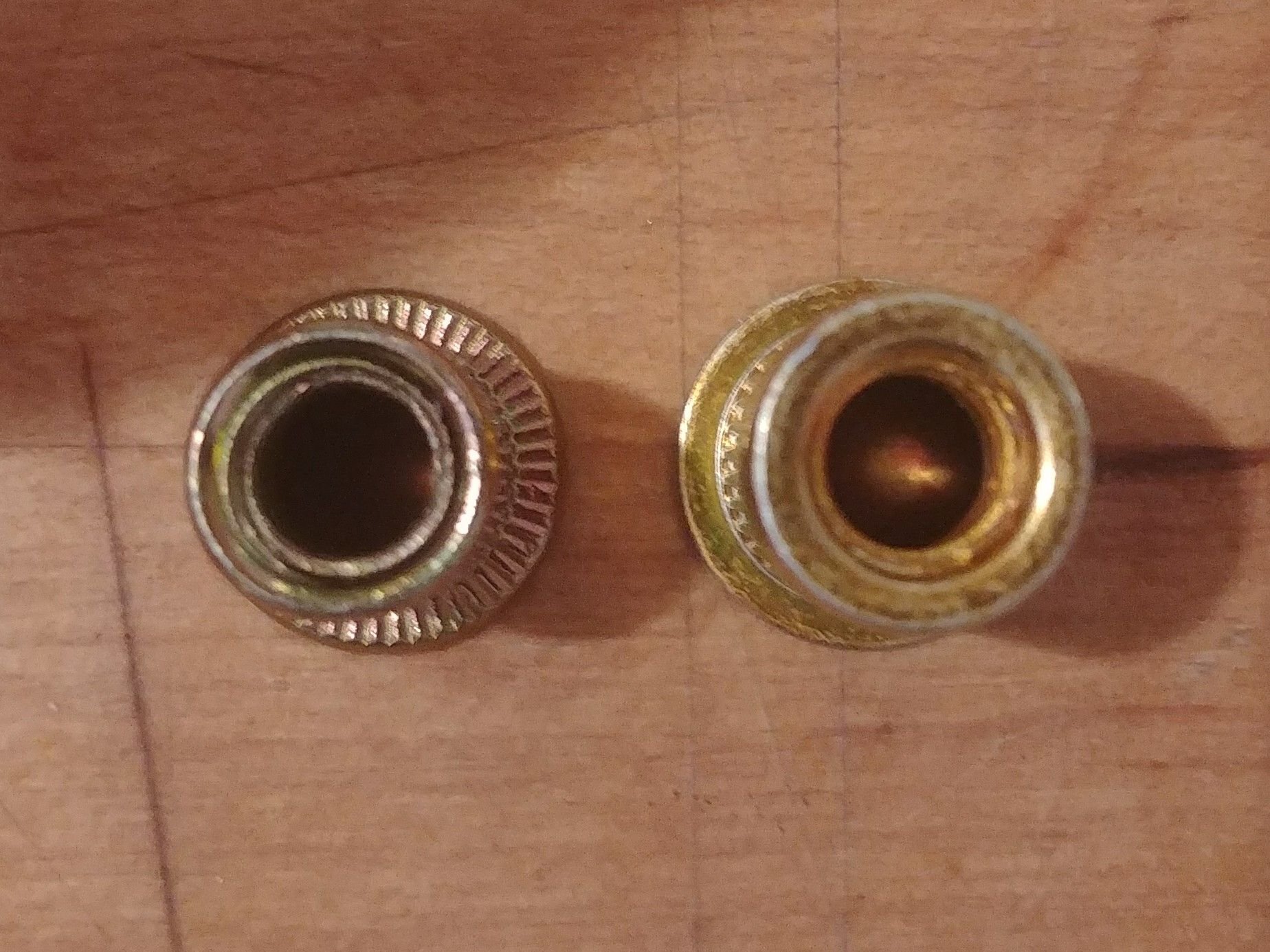

Had to order some different rivnuts since I'm going into thick material. These are good for 1/4". The ones that came with the setting tool are only good to about .156". Thought somebody might be interested in the differemce between budget Chinese rivnuts and US made...
The Chinese ones have a thinner plating, thinner wall, and looser thread fit. The features and machining precision are sharper on the US fastener. Chinese has less material overall...typical cost saving measure...
The flange on the US nut is notably thinner, but they are the thin flange version.
From Hanson Rivet via Amazon.
SKL250-20-260
None of this is to say the Chinese nuts are bad. They're just not top shelf.

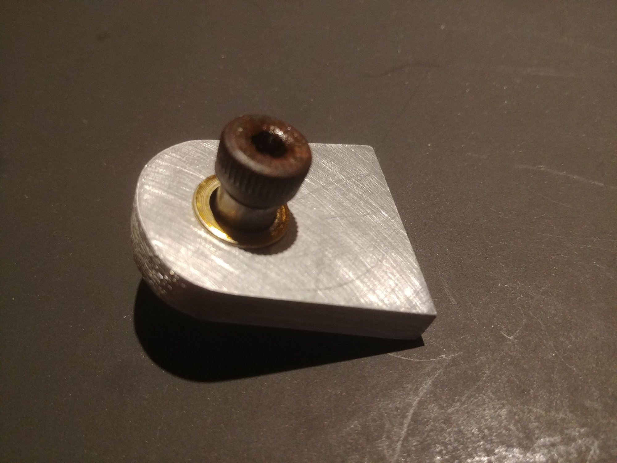

First test rivet. Looks good. I didn't bother to machine the counterbore for the flange. Didn't feel like changing over the tooling on the lathe tonight.
The 5/16 shoulder is a little sloppy in the nut counterbore but serves its purpose.
