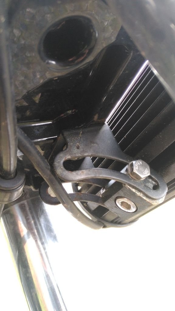

Old Apr 7, 2016 | 02:23 PM
kyleMB's Avatar
kyleMB
Joined: Aug 2015
Posts: 69
Likes: 19
From: Richmond
If you have a bottom mount headlight just drill the bracket out to the same size as the bolt holding the headlight
Old Apr 7, 2016 | 02:25 PM
kyleMB's Avatar
kyleMB
Joined: Aug 2015
Posts: 69
Likes: 19
From: Richmond
Sorry for the giant pics, not sure how to resize them
