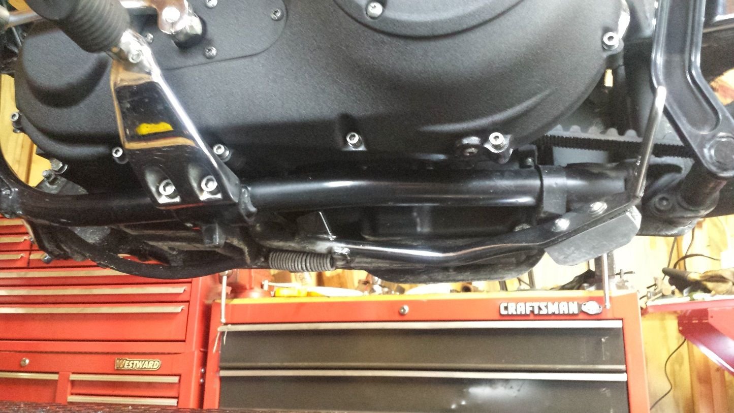

Another bung king block user here.

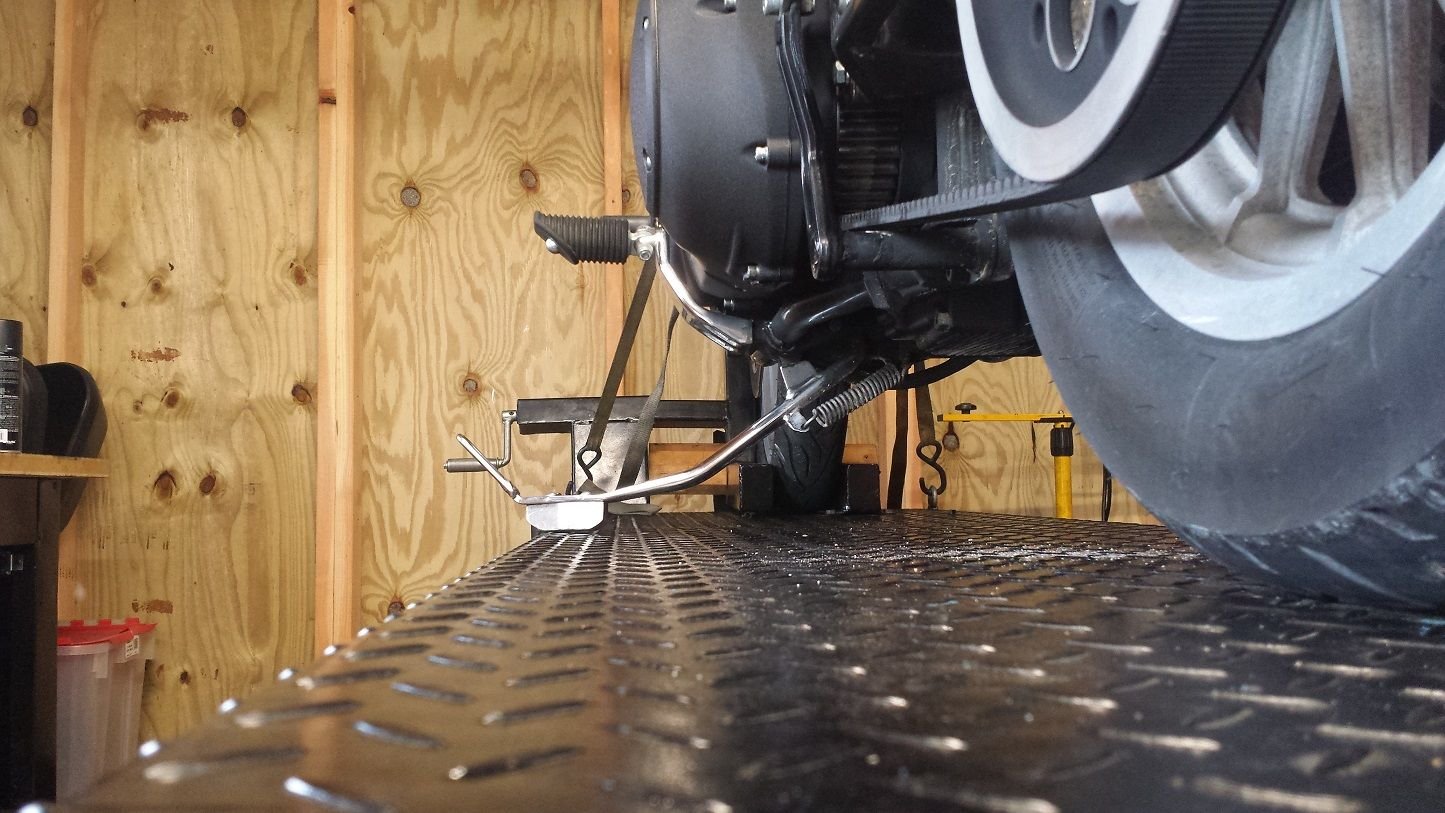

Looks like the block would work. The wife's Low Rider leaned too far over when I upgraded with slightly longer shocks. As izzyryder posted, I removed the jiffy stand and added a fraction of an inch to the tab. I also installed an oillite bushing in the pivot block. Bike rests at less angle and stand retracts so smooothly now...

Seems like the best answer has been ignored twice...
Originally Posted by izzyryder
Take the kickstand off the bike and have the resting tab welded to make it larger. This will decrease the lean of the bike.
