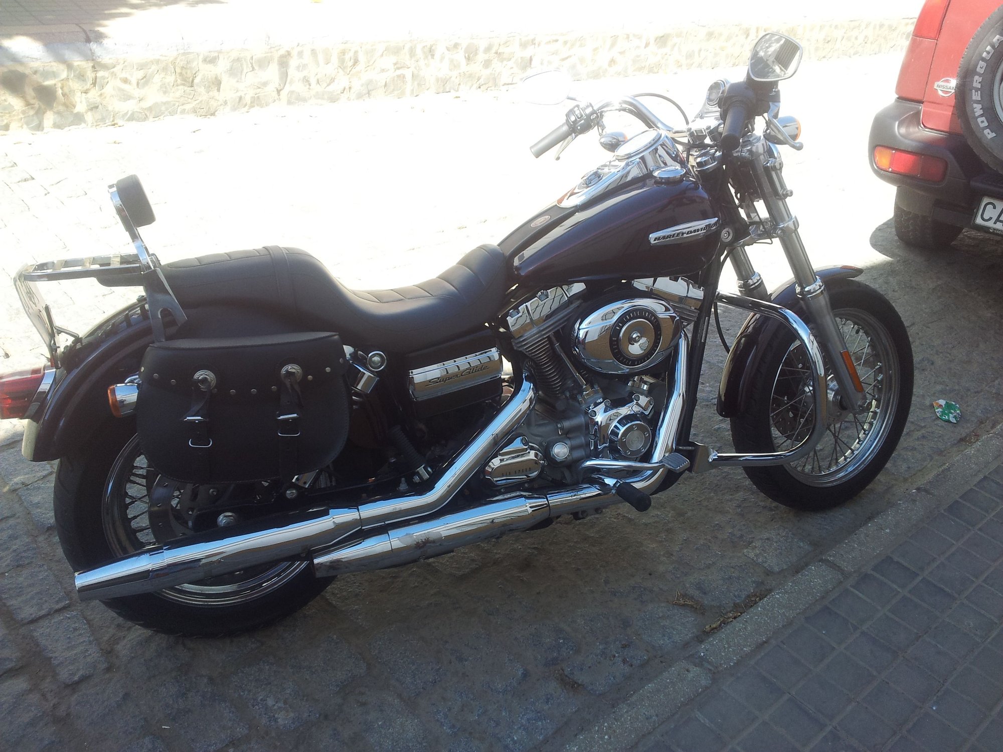

I painted mine with really good results, it was a 2007 FXDC with the silver/grey engine with cromed parts, the contrast really sucked, so i took a pair of high temp paint, tapped everything REALLY well and sprayed the hell out of it.
It holds really good as the engine temp cures the paint somehow, on some zones the paint wears off specially when cleaning the bike with high pressure water but i keep a spare paint can to touch up those parts, been like this for 2 years already.
Before and after.
