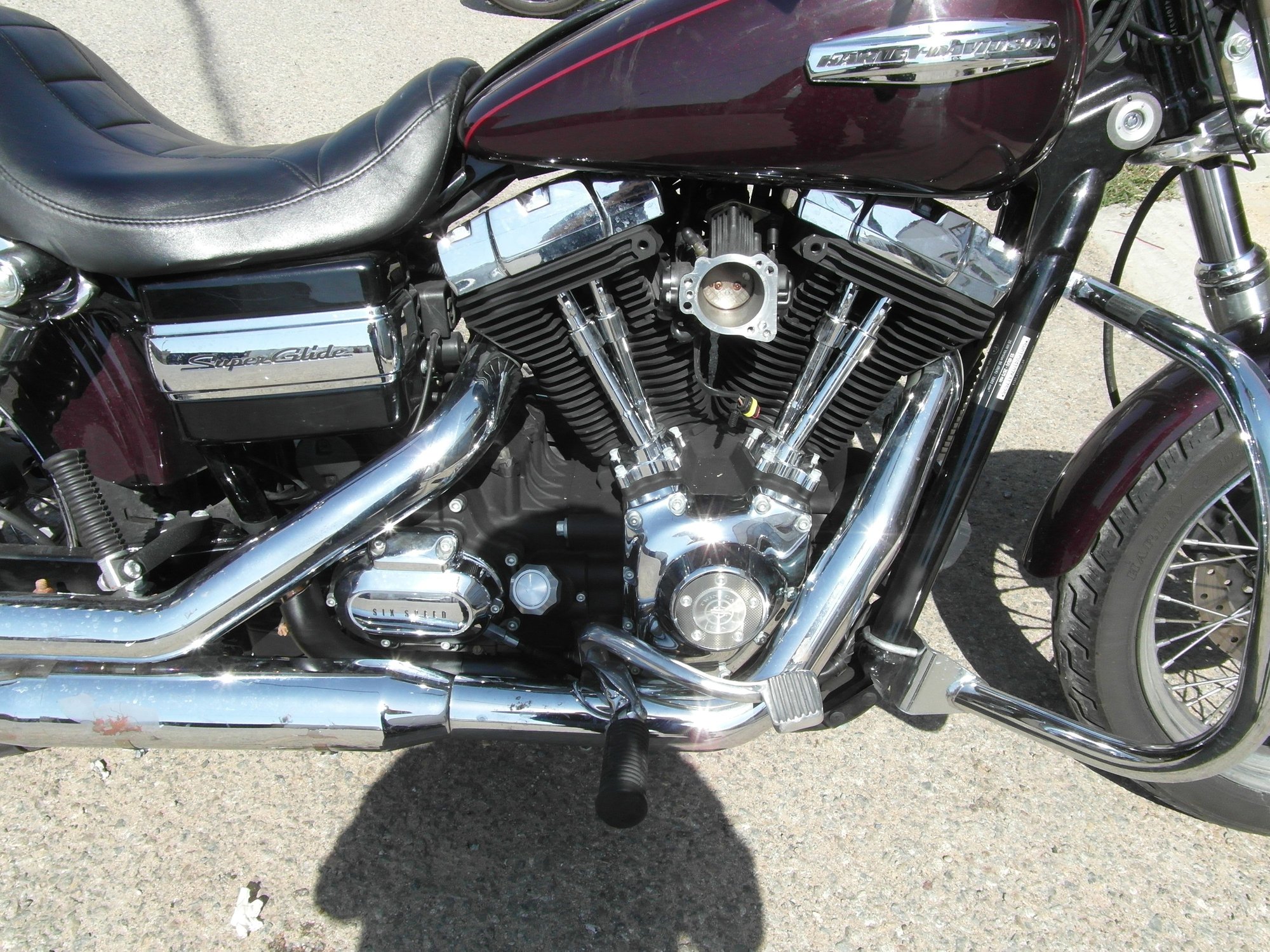

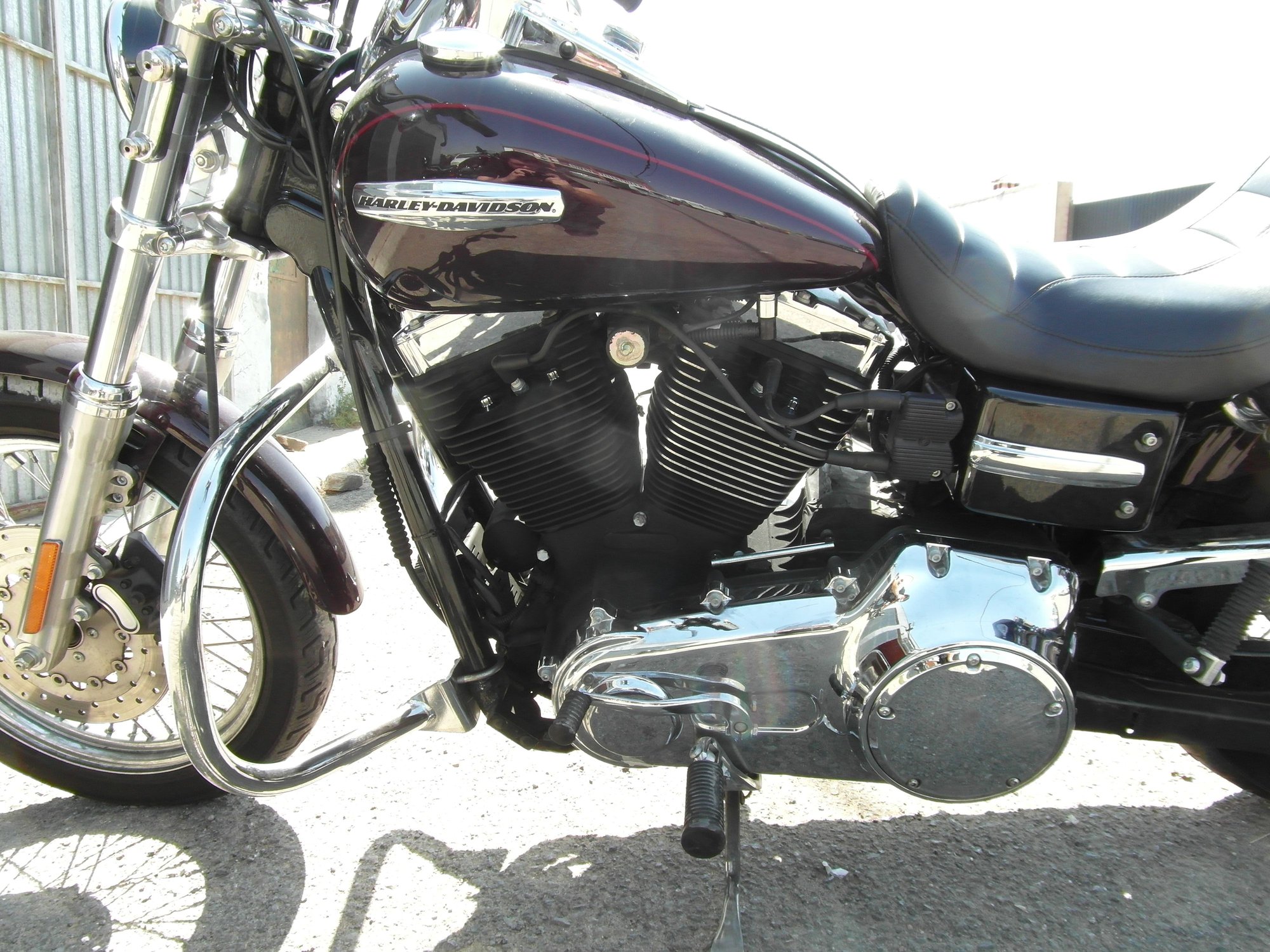

Originally Posted by Lambda
I painted mine with really good results, it was a 2007 FXDC with the silver/grey engine with cromed parts, the contrast really sucked, so i took a pair of high temp paint, tapped everything REALLY well and sprayed the hell out of it.
It holds really good as the engine temp cures the paint somehow, on some zones the paint wears off specially when cleaning the bike with high pressure water but i keep a spare paint can to touch up those parts, been like this for 2 years already.

Answering your questions.
1.- Nope, i didn't tape the fins, I painted the engine, then when the paint was dry with a cloth and dissolvent i took care of each film, that process took me almost 2 days.
2.- I went to a gas station and with a high pressure water gun i cleaned all the engine reaaaaally well, specially on areas where some oils drips or leaks, i had a small leak between the engine and the trans so that zone was well cleaned up. I didn't scrap anything since actually the textured finish is awesome for the paint to stick.
3.- One coat, two on some zones
4.- Duplicolor supertherm, the best black, heat resistant paint I ever used.
5.- I did not remove the pipes, just the air cleaner
6.- Taping everything took me a day, i even taped the bolts
Two pics of the process.
And thanks !
