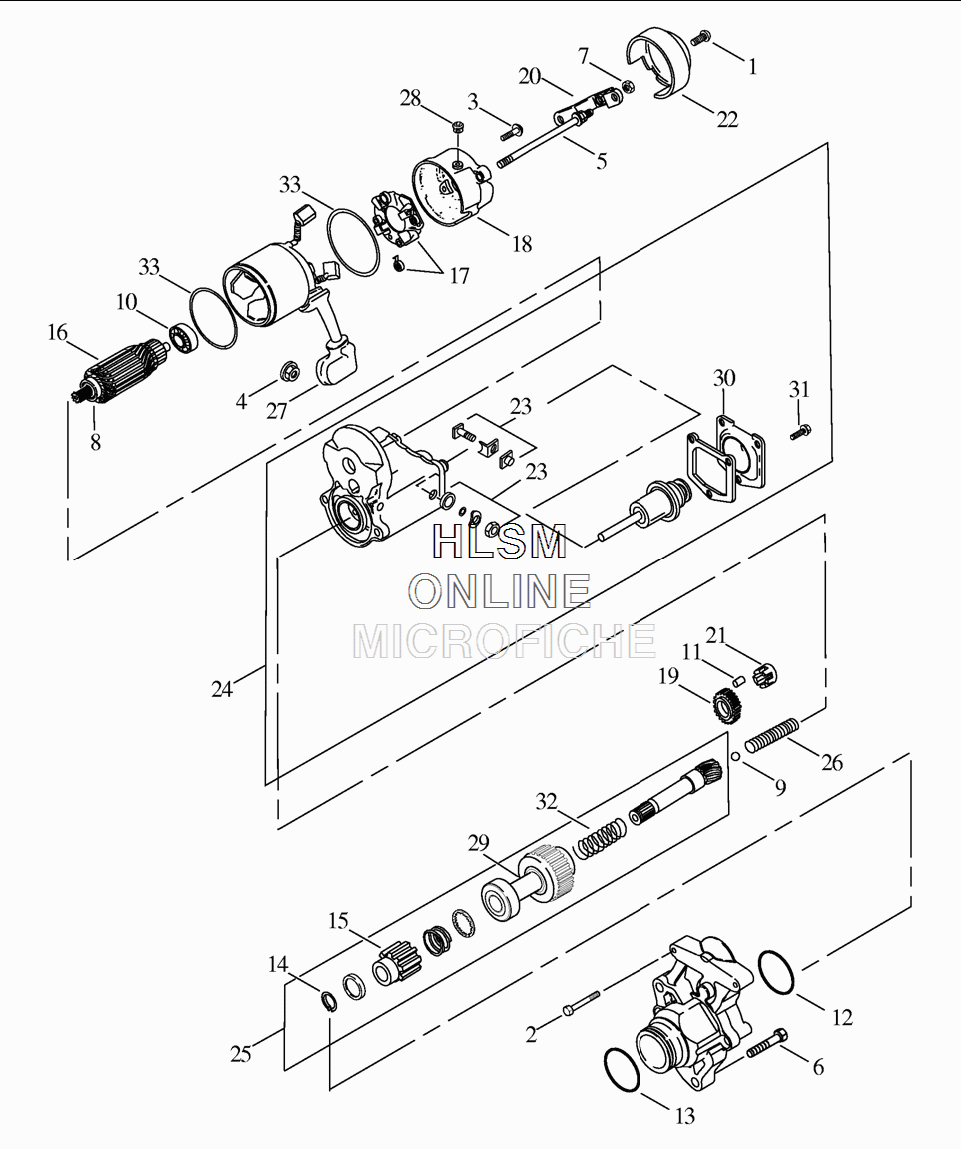

Thanks for the tips. I changed it yesterday and it starts much better. However, I do have to remove it today and install the o-ring that I did not see in the bag of parts. Ugh. Live and learn I guess. I looked at the microfiche on Ronnies HD page and there are two, with two different part numbers. One goes between the starter and inner primary and the other appears to be installed inside the housing before the clutch is inserted. If it is the one that is installed inside the housing, then the original must still be in place - just my guess that it would need to be pulled out and replaced.
Thoughts?

I changed out starter clutch not long ago, and that Item 12, (o ring), was not present when I opened starter motor.. The All ***** starter clutch I installed did not come with that o ring. I could'nt see where item 12 oring would go anyway, so I put everything back together without an item 12.... Kit only came with one oring, ( item 13, primary o ring)..
I saw the same parts diagram , and was a little confused,, I think there is a mistake in the parts diagram ... Double check things if you have to, but I dont think you will need to remove start motor...

O-ring #12 is inside of the starter housing. No need to replace it if you didn't remove it.

Thanks Tommy C - that was driving me nuts. Now back to my other forum posts for the new problem I have.
