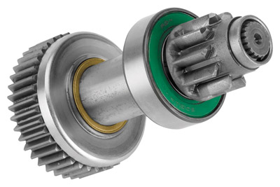

Originally Posted by RIPSAW
Front looks quite damaged in picture but that is not what is causing bang in the video. It sure has to be engaged to crank like that.
Peep this one from jpcycles
Old May 30, 2016 | 08:21 PM
  #52
OG1's Avatar
OG1
Posts: 897
Likes: 10
From: Oregon
you can't SEE anything wrong with a failed starter clutch. the issue is inside the gear itself as pictured above. change the damn thing and be done with it. matter of fact, I'm pretty sure on your year/model bike you could have changed the starter clutch without even opening the primary cover. the gasket and oil cost would have paid for the new starter clutch.
PS I STRONGLY recommend changing your transmission shifter shaft seal to a Cometic one while you have the inner primary off. the OEM are notorious for leaking and your right there. Its a real PITA to tear it back down to change that $3 seal.

Little update, i ordered a bunch of parts online and they all came in except for starter clutch.
So while I don't have a fix yet, I took the starter clutch out of the starter and the big gear in the middle does not feel right...I don't have the new one to compare it to, but it slides up and down the shaft with a little force...so I'm really hoping this is the cause of this.
