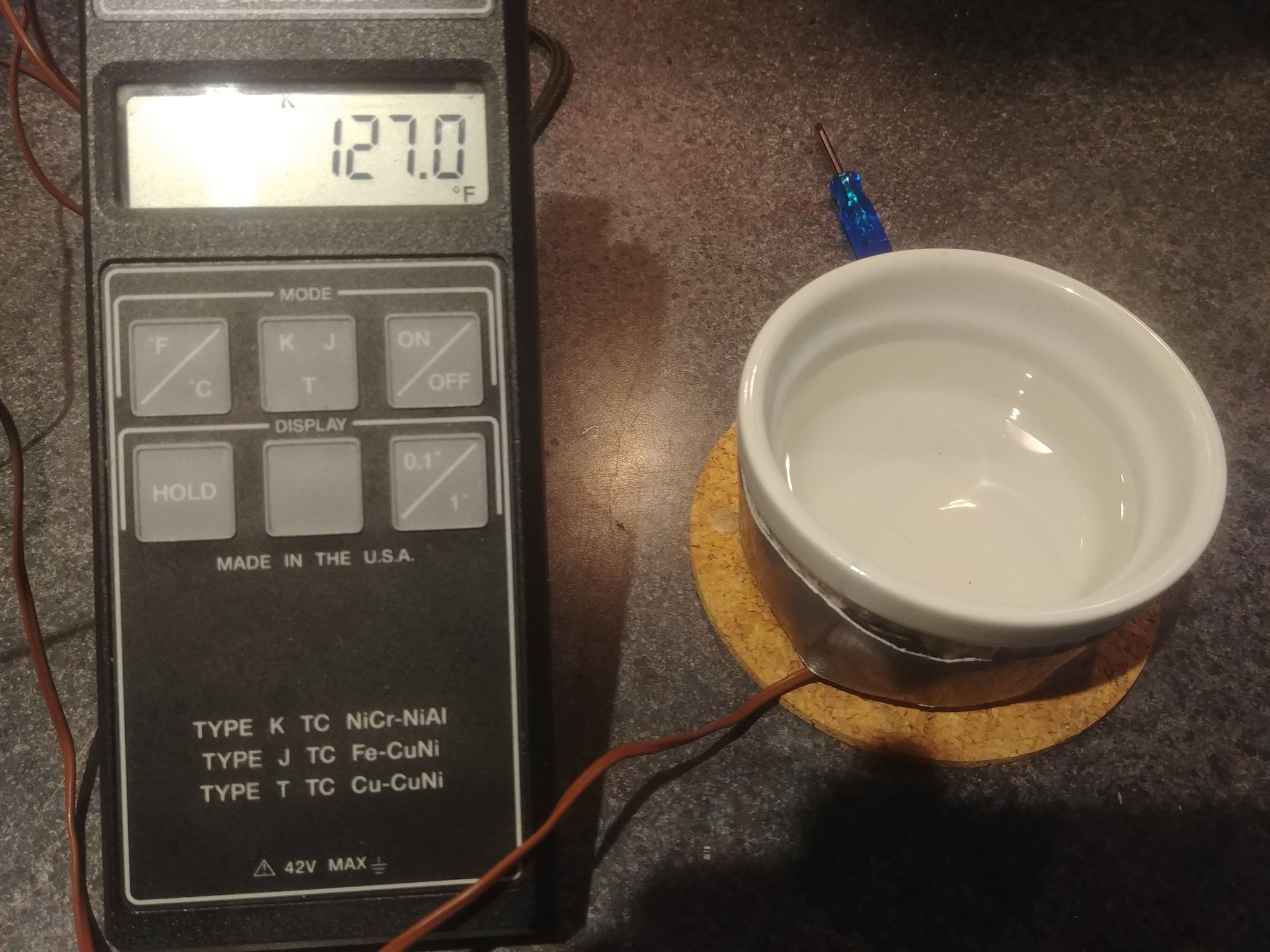

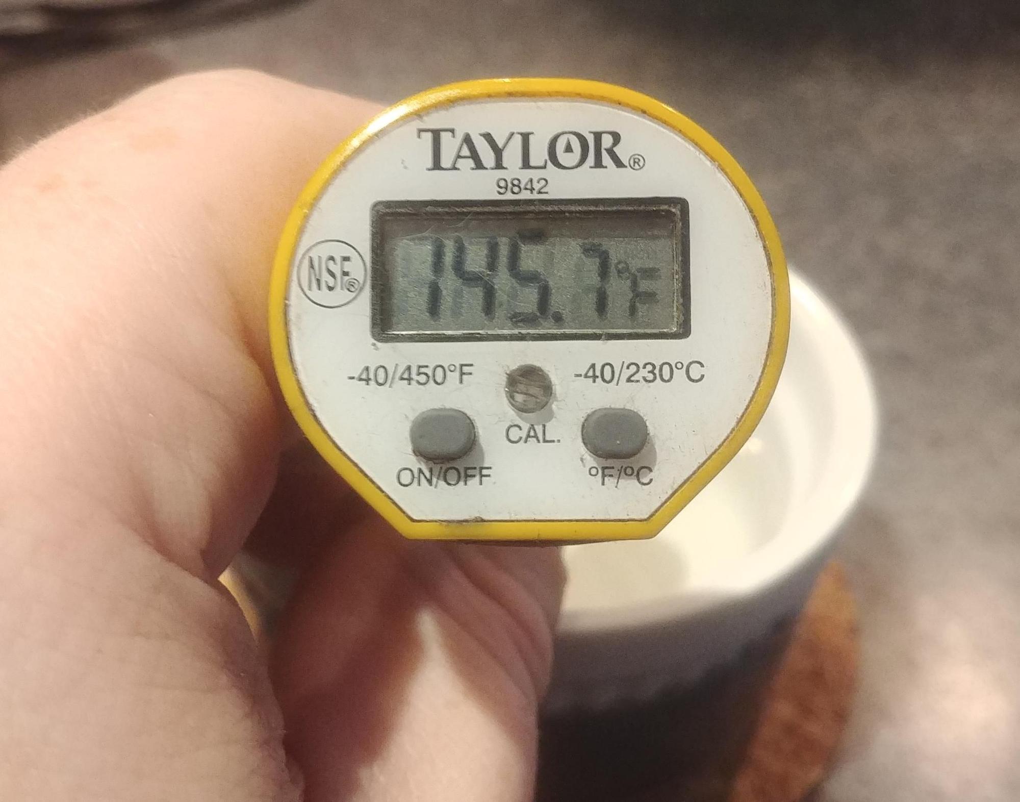

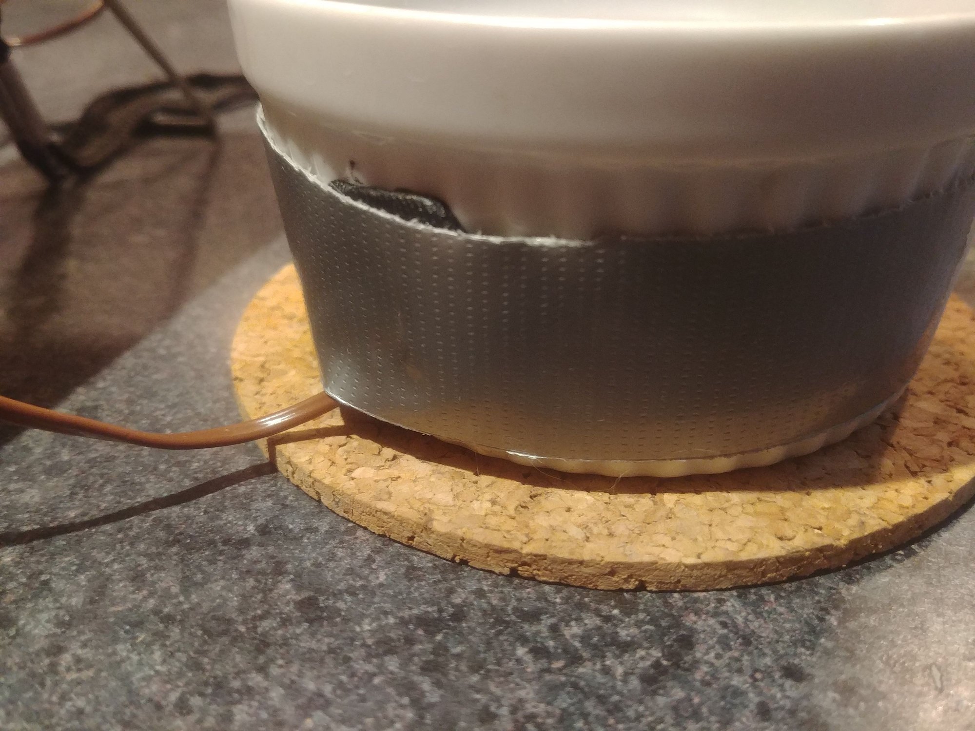

Here's a quick example using some stuff I had lying around. Hot water in a heavy ceramic bowl.
Hand soldered Type K thermocouple wire/contact.
Water temp
A bit of butyl rubber and duck tape holding the contact in place. (The butyl was too soft by itself)
Thermocouple reading, surface of cup.
Flir One Pro, to verify/corroborate.
OMG! Shouldn't you be working on your bike!
Now, all I need is a cool looking oil temp gauge that mates to a K-type probe...
That thing's tiny enough to just stick it in the oil gallery somewhere.
