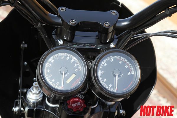

Hey guys I've been doing a lot of research lately on my new 99 FXDX project. I'm wanting to go with a set of T bars or riser kit with MX bars. With doing that can you guys help me out with what all parts I need to relocate the gauges to the front side like the pictures below. I don't want them sticking above my fairing.

Easy enough. Accutronix t bar clamp (or other brands) for stock gauge cups. You'll need to "massage" the cups to allow you to 180 the gauges - the cutout for the wires mostly. The idiot lights can also be flipped by driving one hole for the key pin.

Yes there are aftermarket clamps. LA Choppers clamp is about $50 and does the same. Lucky Daves, Accutronix, Westcoast T-bars: pick one that you like.
I use the LA choppers because it clips BETWEEN the risers and not around. A lot cleaner look, almost invisible. You can raise and lower the gauges to your liking, or flip them to the inside of the bars like your picture. They all do the same thing, just different piece points and slightly different looks.

This is exactly how I want to do my gauges on my FXLRS. Any update on something that worked? I am looking at Biltwell angled O/S riser clamps, figured I could flip them and make it happen as long as they're drilled all the way through.
Otherwise, can the speedometer be rotated in the housing if I flip the bracket? Looking to mount them to the risthe themselves as I want to run straight t bars without a top clamp.
