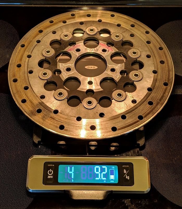

Okay, brake rotors are weighed. I used a handy kitchen scale by OXO, from Bed, Bath & Beyond. About $50, before any kind of coupon. It works very nicely, and has a detachable panel so that you can read it with larger items sitting on the scale (like brake rotors), but maxes out at eleven pounds.
First, a size comparison. New 13" rotor is on the bottom, HD 11.5" rotor on the top, centered:
Another comparison, this time aligned on one edge:
Left side HD rotor:
Right side HD rotor (note the half once difference):
Left side BrakeTech rotor:
Right side BrakeTech... EXACTLY the same weight:
Here are both HD rotors:
And both BrakeTech rotors:
So, here are the results: A combined total of three additional inches of rotor diameter, and an unsprung weight reduction 2.3 ounces shy of two pounds.

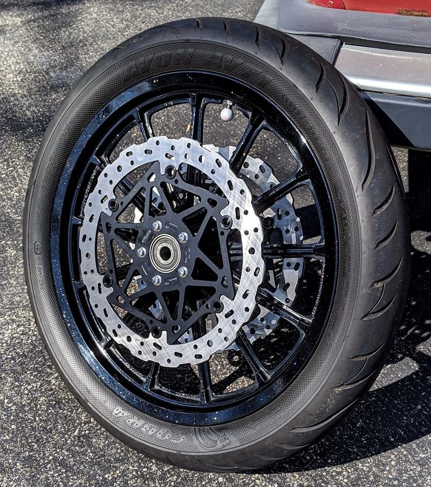

And a quick side-by-side, sitting on the front wheel:
Now I really need to figure out where on earth I put the ARP rotor hardware I got from Alloy Boltz last year... It's unbelievable how good at losing things I am.

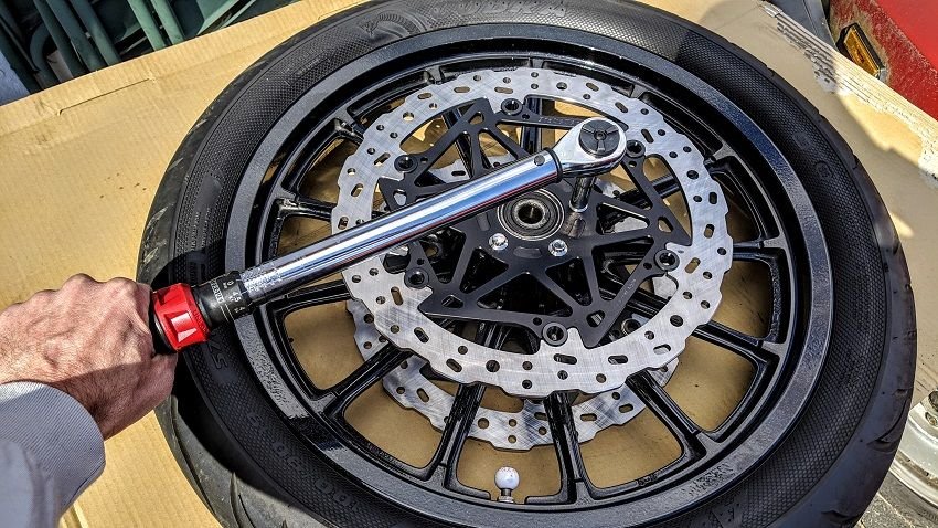

Bolted the new rotors onto the front wheel today. I ran a thread restorer through each hole (a bunch of old Loctite came out), cleaned and waxed the wheel while everything was accessible, and torqued them on using new polished ARP hardware. I called Jeff at BrakeTech with a quick install question first... Since there are six bobbins on each rotor but only five bolts, I had several options in terms of left to right alignment between the two rotors. I wasn't sure whether the "waves" should be offset or line up with each other. He explained that the "pockets" are shallow enough (5mm) that the rotors behave like a round disk. They're really just pocketed for weight reduction. Totally up to me how I line them up. I decided to line them up with each other, assuming it would bug me if they were asymmetrical for no functional reason.
In case anyone out there is obsessed with minor weight details, I put the old Harley chrome bolts on the scale, and the new ARP stainless set... With all ten bolts on the scale, the HD set was actually .4 oz lighter than the new ones. Oh well, can't win every time!
