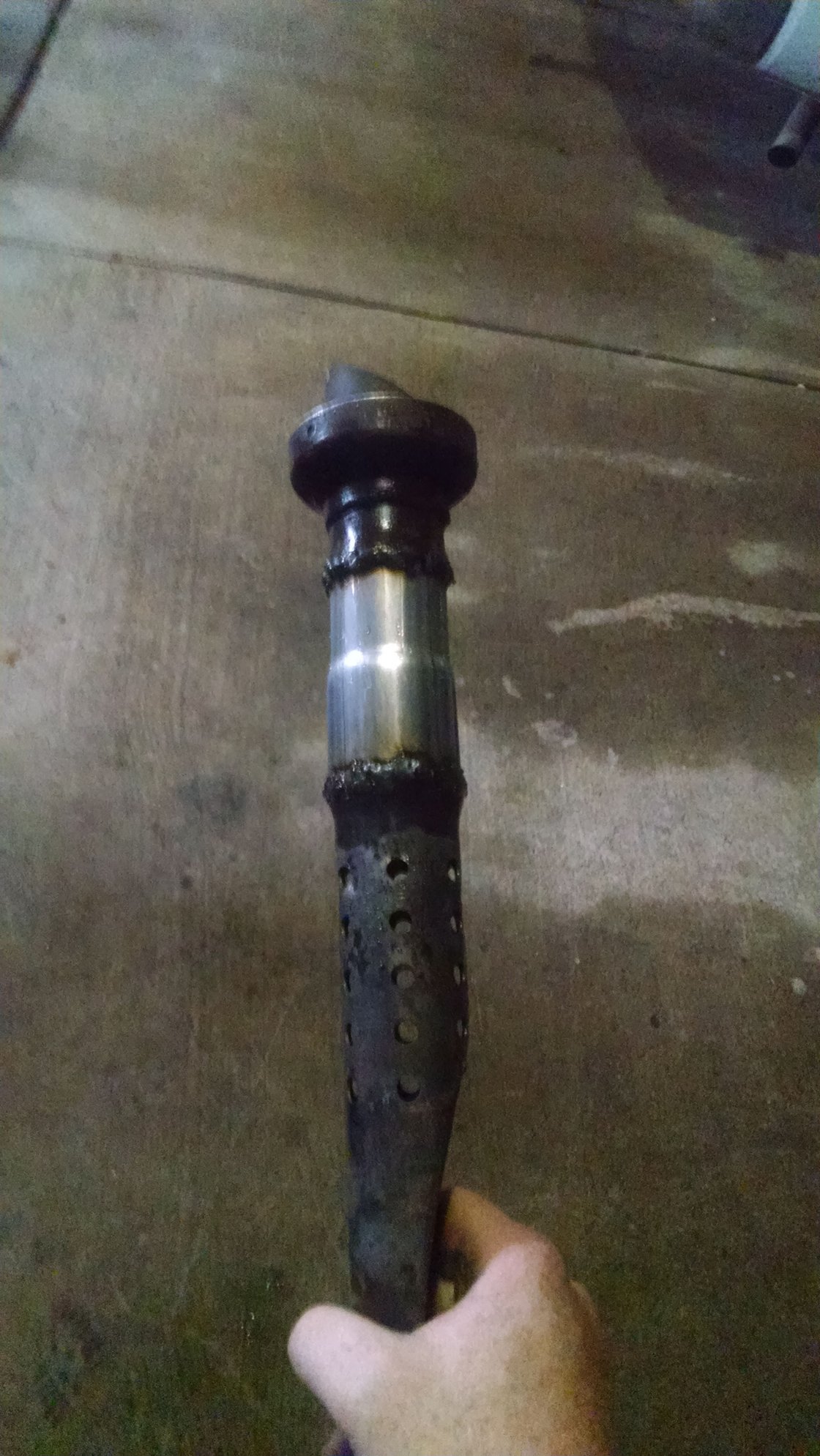

Ok I got an update. Took the mufflers off, removed the screws at the tail
Pipe end. Used a pipe and banged the baffle out from the header side. To my surprise, the baffle was not very exotic at all, and the cat is completely enclosed in the baffle insert. That's all then wrapped in packing. So, since the wife wants a little more growl and not obnoxious loud, I just removed the packing and drilled two 3/8" holes on the baffle near the part that's bent in like an organ pipe. Left the cat alone. Just trying to do smaller, reversible if needed, changes.
I happened to throw my back out earlier so I can't ride, but just at idle she sounds a little less bottled up. She had such an odd sound when you really get into it - just reminded me of an old Honda 350 I restored.

Forgot the pic
Attached Thumbnails 2015 stree bob w/ SE slip ons mod...-photo813.jpg
