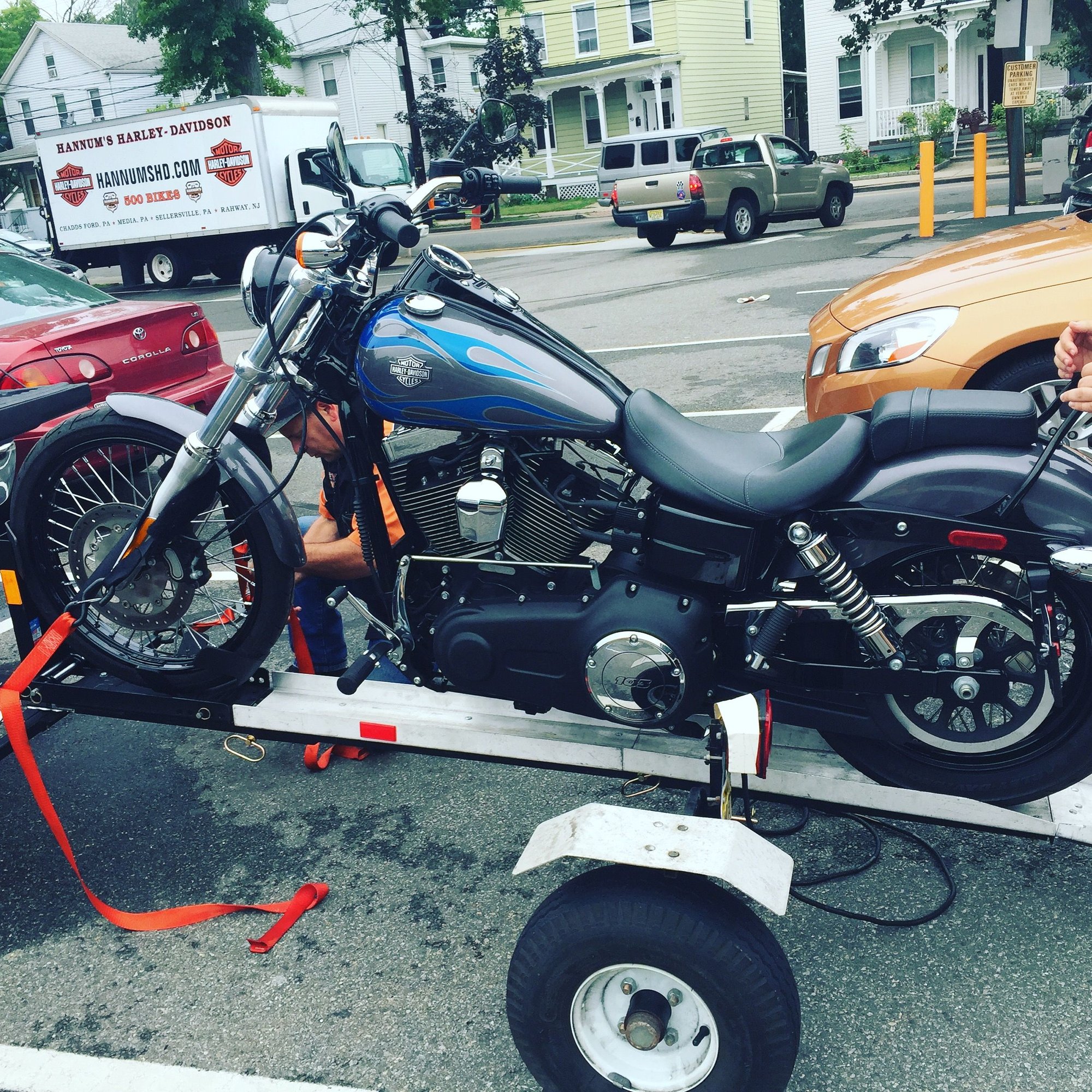

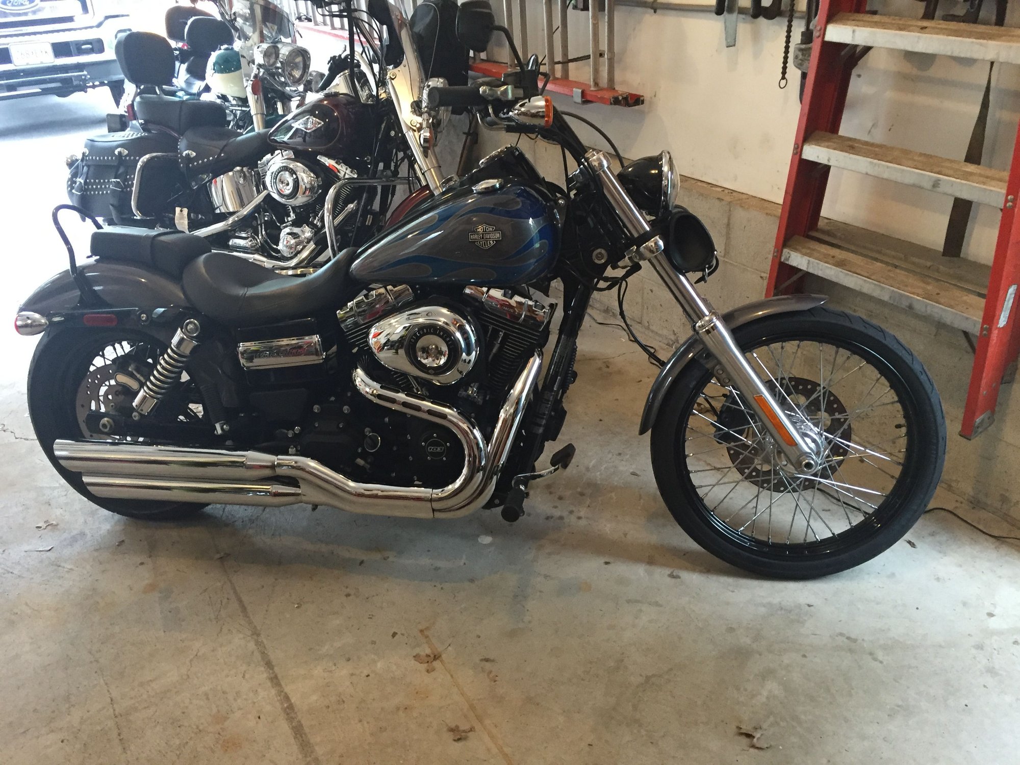

Hello everyone, I just picked up this 2014 wide glide yesturday and love everything about it. The only thing is im a little on the short side, so my legs rub up on the air filter on the right side and the horn on the left side. Is there a kit out there that could kick the pegs out to the side and/or closer to the back? thanks.

You can install mid pegs that might help if the interference occurs below your knee. If they hit at your knee, as mine did, moving peg location probably won't help.
Personally, I feel the only good solution is to delete or relocate the horn to the cross brace in front of the engine and switch to a sidewinder style air cleaner.
Depending on just how much room you need, you might be able to get by with just removing the stock air cleaner cover. I'm kinda leggy and that still didn't help me.
I couldn't be happier with having my knee room returned and equal on both sides.
There are fancier and more expensive options, but DK Customs sells a nice air cleaner setup and a low profile horn kit with wire extensions.

I had the bike out for a good 4 hours today. I am stepping up from a sportster to a wide glide. and the sportster was a little more narrow so you really didnt touch the sides. During that 4 hour ride I started to get more comfortable. I guess it may just need to readjust to the step up of the bike. I see that Harley offers a reach foward seat. Says 3" closer to the front and 1" closer to the ground. I probably will start that route on getting a new seat before I start messing with the pegs. My sporster had mid controls and I put foward controls on it. I love the foward controls much better.
