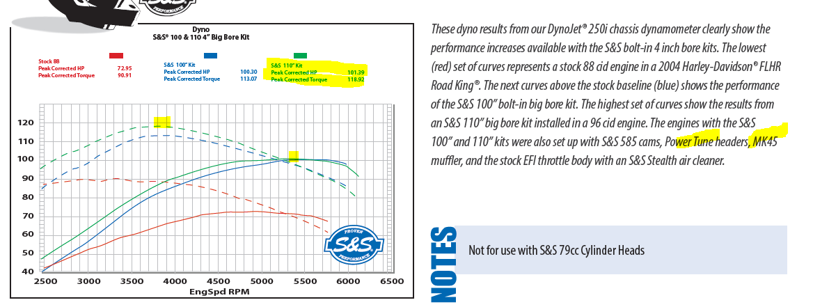

Originally Posted by HDConvert511
What were the dyno results?
still waiting on them.... i'm currently bikeless. both bikes are in for dyno. the dealer sucks... seriously. they've had it since tuesday and it was supposed to be done yesterday. was not done.... not even today. i'm on business travel next week so i just dropped off the other bike. hopefully they can get them done by friday of next week. if not... i'm picking them both up and taking them to panama city.
i found where you hid yours: https://www.hdforums.com/forum/dyno-...i-rr-mega.html
looking at your dyno, mine will more than likely look just like yours since this is what s&s claims with the exception of their exhaust system.... honestly, mine may be lower, i messed with the formula... i subbed in .030 head gaskets and 89cc heads for no good reason.:
yours:

From: Inland NW
Those bastards! Yeah, that curve on the S&S sheet looks damn near identical! I hope you are happy with it. The tune alone made me smile. She was super fat off-idle to 2900, now it is very responsive and kicks in like one of my old big-bore 2-strokes right a 3000. I tried to post my dyno video, but apparently we cannot embed vids on this forum. I am uploading to a public photobucket folder, now.
