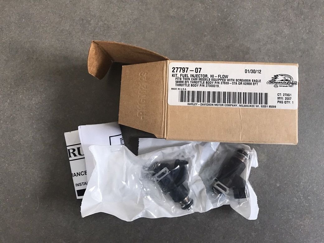

Scored some NIB 27797-07 4.9g/s SE injectors for $30, was originally going to buy 27796-08 5.3g/s but, those were for 58mm oval TBs.
$100 saved... still creeping on the rest. looks like the S&S 58mm stealth for cable is out there but, i'm pinching pennies because i'me feeding two HD children a similar meal so i have to do this twice. found a 58mm stealth for $150 but, haven't bought it because it says it is for FBW throttle bodies... any ideas on the differences between the FBW and Cable backplates?

I've been given the impression that if it fits the FBW it will fit the cable TB, but not necessarily the other way around.
