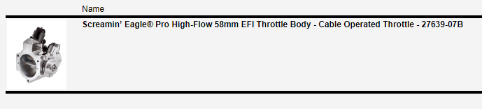

Finally ordered the TB after discovering that there were alreadey a slew of 58mm air cleaners out there, trying to track down which bikes have been using them.
"Fits '16-later FXDLS and SoftailŽ, '14-later CVO™ SoftailŽ and '14-'16 Touring and Trike models equipped with Screamin' EagleŽ 58mm Throttle Body. Requires separate purchase of an Accessory Air Cleaner Cover. All EFI models require ECM calibration for proper installation. '17-later models require recalibration with Screamin' EagleŽ Pro Street Tuner (sold separately). Labor cost not included. See Dealer for details."
i stumbled across a SE 58mm 29000029 (black) on ebay for $50 and 29000080 (chrome) after looking at the instructions here:
https://serviceinfo.harley-davidson....8?locale=en_US
most sites like board tracker and surdyke sell them for ~$55, the the ebay seller can keep his $50 unit. so a build my own setup, based on the plate, is an option. fun times.
some work ahead trying to find an A/C s&S is who i want to go with but no dice on getting a clear fitment response.... it looks like the the throttle hog bolt pattern is A shape and the SE bolt pattern is a V shape. the larger stealth A/Cs all say they are made for the throttle hog throttle body and no one at s&s was available to clear this up. fun times.
The 58mm manifold arrived too:
huge

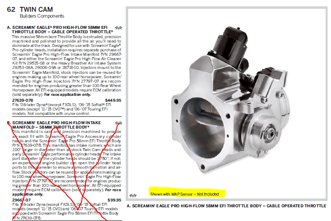

58mm (27639-07b) throttle body appeared
This thing is huge and weighs a ton too. (get out of the gutter)
looks like Reindeer was 100% right. HD is wrong about their own shi*, again. MAP sensor and all others, are included.

Do the SE 58mm and the S&S 58mm use the same AC bolt pattern? For some reason I though they were different. Could be wrong though. I guess you'll find out soon.

Me too. Changing the throttle body assumes it's the bottleneck in the system, which with the heads used it probably is. The factory 46mm looks positively tiny compared to the 58mm.
