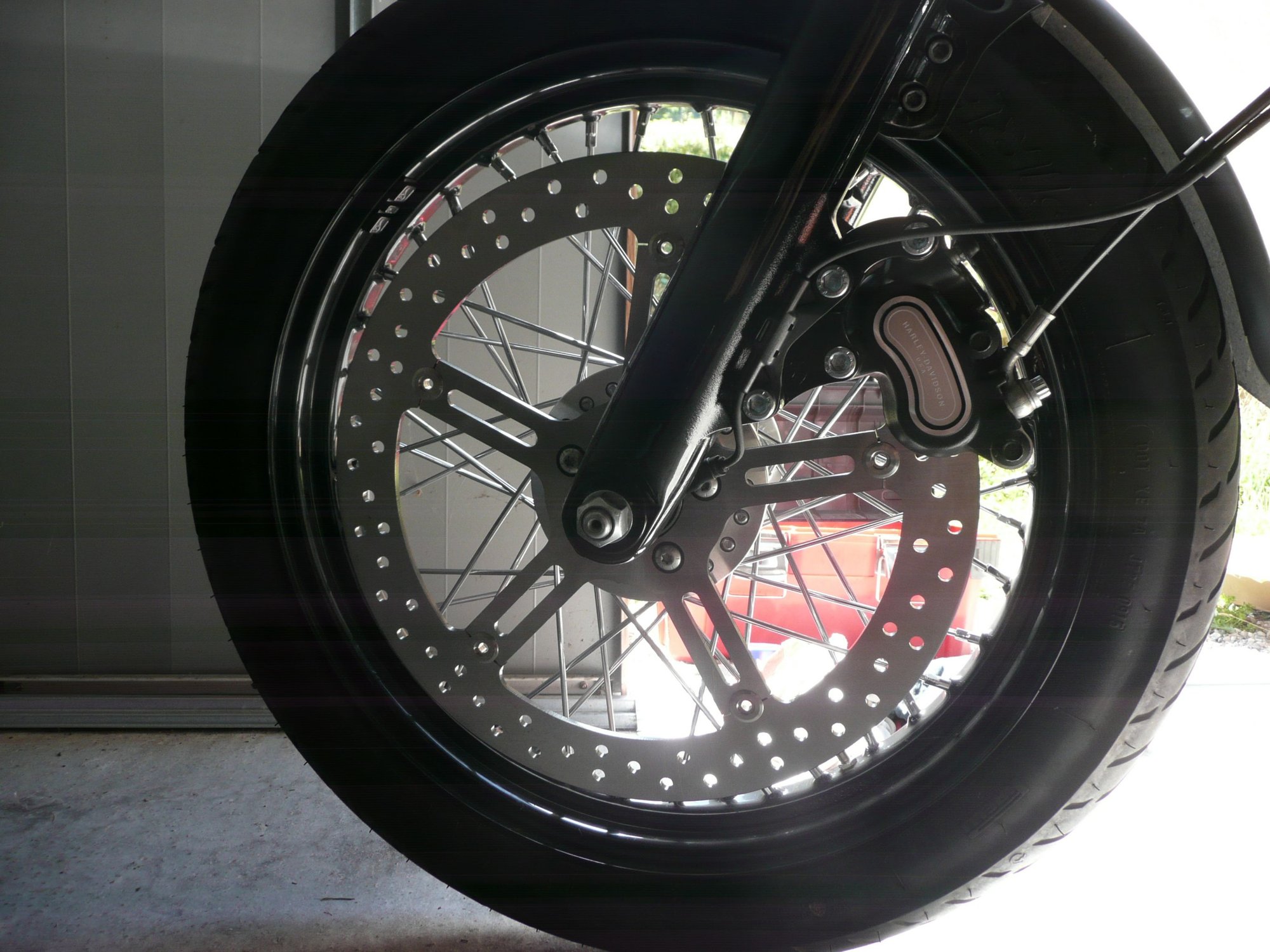

Thanks TinCupChalice ! I removed my caliper bracket and this is the correct one 02-972-1.
Could you post a pic to see were did the pads run on the disc ? They seems to be a bit toward the outer edge...

I don't know if you can see it in this image but at the very outer edge of the rotor there's a 3mm shiny ring where the pads don't touch; on the stock rotor that outer ring was a bit larger, perhaps 5 - 6mm.

Since i didn't run the bike yet with the new setup, I can't tell precisly but It seems a bit more toward the outer edge... strange. Ordered kit #02-972 and got 02-972-1 bracket so everything should be good for my '14 Bob ? Or maybe I'm just loosing my mind lol !
