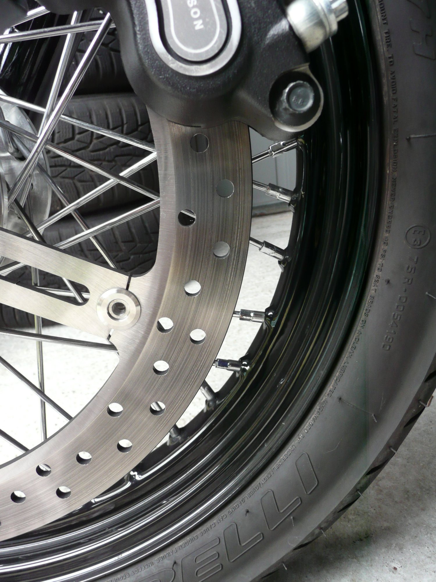

Sourced the right screws in 12.9 with the zinc plated finish few days ago and tested the kit for a few days trip : braking power is awesome !! Feeling is just perfect, not brutal or too soft, and you have a good feedback on the lever.
The brake pad track on the rotor is a bit more toward the outer, but there is indeed 2-3mm left before the end of the disc so that's normal.

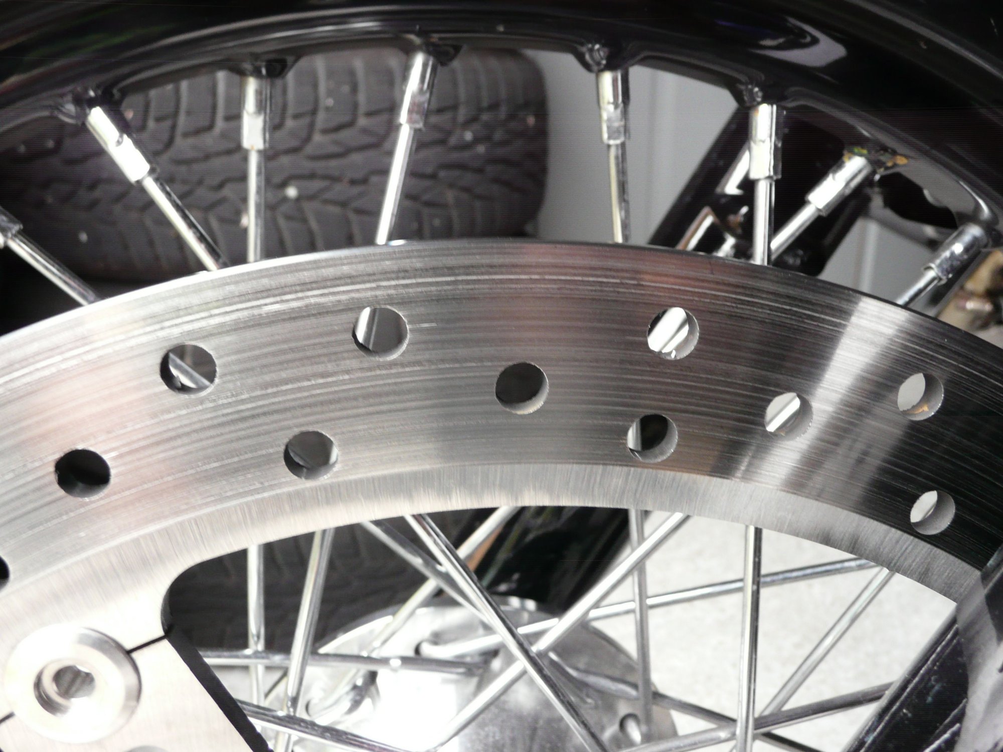

maybe i'm paranoid but their is no untouched area on the outer edge of the disc !!

That is out a bit further than my Big Brake rotor; I've got about a 3mm ring around the outside of the rotor where the pads don't touch.
What brake pads are you using? I installed new Lyndall Gold+ pads when I installed the Big Brake rotor. I wonder if it's a difference in the brake pads...
