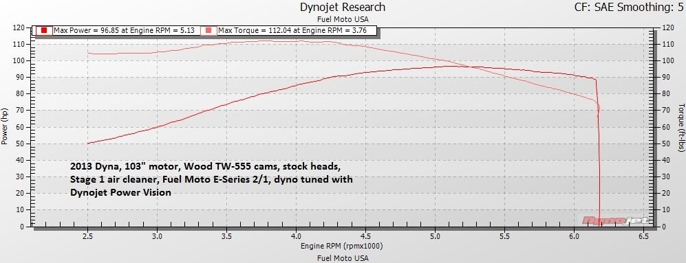

Here is what I'm going with and keeping the heads and pistons stock with the exception of a .030 head gasket. Good enough for me.
Respectable numbers there... I am at the Verrrrry early stages of cam selection, and the 555 is one I will be looking at. How do you like it?
I'm waiting till winter to do the cam. Just got the bike on the street two weeks ago from the initial mods. On the motor I just have the AC, Dyna 2 into 1, and Power Vision. Just with the stage one it is a completely different bike and tracks the E-Moto numbers as to those mods. I'm putting my trust in the cams. That said, the 555's with my stage 1 is proven setup that would make me happy. I'm sure the are a hundred opinions out there, but this is mine.
Very Nice
