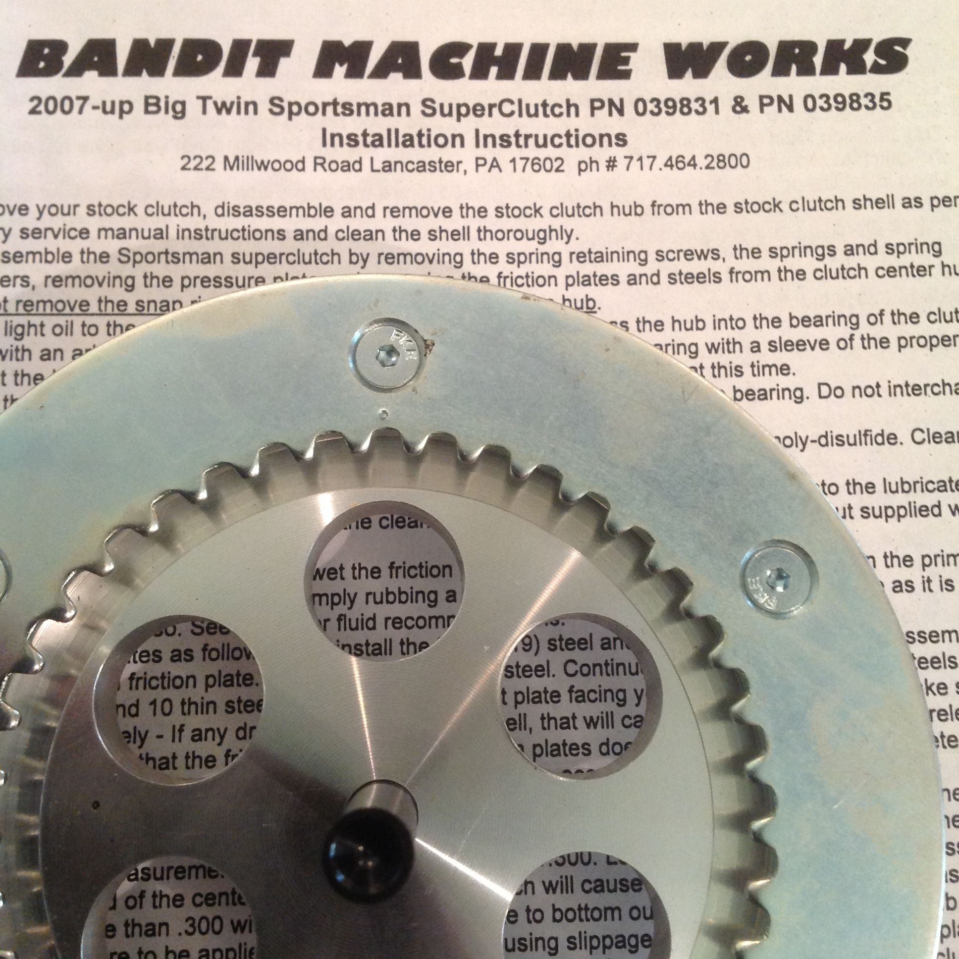

For 2007 and up Big Twin: 039831 Sportsman Superclutch from Bandit Machine Works. DO NOT buy the Bandit from Rev Tech....
If you have any other concerns, give John MaGee or Jeff a call @ (717) 464-2800. They were both great to talk to, John is the owner.
If you go this route, be sure you understand about the index marks on the clutch hub and on the back of the pressure plate - they should be lined up for a perfect install. This is a pic of the back of the pressure plate, look to see that tiny punch mark at the 12 o'clock position:
