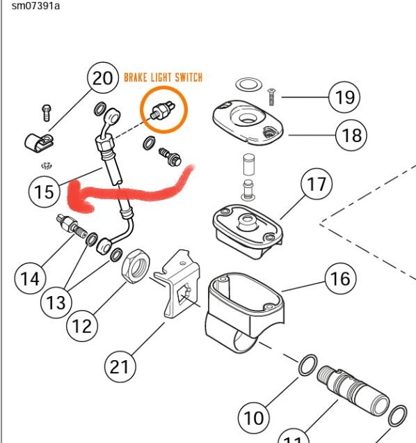

I have the same issue I noticed last night, I have an '07 Street Bob. Is my brake switch the same or is it the older style that I can replace without removing the banjo bolt? After looking at mine it looks the same as the diagram but the leads connect to what looks like the switch that has the dotted lines running to it.

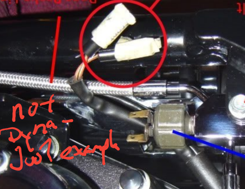

I added a circle to where my leads connect to the switch. Is this correct?
Brake Switch Diagram
Yours is the older style which can be removed without removing the banjo bolt.
