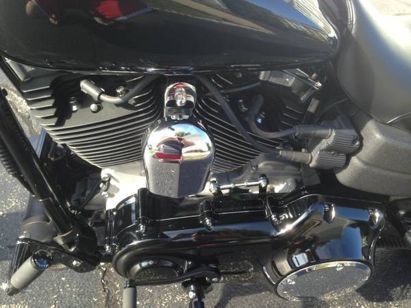

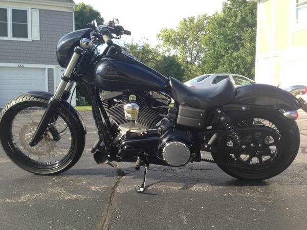

As mentioned above just powder what you have....that's what I just did to my inner and outer. Inner is a lot more work. Among removing the compensator and clutch assembly you have to press out the inner primary bearing that your main shaft rides on. Service manual is a must.
I love it opposed to the gray casting:
that does look dope, what about your other side? Did u just powdercoat the outside? What'd it cost to do the primary?

Thanks and no I have not take care of the other side. Might do the cam, trans side and top covers in the future.
The Powder Pro isn't to far away from me so I took the inner and outer covers to him and had them back in a week. I don't remember exactly, but it was around $90 for both (if I find the info I will edit post with exact price).
Info from Tim at the Powder Pro on pricing:
"Inner primary $75, outer primary $50"
"We have small engine package, outer primary, cam cover and trans side clutch cover for $100, or large engine package outer primary, derby, cam cover, points, starter, trans top cover, and trans side clutch cover for $150."
