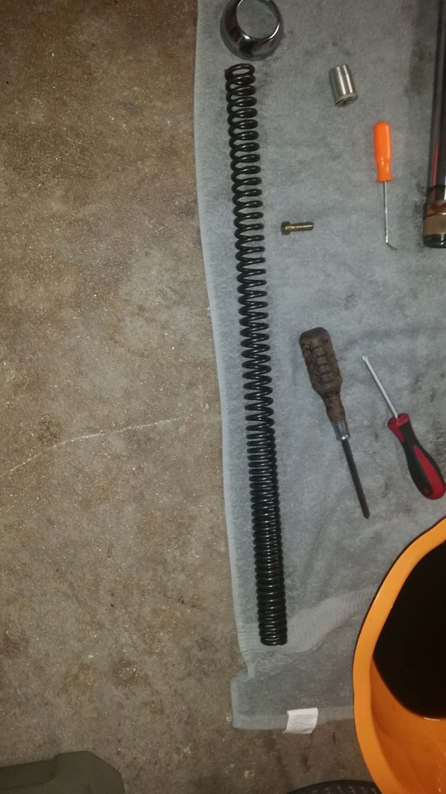

Thanks for the reply guys. These are what I pulled out of the forks, are these what came stock or possibly upgraded?
Old Dec 11, 2016 | 07:31 PM
Max Headflow's Avatar
Max Headflow
Joined: Dec 2005
Posts: 19,925
Likes: 8,027
From: poway
Can't see the damping tube but the spring looks stock..

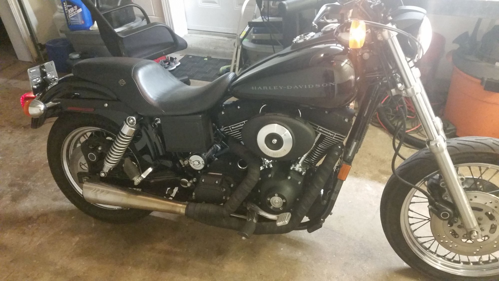

hi all
from the picture, looks to me your fork sits quite tall, and the shocks look like from the superglide, they're quite stiff rite?
i have got question about suspension sag:
data: 2004 fxdx odometer 20,000kms or 12,500miles, stock fork springs, 3year old progressive 13.5" 420s at the rear, mostly solo riding, rider weight 165lbs, new fork oil
here's the sag calculation i got
fork:
jacklifted off the ground 180mm, bike weight (unladen) 145mm, with me 125mm, so that would be 35mm for static and 55 for race sag.
rear:
jacklifted off the ground 305mm, bike weight 270mm, rider weight 255, its 35mm static and 55 race sag.
can any one explain to me about the figures above? i dont know whether the springs have gone soft or what..
i dont get bottomed out but i still feel the brake dive but not too much. the fork preload is set about 3 lines shown and the shocks (1-5 clicks) are set to 2 clicks from the hardest.
i needed to set the sag rite since i wanted to get the best compression and rebound adjusment on the fork. i've been trying to minimize the shimmy feeling (quite scary) from the front end when speeding up or in long fast curves...
