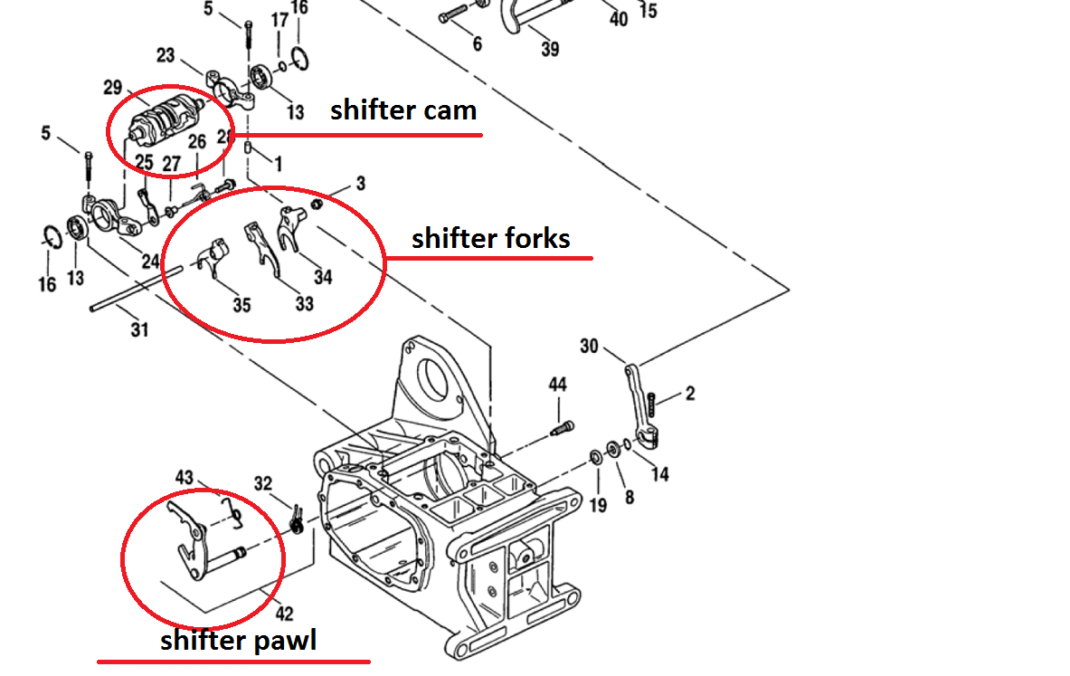

Originally Posted by Spanners39
Part #42 is what you align, there is an adjustment just above the sprocket, read the manual to get it correct but basically with one of the shifter dowels in the 12 o'clock position the fork part must have an equal distance either side of that dowel.
They removed the adjustment from 02 up non counter balanced motors. Nothing to adjust. It is simply a pin. Number 44 in the pic.. Circle covers the number.
Part #42 is what you align, there is an adjustment just above the sprocket, read the manual to get it correct but basically with one of the shifter dowels in the 12 o'clock position the fork part must have an equal distance either side of that dowel. Yesterday 11:26 PM
Understood. Thanks for the heads up. Didn't even know. Guess I'll check the manual to see if I'm missing anything. Don't even know what to check now that the trans cover is off.

UPDATE:
I used to be in a hurry to put the trans back together and see if the bike shifts properly BUT I noticed the shifter pawl spring feels weak and should be replaced. Take a look!

Too replace the shift arm you need to remove the shift drum, shift forks, transmission trap door and the guts to the tranny. You'll need an inner primary bearing race puller.
Add. Good time to inspect the rest of the tranny.

That looks pretty normal for a stock pawl. Get the rear wheel in the air and spin it while you are shifting through the gears. If it shifts all the way up and back down I would say it's good.
