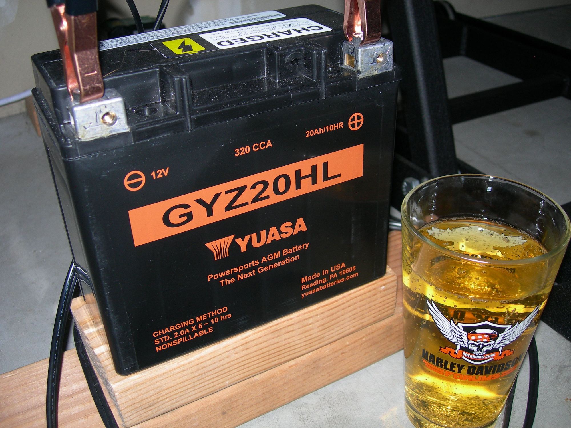

Grabbed an image of my Yuasa; it was thirsty

Originally Posted by TinCupChalice
These HD/Deka batteries are really hit and miss; my last Deka only lasted 15 months, and it was always kept on a Battery Tender. I've moved on to the Yuasa GYZ20HL; I've never had any sort of battery problems with my sport bikes running Yuasa batteries. This Yuasa along with Terry Components 4 gauge battery cables spin up my Wide Glide quicker than I've ever heard; the OEM battery cables are 6 gauge.
The Deka battery is 310 CCA and 17.5 Ah, the Yuasa is 320 CCA and 20 Ah and based on my experiences with Yuasa in my other bikes I've got high hopes this battery will last.
Best pricing on the GYZ20HL: http://www.phatperformanceparts.com/.../yuasa-gyz.htm
X2; Yuasa GYZ20HL !
