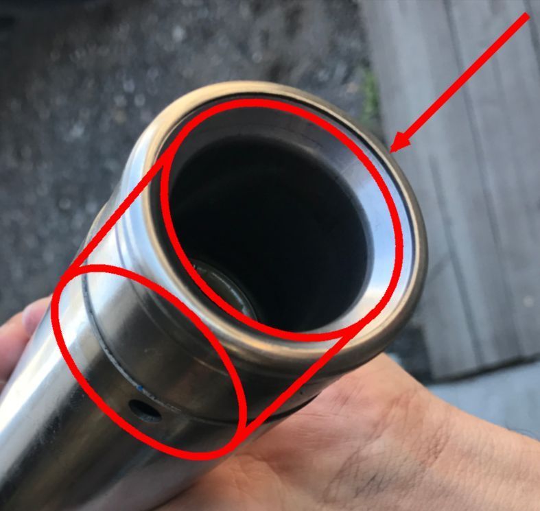

During the manufacturing of the Tube, the check valve assy is inserted and then the edge is rolled over (arrow)
thanks a lot of the explanation.. really helped me/out on this project.
