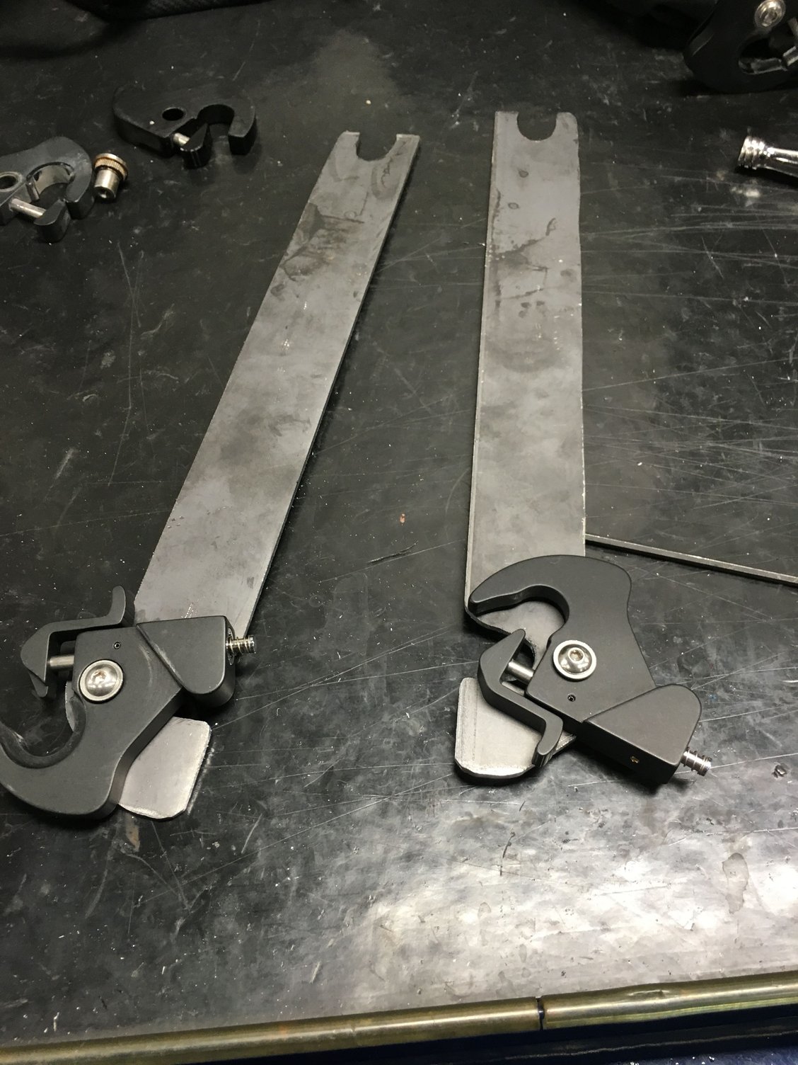

You can separate the bags, then get sheet metal and cut a template of the bag like I did, then cut 2 per bag, one inside one outside, then drill holes to mount. I had the plates powdercoated black.
I also built QD brackets using 1/8 flat stock, a second set of sissy bar docking points, and a set of locking sissy bar latches I had laying around.
