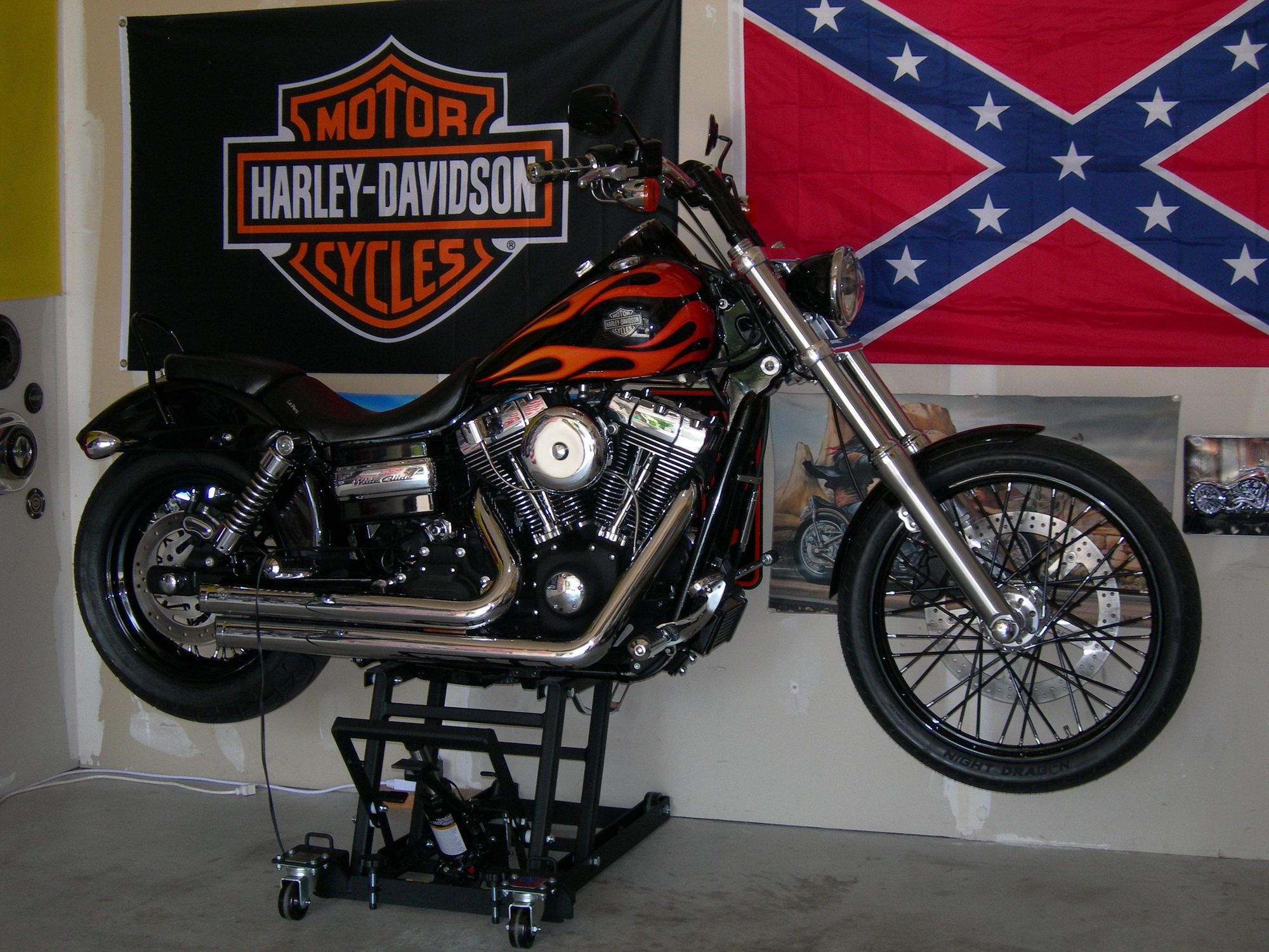

With the expense of these bikes there is only one lift I'd trust for long term storage of any HD; a J&S. The J&S is an expensive option, but so is my Wide Glide
My Wide Glide is always on the J&S when she's not being ridden; she's been sitting on the J&S since late November with absolutely no issues. The J&S uses locking arms that drop in to the lift frame, from there you open the hydraulic release valve and drop pressure on the bottle and the weight settles on the lift frame, it's not being supported by the pressure of the hydraulic bottle.
The J&S is designed to work perfectly with the Dyna, no adapter blocks required...
