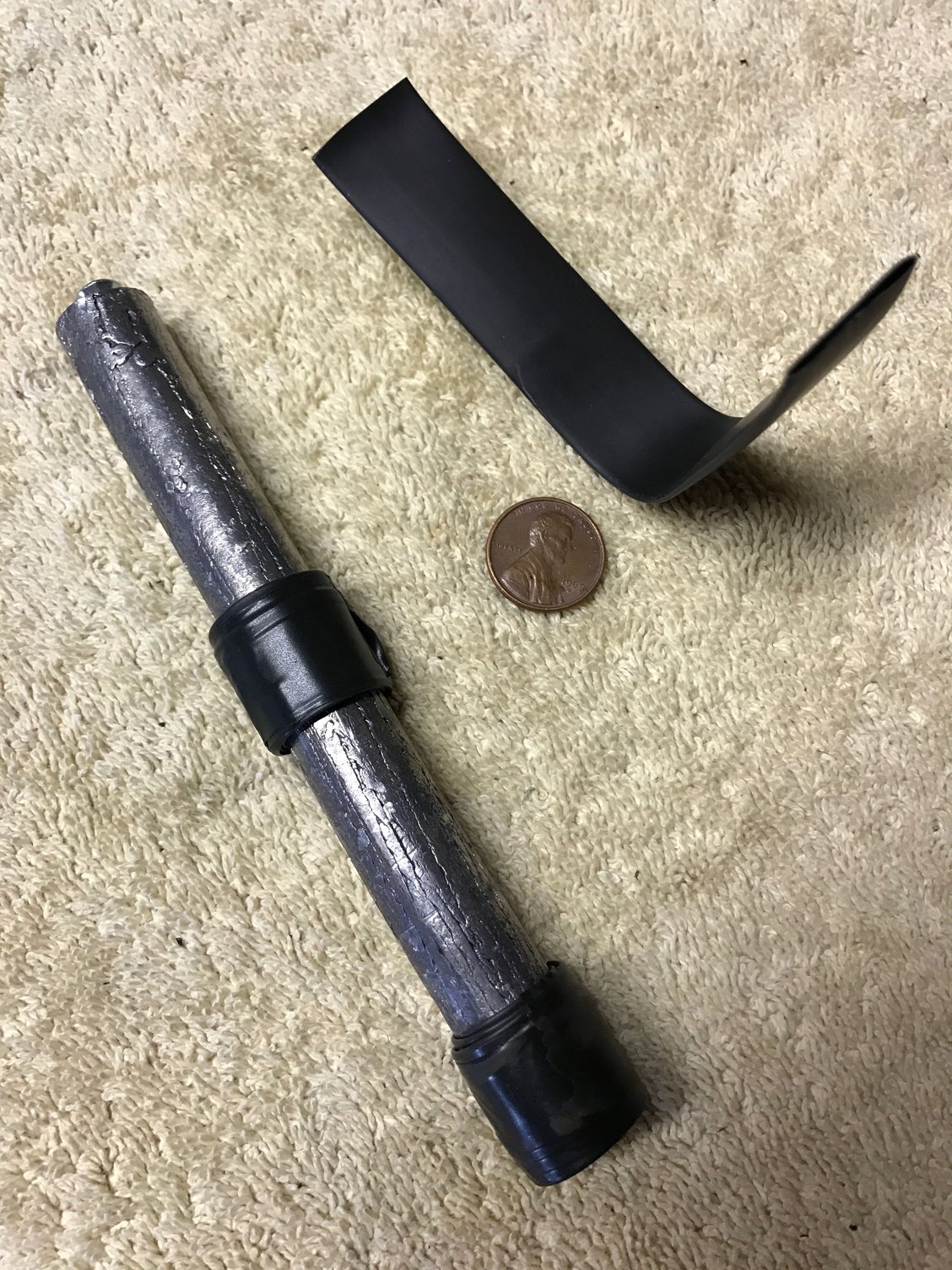

Today I took the grips off and slid a lead rod, 5/8 diameter X 6in long directly into the bar. I made it snug in diameter by utilizing heat shrink as well as electrical tape in three separate areas. I also put a screw on the end of the bar so that I could easily retrieve it if I need to. This has helped tremendously.
Also I noticed on the bottom of the riser that I was only using the grade 8 bolt as well as a washer, and I had somehow not used the bottom molded washer that goes on the bottom of the bushing. So I put the bushing washer back on as well as the regular washer and I also added a locknut washer. I went a little overkill and bought the next size in length of the grade 8 bolt. This allowed it to be very snug.

How has it been after riding it with the lead?
