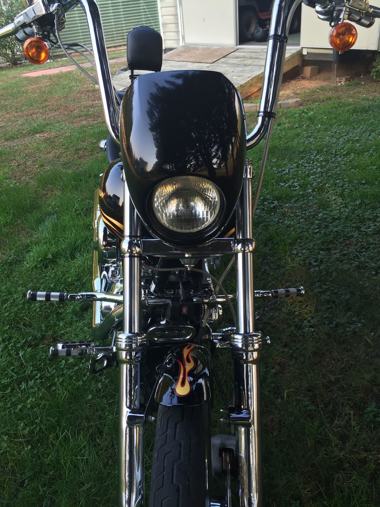

Ebay $30. comes unfinished if you like this style.

Yours is going to take a little elbow grease since it's a 39mm front end with wide glide trees, I'm assuming. The fairings designed for the 39mm forks are usually set up for the stock narrow glide bikes.
That being said, if you're not a fan of the HD style quarter fairing with the headlight shield, I'd take a look at Memphis Shades. They have a few that would probably be to your liking.
