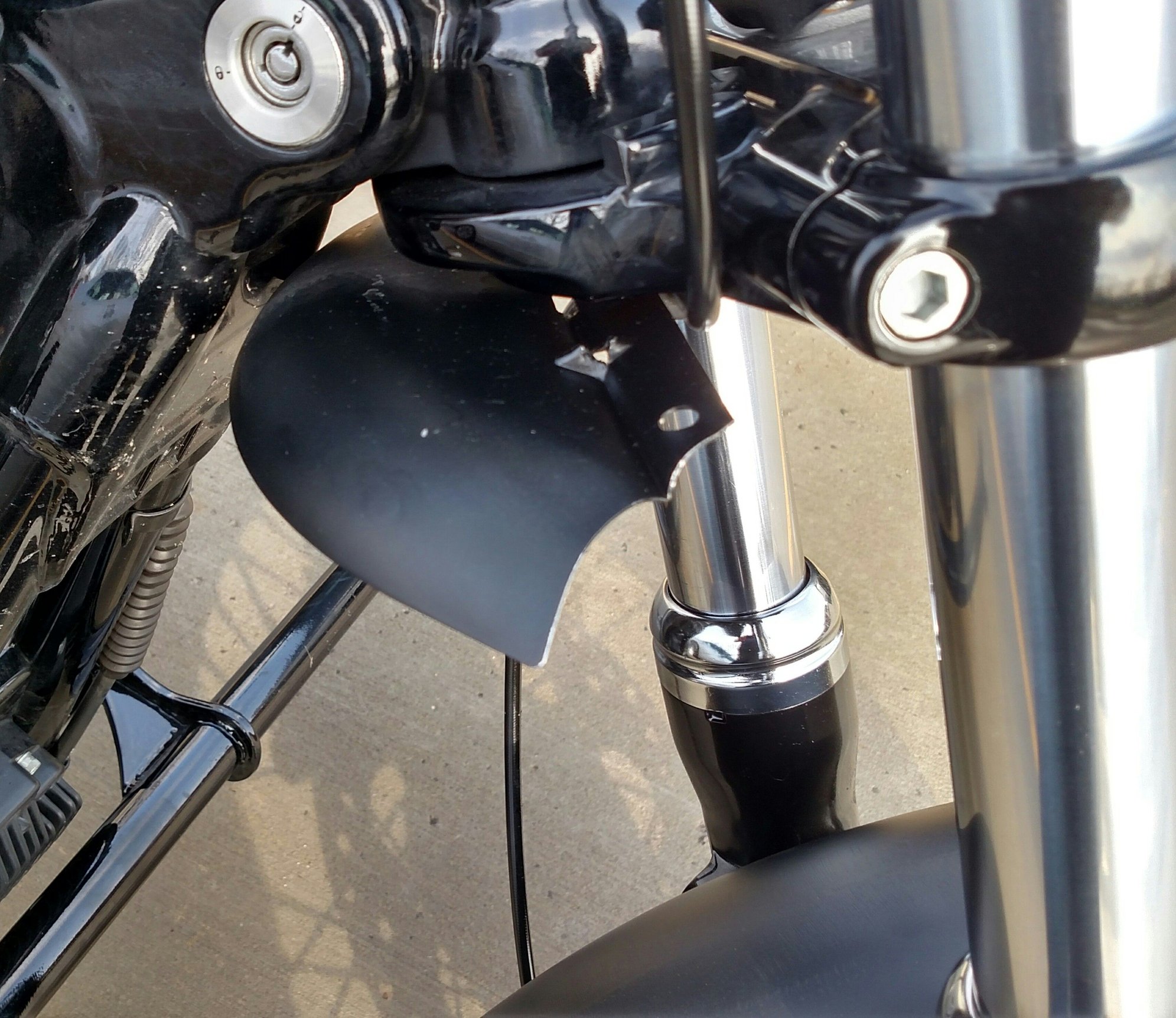

Try this. You have to bend it for it to fit the Dyna. No big deal. Ill post pics of mine tomorrow if you like.
http://mstore.harley-davidson.com/store/front-fork-air-baffle
http://mstore.harley-davidson.com/st...ork-air-baffle
Bend what? Yes please more info on this.

Fireguy88's Avatar
Fireguy88
Joined: Oct 2014
Posts: 864
Likes: 56
From: U.s.
Touring fork baffle. I painted mine black.
