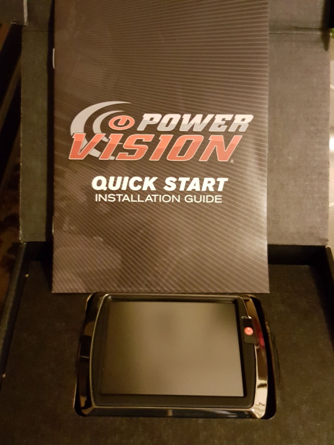

Well it arrived in just 2 days after the order. Thanks to fuel moto. I just took it out of the box last night and read all the paperwork that came with it 1 time through. I wont put it on my bike till tomorrow. Because our computer just took a dump and im gonna have to borrow a family members lap top to download the software and make sure its updated. Sure was tempting to just put it on the bike though last nite. But its raining where i am anyway. So i can wait till tomorrow.
