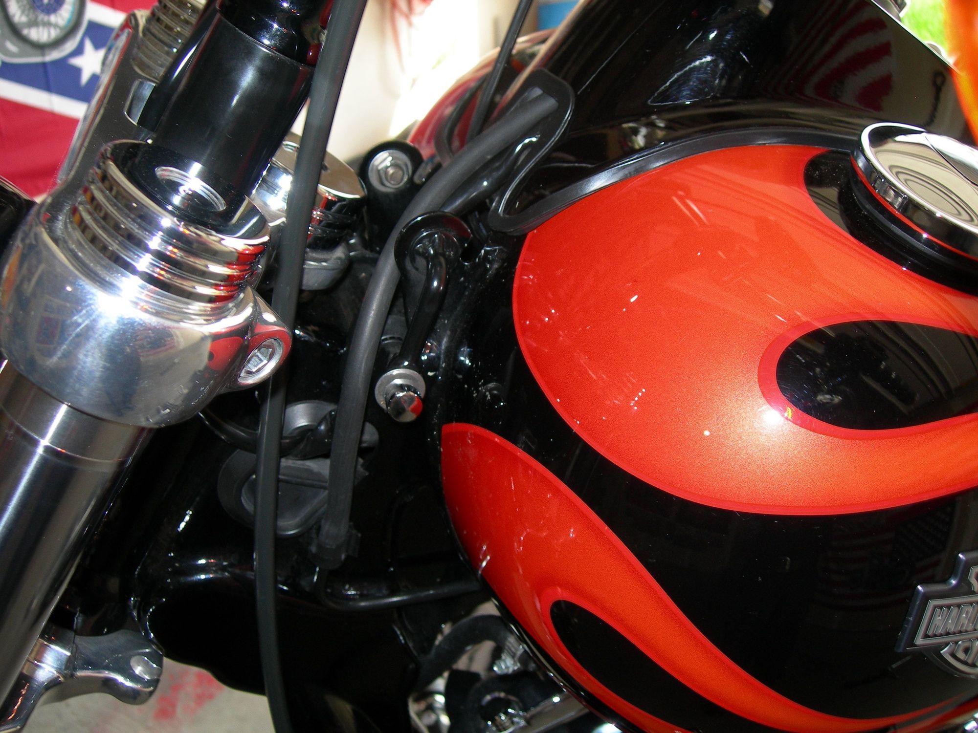

TUCCI, great idea adding this DIY mod to the database. You recognized a useless, mandated add-on and immediately corrected it. You can pretty much figure if the .gov wants something there, it's a bad idea
You motivated me to see if I could clean up that vapor line even further; I went to Auto Zone this morning and bought 12" of 7/32" (5.56mm) rubber hose along with 2 black clamps for the fuel tank crossover. Used alcohol to remove the imprinting on the new hose and lifted up the console and removed the current 1/4" rubber hose. The vapor hose is plugged in to a connector that comes off the fuel tank vapor line barb under the console; that hose coming off the barb to the connector is 7/32"
Took the 1/4" hose stub off the rigid plastic line and ran the new hose directly from the under console connector to the rigid plastic line; the new hose is smaller in diameter and cleaned up the neck area even further; grabbed a quick image then added the black clamps to the fuel line crossover; it's all about the details
