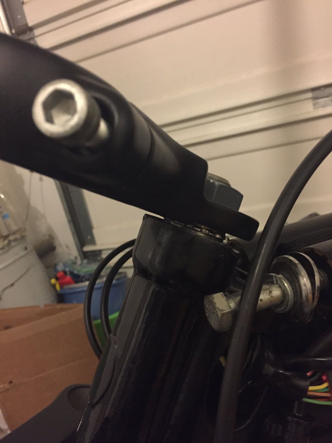

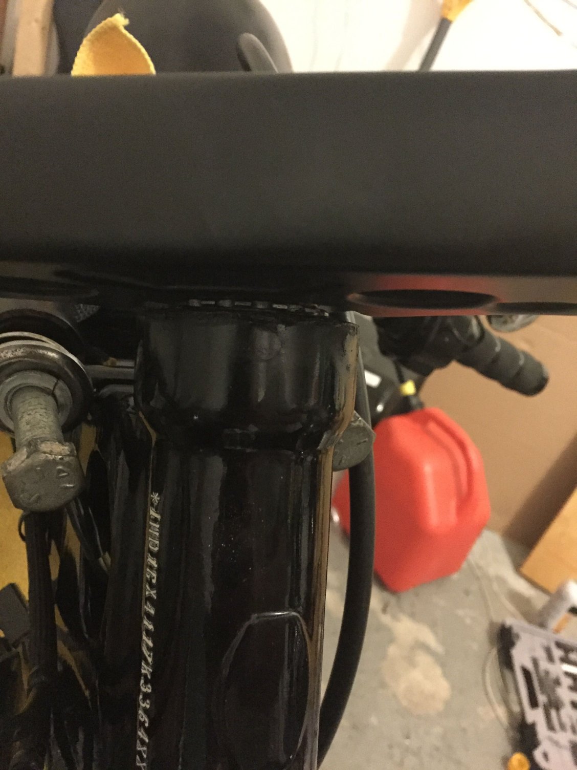

So I have an '07 street bob that the previous owner put a wide glide front end with some rake in the trees and 27" fork tubes. I recently bought some mid-glide triples that I bought off a member on here and pulled the bike apart and went to install them but seem to be having some trouble. I'll throw up some pics to show what's happening. I have a gap when installing?? Could it be that the wide glide front end had larger bearings?

Is there any wiggle to it? There should be some sort of gap or you're rubbing the tree against the frame and will get some binding. How much I'm not sure. I'll take a look at mine when I get a chance. After checking mine yours looks right.

Looks about right to me, from what I can see.

I don't see a dust shield below your star nut

Looks normal. You have to have access to the preload adjuster nut between the neck and top tree. I think the gap looks dumb, but that's how they're designed.

Okay if it looks normal bikes going back together lol
